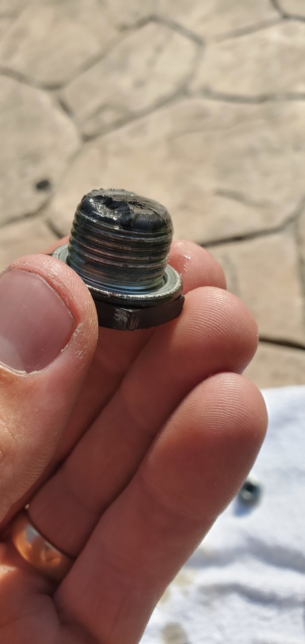

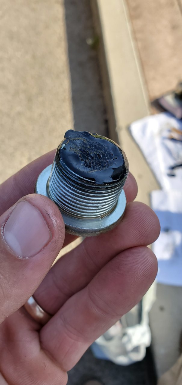

    Did my differentials and transfer case yesterday for the first time with the help of this thread and others. My magnetics and fluid actually weren't too bad for the 30K I have on mine.
    I used this pump and it worked well. About 100 pumps per bottle though. From autozone-
    https://m.autozone.com/test-scan-an...d-pump/performance-tool-fluid-pump/332794_0_0
    I also used this oil for all three, -
    Mobil 1 104361 75W-90 Synthetic Gear Lube - 1 Quart (Pack of 12) https://www.amazon.com/dp/B009IE2O30/ref=cm_sw_r_cp_apa_i_iOkiDbABVQ0MP
    I also found this from a tacomaholics youtube video on the subject, ordered it and will install it with next change- https://trailtoys.net/products/magnetic-drain-plug
    All my fill and drain plugs came off relatively easily. Didn't need PB blaster or anything even after 30K and for the first time!
