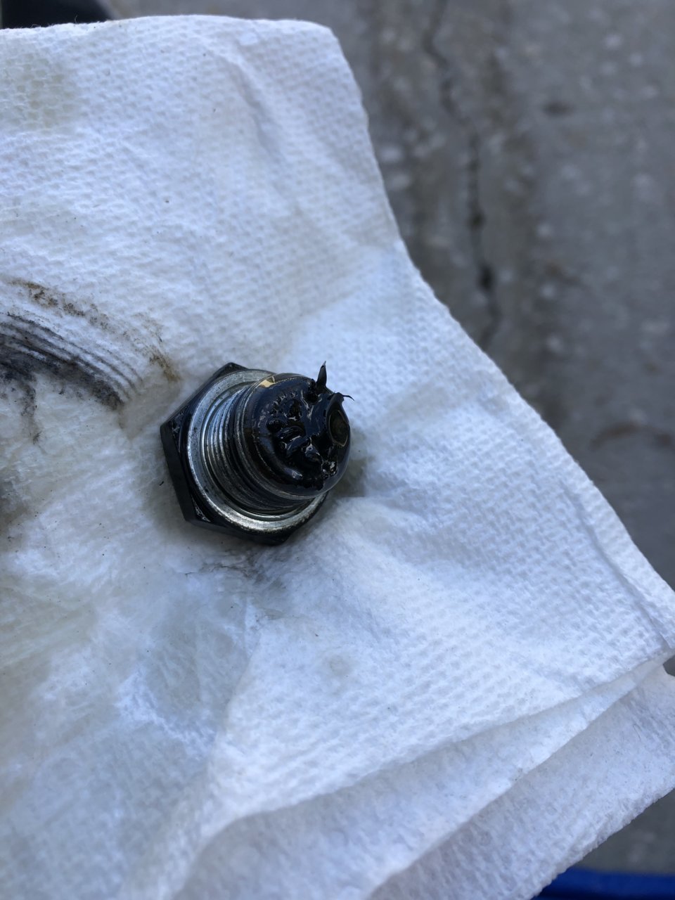

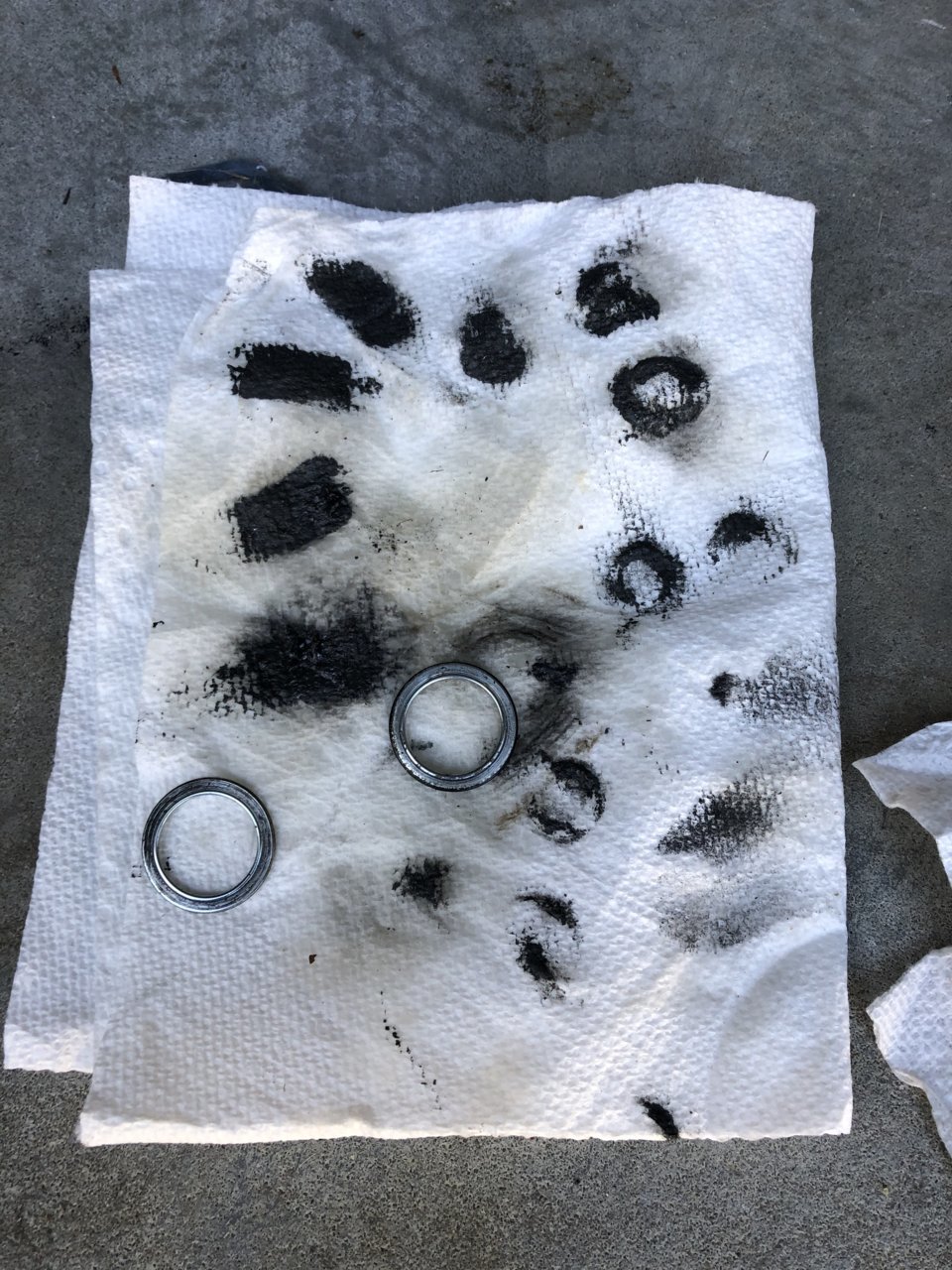

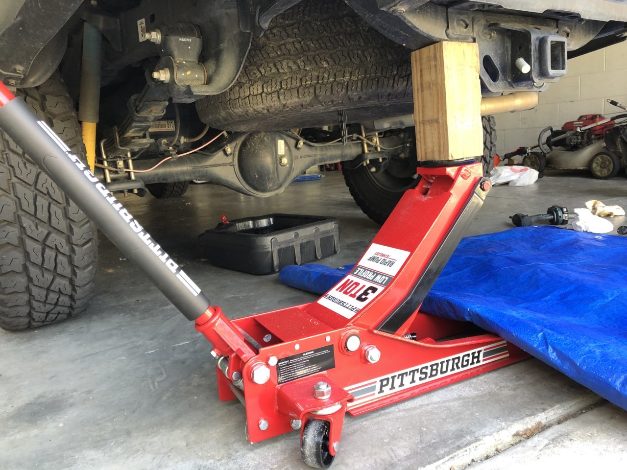

    Changed the rear diff fluid at 23k. Jacked up from the hitch to give me more room but it wasn’t necessary. Fluid came out ok and a normal amount of sludge on the magnet. Transmission and front diff up next.
