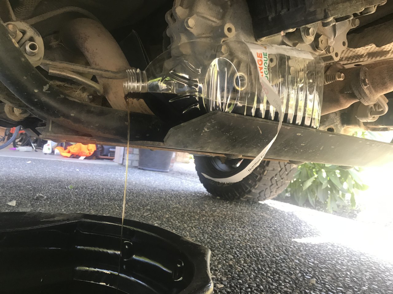

    When you have the full set of skid plates but you have to change oil.

    Brilliant! I just did these fluids over the weekend. I don’t have skid plates but I still could have used such a gadget to prevent making a huge effing mess on my garage floor.

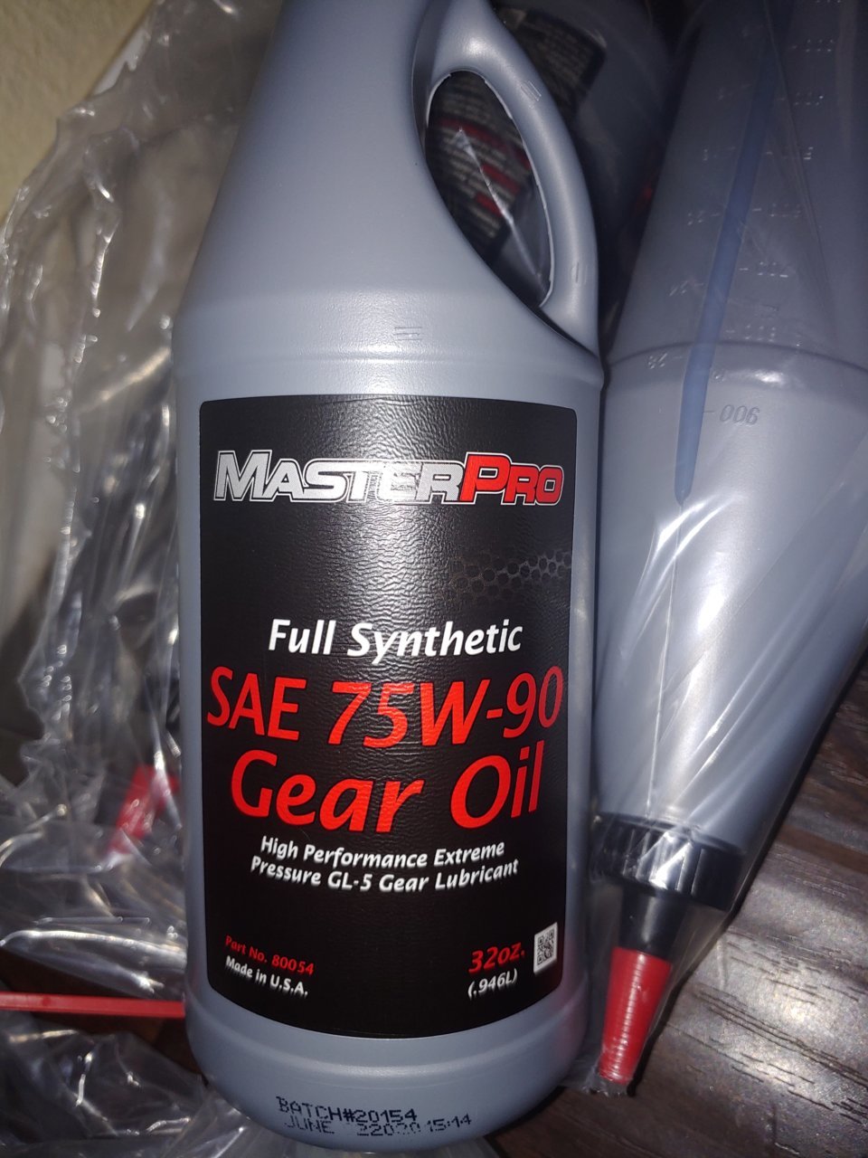

    No.

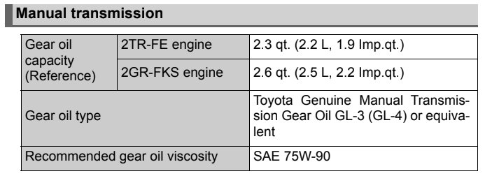

    MT:

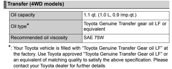

    T case:

    A GL5 fluid contains EP (extreme pressure) additives. These additives are corrosive to the soft metals in your tranny. Your tranny life with be reduced with the use of this type of gear oil. A GL3 fluid does not contain these additives...
    thank God they take returns!

    Back in the early 2000's my buddy ran 75W90 GL5 gear fluid in his manual trans 1st gen even when I advised him against it. He said, it'll be fine. Well, it wasn't and soon had to have his syncros replaced.
