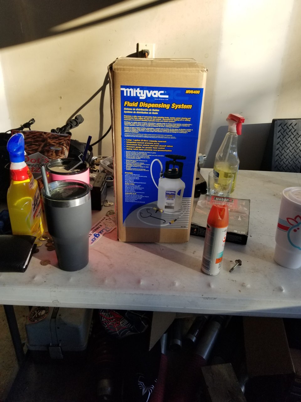

    That's a good enough reason to visit. Come by and use the Mity"pump"

    You got a flat surface? That's my next problem lol

    Yep.
