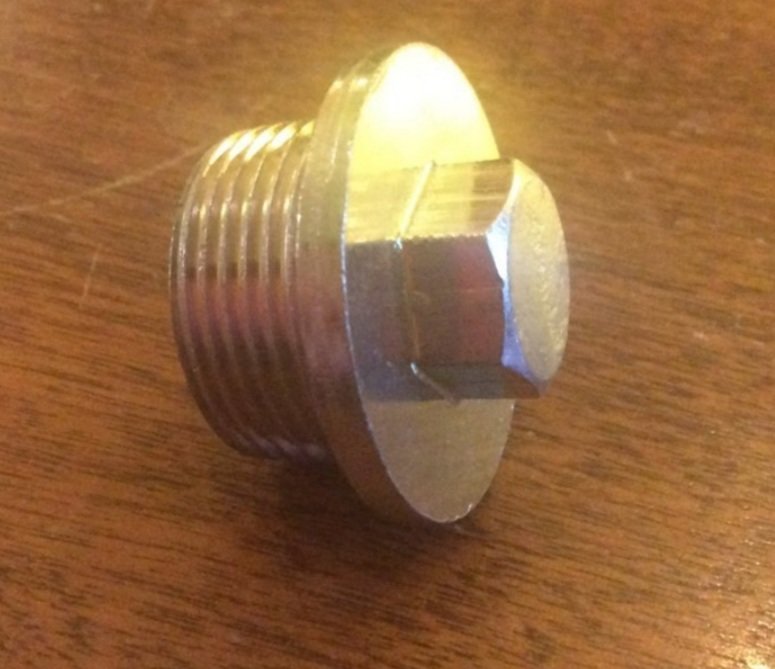

    The guys who put the air lockers in my front diff and rear diff (still working fine) did a good job last January, but when I went back after 500 miles to get the fluid changed (part of their required warranty practice) - the ass who changed the fluid really messed up the front drain bung - it's an 10mm hex plug, looks like he tried to drive a square in the hole. Gonna need to plan this out. Oddly the fill plug with the same 10mm hex hole is fine. I found this today while doing my own oil change first time (the first one was free at the dealer). Oil change went awesome.
    Ordered this front one for replacement: https://drainplugmagnets.com/cars/toyota-lexus/
    Is that the correct plug?

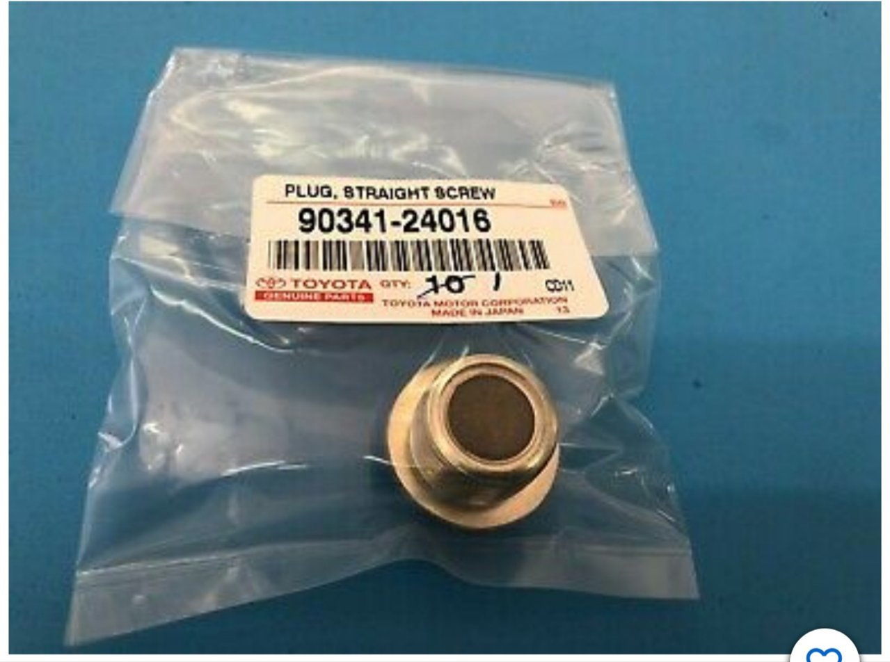

    This is the oem one with the hex head. The oem has a magnet, too.

    Be gentle with me, how much does the dealer charge for that?
    (In all fairness I have found Dimple plugs to be excellent)
    Thanks!

    Thanks! Called the shop, left a message. Fak, I should be able to get it out.
