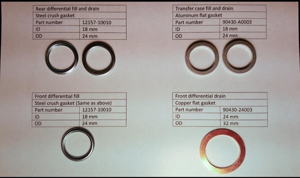

    Took me forever to find this thread. (just a weird comment) Here it is!!!
    Crush washer clues.

  20. Jun 13, 2021 at 3:38 PM
    #540
    daveeasa
    daveeasa FBC Harness Solutions
    May 14, 2020
    #328079
    7,484
    David
    PNW
    2016 Tacoma OR DCSB 6MT, 2005 RC 5MT PreRunner, 2002 Tundra SR5 RCLB 4x4
    Thank you! I definitely bought the wrong crush washers. Oh well. Gonna make my own version of your cheat sheet in Nm cause my wrench is metric. Am I the only one who thinks 27 ft lbs feels really light?
