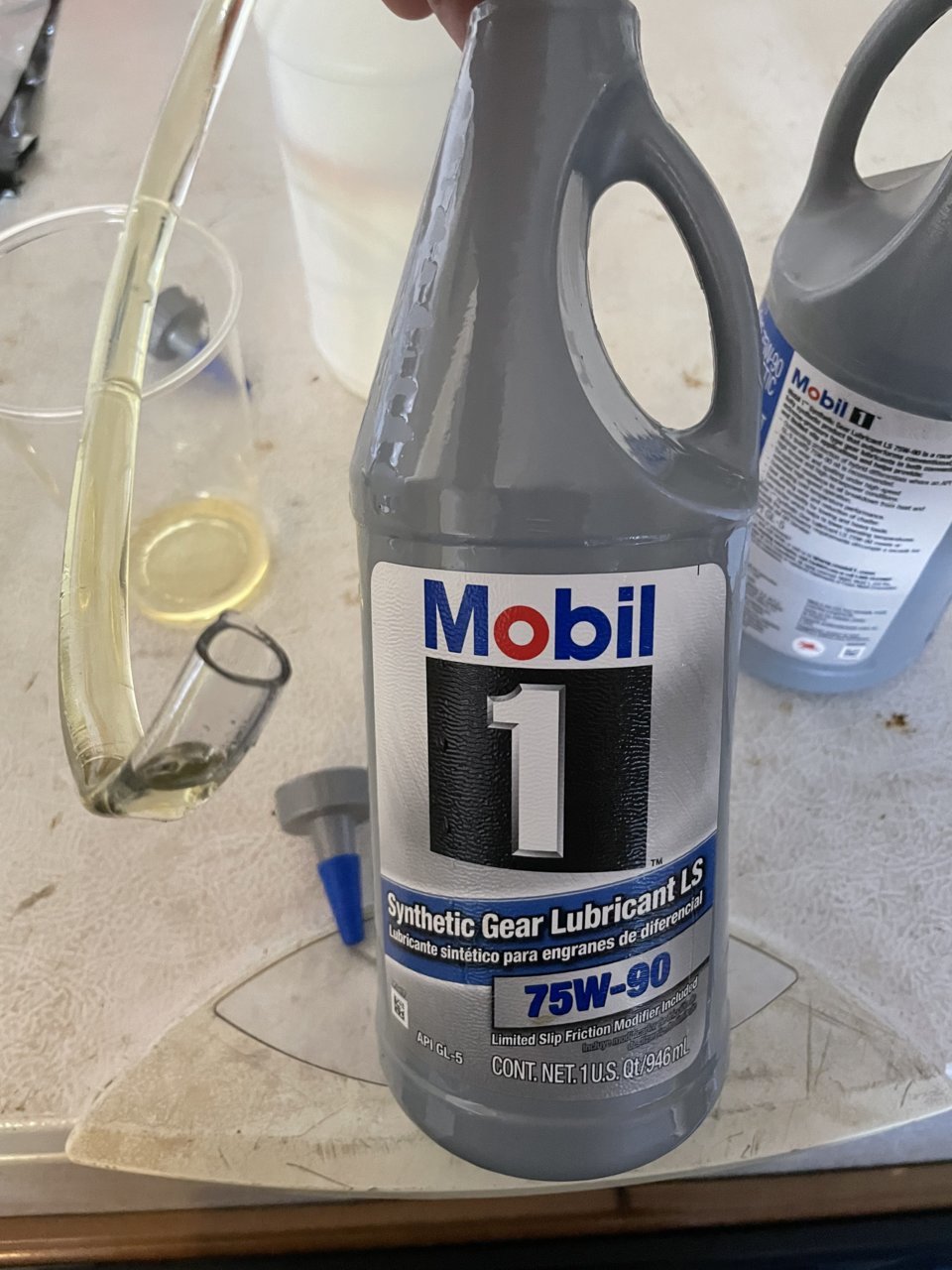

    Any concerns I should be aware of? Just changed the tranny fluid
    CygnusX191 likes this.

    How does it shift?
    You don't need the LS additive. Not sure if makes much difference to the synchros.

    It shifts better but the fluid isn’t red or smell like transmission fluid
    CygnusX191 and Pablo8[QUOTED] like this.

    Color is meaningless. Just a dye.
    What did it smell like? Gear oil?

    You can’t compare gear lube used in a manual transmission with the red stuff labeled “transmission fluid” used in automatics. The “Ford” brand fluid I put in my manual transmission looked just like what you put in yours.

    Similar but not quite as like gear oil

    I’m assuming no issues then?

    None.

    I do not believe that syncros like GL5. The OM says GL4.
