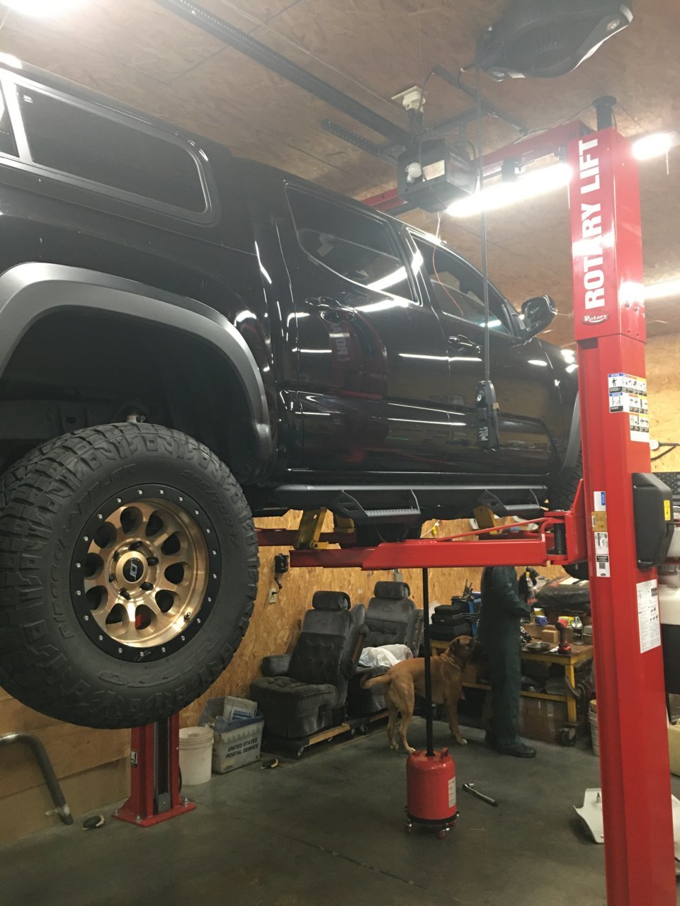

    Either the @RCI-Offroad one is perfectly placed (possible)
    Or I've bashed it so hard it's in the right place now (probable) :D

    Need to remove it to access the front diff?

    Pretty much the case with all skids.

    Lol I was just asking in regards to oil changes. My bad on not clarifying

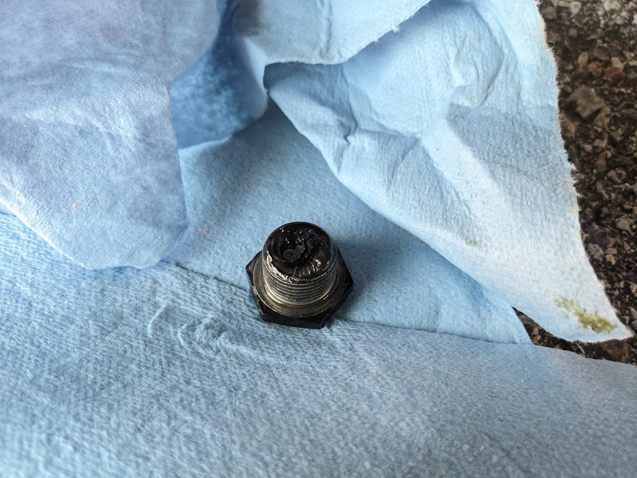

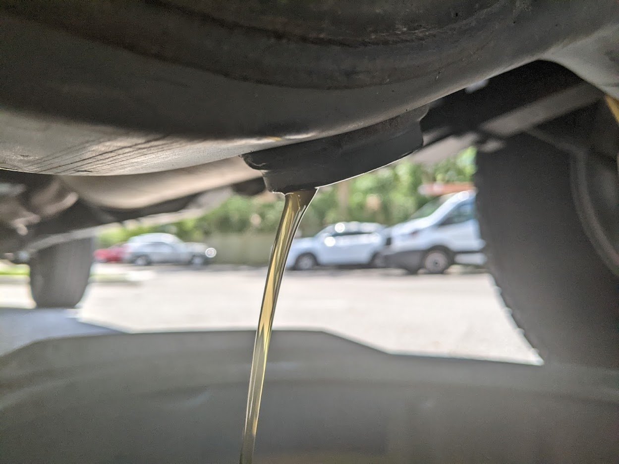

    Just did my trans, t-case, and rear diff (front diff will be next week's project). Mileage is 31000.
    All fluids looked a lot more exceptional than I thought they would. There was some expected metal on the drain plug of the rear diff. Here's a pic of the drain plug and the fluid on its way out of the diff - was way surprised how golden it was.
    qTdw8L_O8HCa3kphm4GkZLx7RHB3AoWcDVMXwHfz_c8f47355b1d9f373e1cb78065648979c2b101921.jpg
    U-OLFOy24sUArX7Szw3H85pDFrYEvKInn6_vEh2k_07761947ed4e26c6509f3f3ff58315f840c070f5.jpg
    A little note - I know it's more than likely a placebo but on my test drive, the transmission felt like a dream. While I've never really felt that the shifting was "notchy" I've always had complaints about clutch engagement as many have, I noticed it was way easier and smoother to engage the clutch...which is odd because I know I touched nothing to do with the clutch. Maybe I was just "in the zone" with my shifts. :rofl:
