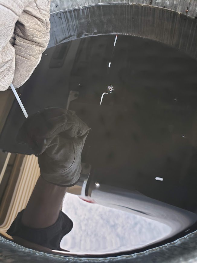

    Figured I may as well add to this thread.
    For a reference point that might be helpful to others, I drained and filled my diff oil at 7919 miles and this is what it looked like.
    I also threw AmsOil in mine and thankfully has never been sparkly since the initial break in.
