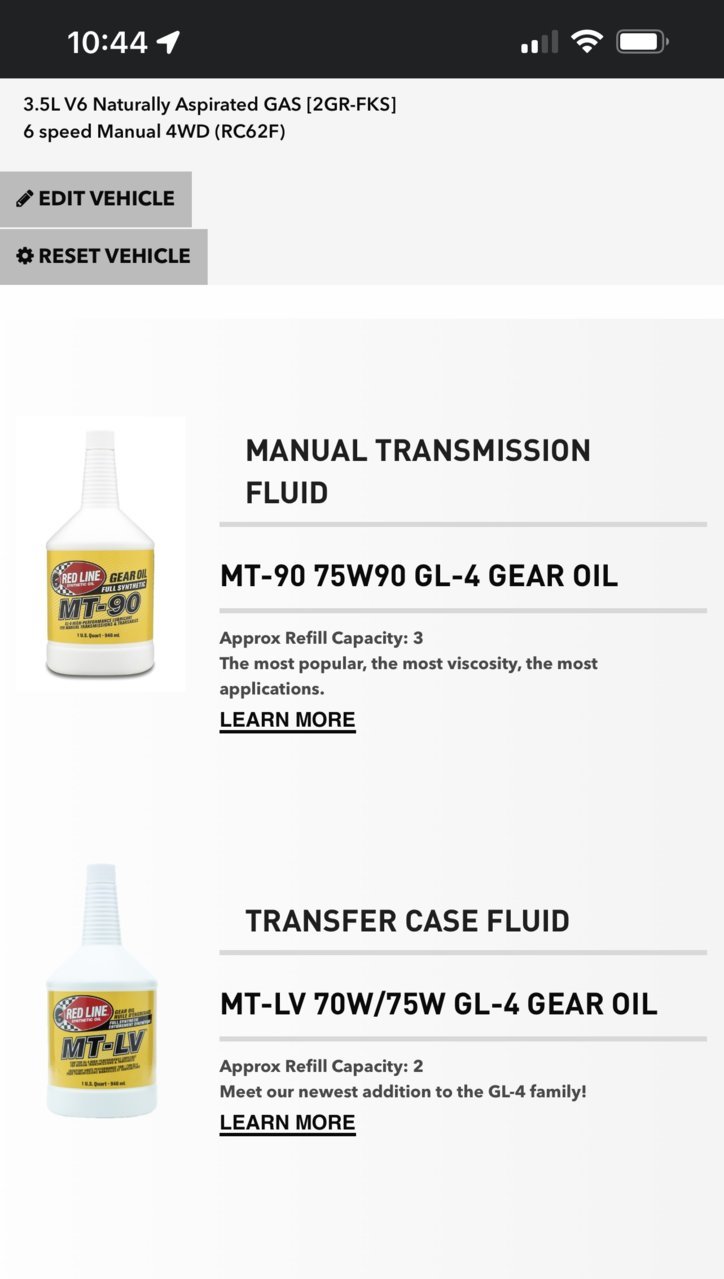

    Redline makes excellent oils. I used them in my first gen, second gen, and 2022 third gen.
    https://www.redlineoil.com/

    Ordered amsoil for the diffs and the redline pairing for the trans and tcase. I’m at 25k, interested to see what they look like.
