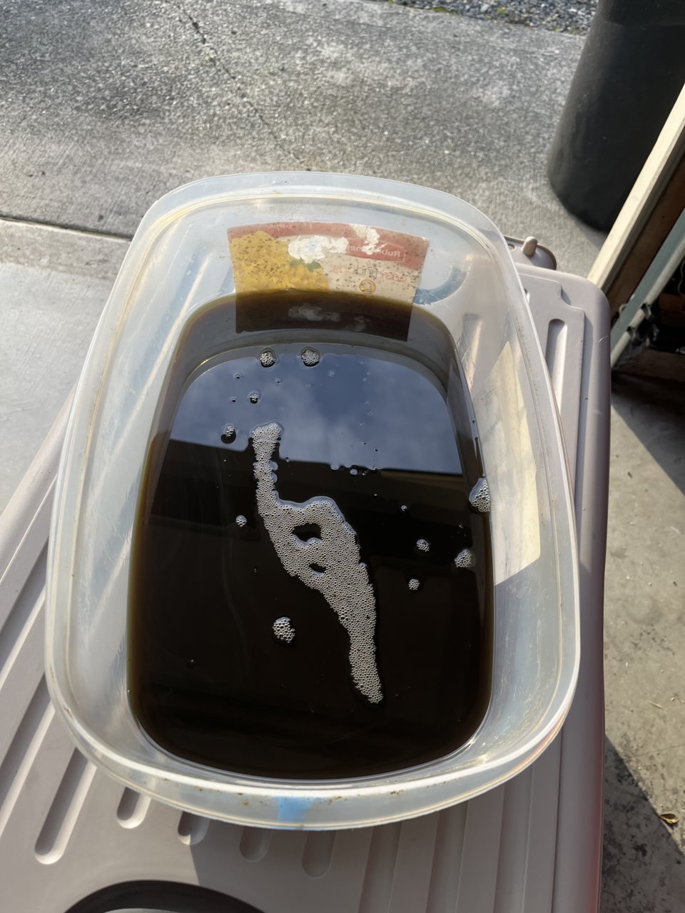

    Going on 9500 miles and it’s pretty dark.
    Manual transmission fluid. Also noticeable small amount of glitter in the oil.

    Small amount is normal.
    Also the first change being super dark is normal, as long as it's not sludgy, thick, viscous etc
    duece5811 and danny15l[QUOTED] like this.

    Yeah I was expecting some metal just like the engine oil the first time. Glad to get all the old stuff out. I bet the shifts will be much better. Haven’t taken it out yet hehe

    MT-90 since it seems more liked than AMSoil. I topped off with AMSoil around 4K miles because my transmission was low. Instantly quieted the transmission down. I noticed the two oils (stock from the factory and what I added) were actually separating when I had them in the drain container and was spilling it into my oil canister. AMSoil is more thick and more of a clear yellow color whereas the MT-90 I put i. is slightly red tinted and seemed a little thinner. API GL4 of course. I counted the hand pumps. 326 lol.
