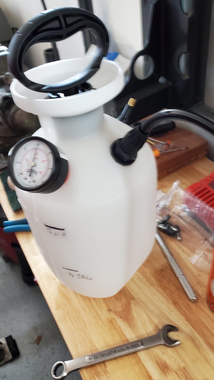

    I made this fluid transfer pump out of a cheap garden sprayer, valve stem, bulkhead and a pressure guage. It works great for gear oil.20230421_093308.jpg
