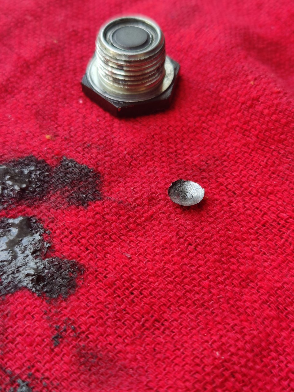

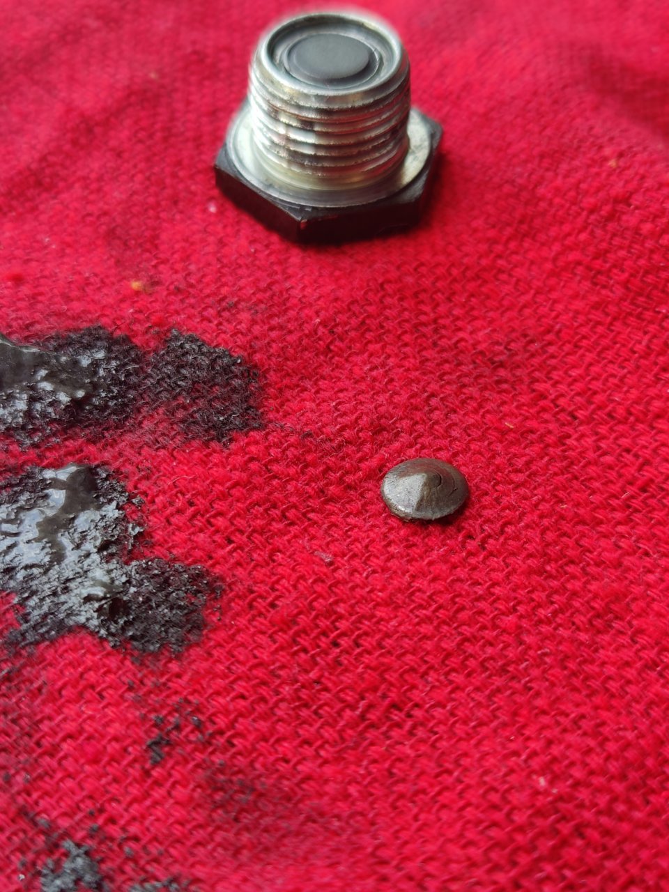

    I just changed my transmission and front/rear diffs today. Truck is at ~51,500. This was the first change as far as I know...I've owned my truck since 8k miles. Anyway, I was VERY surprised that all three looked great actually. The front/rear diff were both still a light amber color, only minor metallic shavings (mostly). I haven't done any off-roading and rarely tow so it's hasn't worked too hard.
    The only thing I'm questioning is, what's this big piece of metal that came out on the rear drain plug....any thoughts?

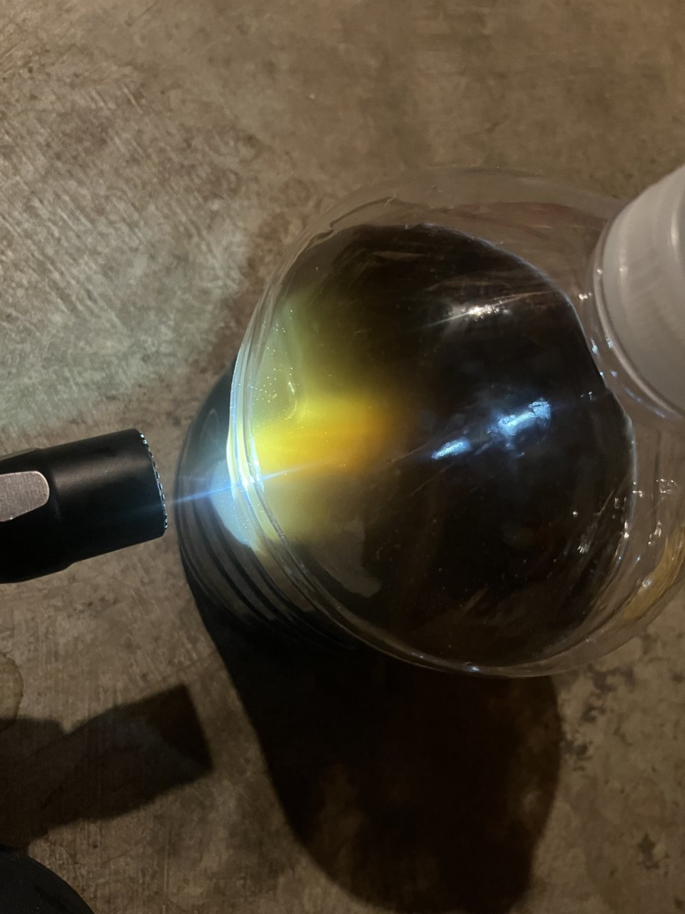

    My 22’ came without a magnet on the lower bolt. This is what the redline looks like after 15k flashlight shining through it.

    All of the diffs should have a magnet. For some reason I don't think the t cases ever came with magnets. But as long as that fluid is flowing, and not sludgy or thick, you should be fine

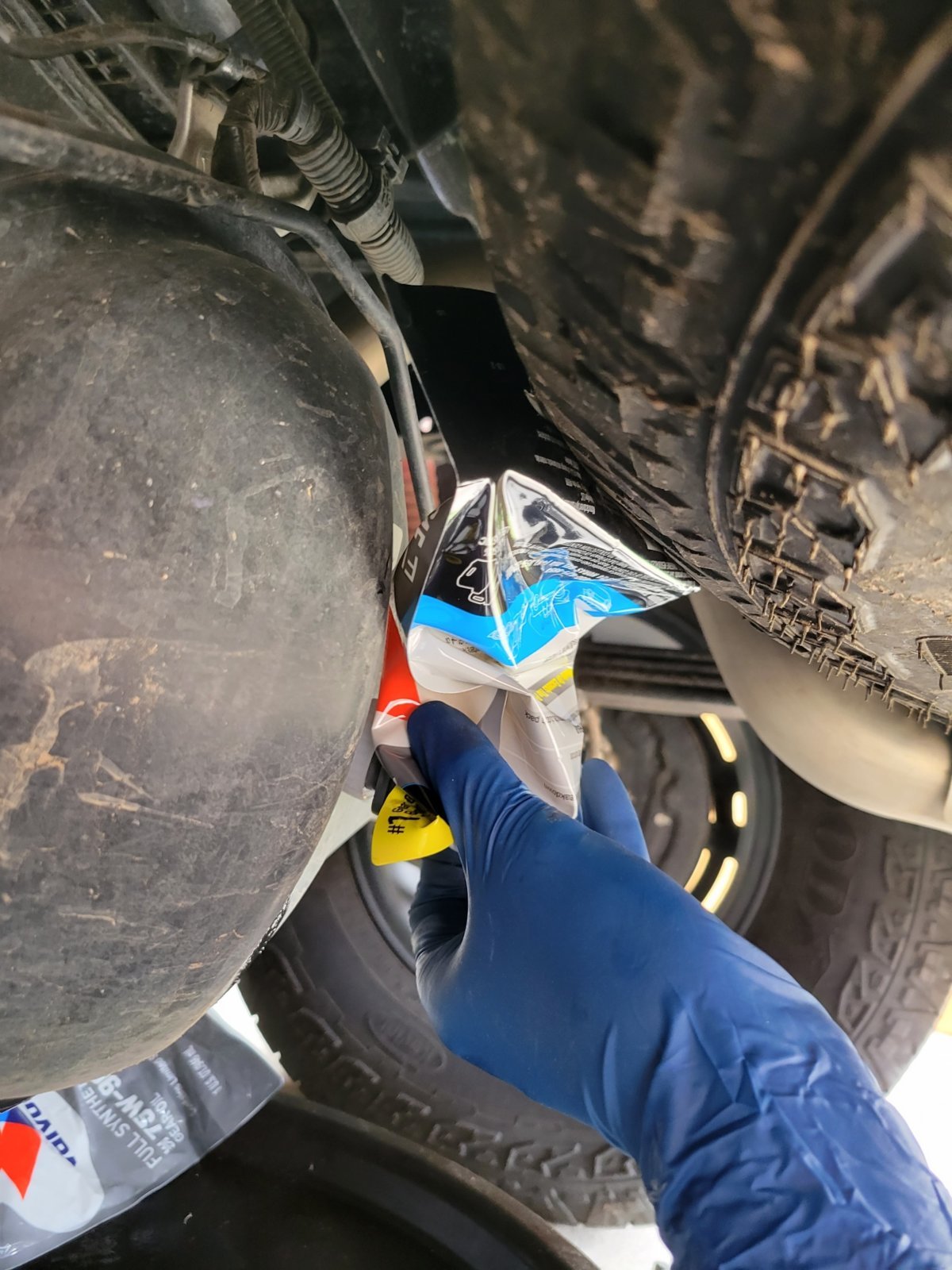

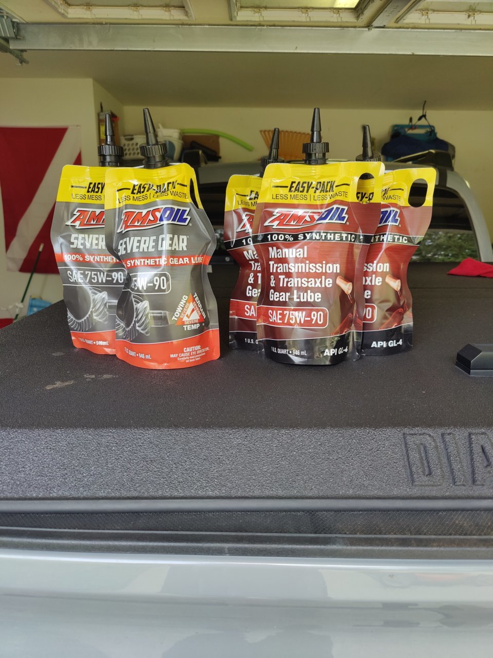

    Just finished my front and rear diff (waiting on Redline MT90 to show up in the mail) at 15K miles. Similar to the OP, rear looked fine but the front was noticeably darker. I attribute it to just a smaller volume of fluid in the front differential and initial break-in.
    I went with Valvoline synthetic for the availability and convenience of the flex pouches. No pumps to deal with and even the limited space around the front diff wasn't a problem.
    https://theengineblock.com/valvoline-flexfill-gear-oil-squeezes-innovation-into-every-drop/

    Amsoil has those flex pouches. Lifesavers if you're working at home
    Jesse H[QUOTED] likes this.

    The only pouches any of my local auto parts stores had was Valvoline for gear oil. Went with Redline for MT fluid. Going to plan ahead and go with Amsoil next time. I hate messing with those pumps.

    Did my first change with hand pumps... Messy, messy, messy.
