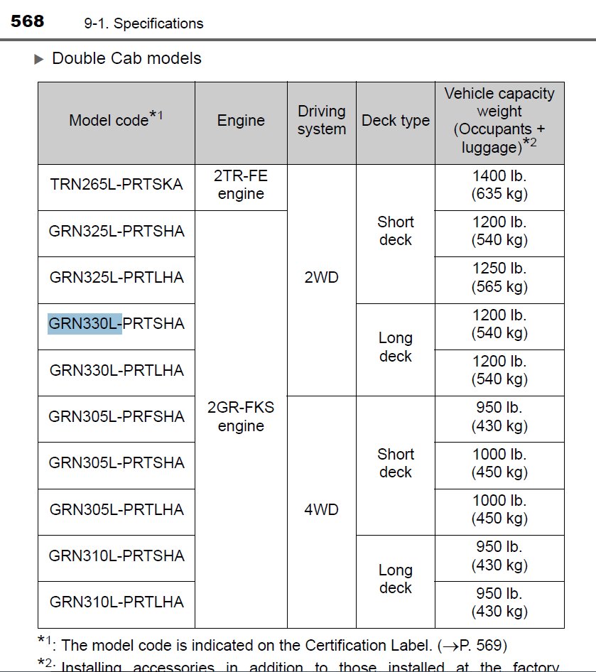

    Maybe I'm inpatient. But I can't figure out what the spec is for my truck's rear end...
    Double Cab TRD Sport 2wd.
    Is there a nice way to denote the spec?? has someone deciphered it?

    Your "model code" can be found on your VIN sticker in your driver side door jamb. Toyota's way of defining the spec is obnoxious as shit. Assuming you highlighted your model code, I think it's saying 3.22 quarts for your rear diff. Obviously just fill until it trickles out of the plug.

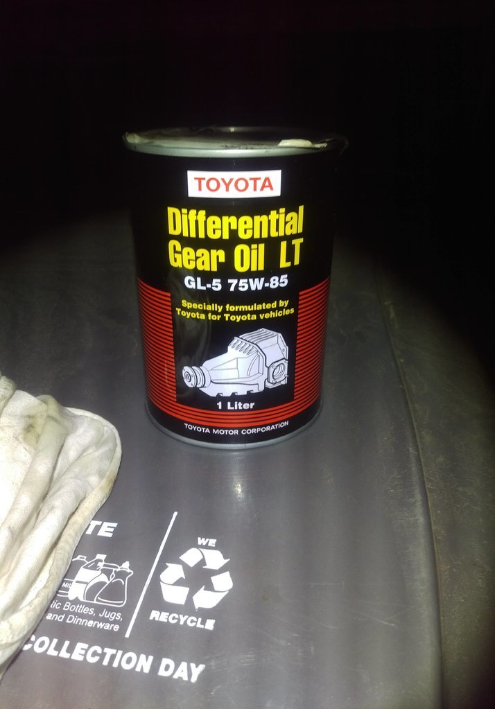

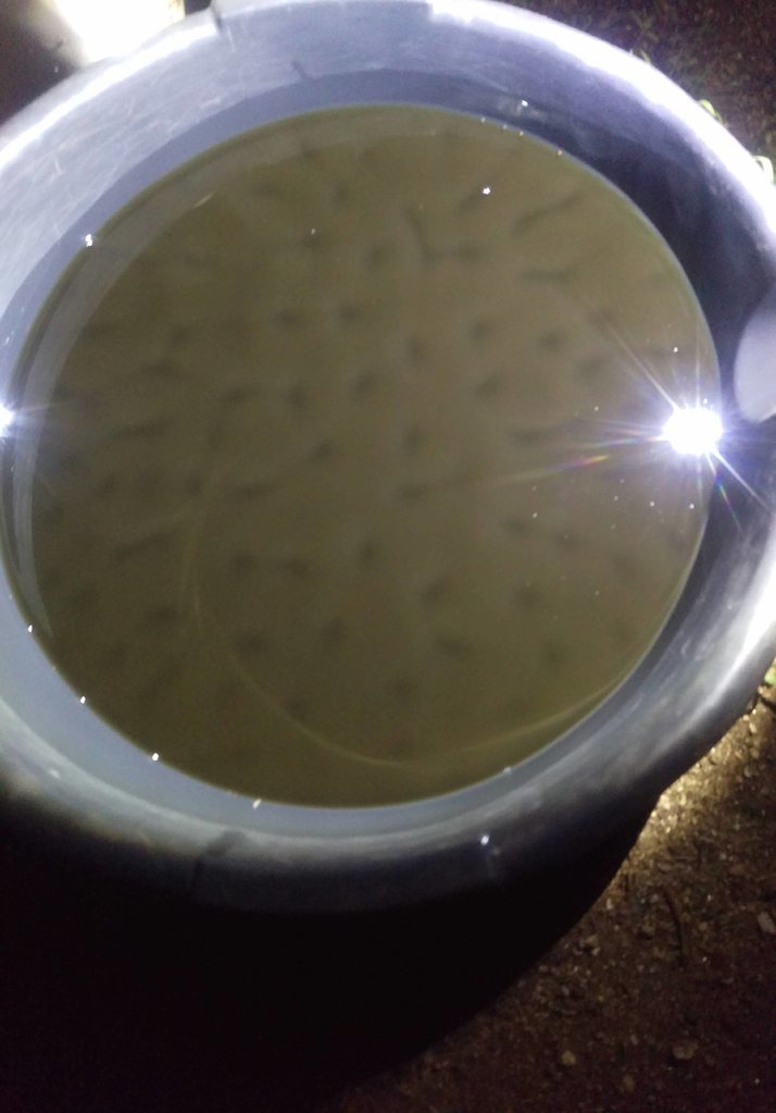

    ok guys. Just finished doing mine. I pulled the trigger on only getting three LITERS and it worked out perfect.
    I checked the level with my pinky and I touched oil before draining it and after.
    The overall process is like any plain o'l diff.
    There's two 24 mm bolts but I was able to use a 15/16... (don't judge)
    Used a pump to pump the new stuff. All OEM. Sh!t was not cheap... even with my brother's discount of almost 50%. 78.30 for all three cans. At least I can say that it came from Japan.
    So below is what you should expect to see after 58k miles. Kinda gloomy.

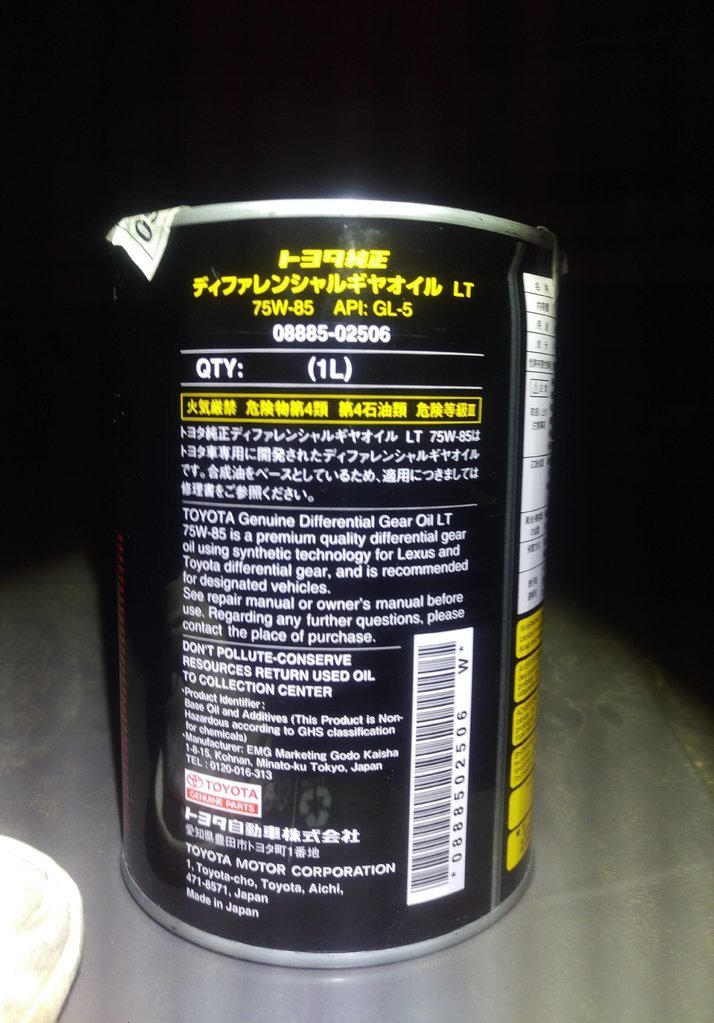

    The Toyota TC fluid comes in a 1L (Liter) can (1L = ~1.1Qt). One can was exactly enough for my drain and refill.
