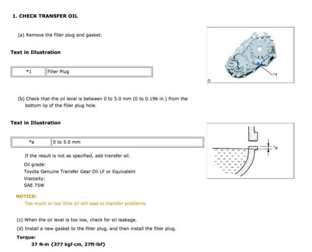

    It advises in the owners manual to engage it at least ten miles each month page 247

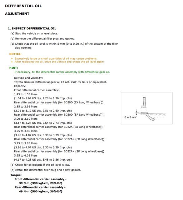

    Does the diff fluid need an LSD additive or is Mobil 1 75-90 just fine?

    Don't need LSD additive as yours is not Limited Slip.

    So I am no expert but the type of fluid recommend is LF. There is some concern that the amsoil and mobile 1 Etc.. Have a high phosphate concentrate which can cause soft metals such as copper and brass to deteriorate. There may be brass bushings used in the Synchros in the transfer case. Royal purple makes a product called Synchromax that is considered an LF type fluid that does not effect the soft metals. I contacted Royal purple, if you go to their site you see my question and they recommend Synchromax as the correct replacement fluid for LF. They also warranty replacement and repair cost if it is shown their product caused damage to the transfer case. All that being said, I went to three dealerships asking for the LF fluid and the parts guys looked at me like I was crazy. They said they just replace it with bulk gear oil.

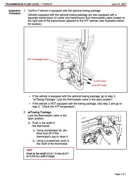

    Awesome thread... Thank you for posting the ATF thermostat info for the tow package.

    What post is this info in? I must have missed it.

    Ah I knew about all that. Not sure about a tranny thermostat though?

    It's the first picture. For the tow package, the thermostatic valve needs to be locked in the open position to get a proper read on the fluid level.
