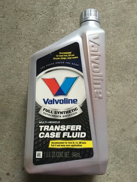

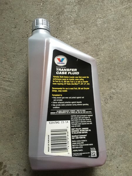

    Today I went into autozone and advance auto and couldn't find the royal syncromax. I thought about just ordering a couple quarts and changing it out whenever it came it but after your advice and some research, I would never have peace of mind as long as that shit was in there. So I did get 2 quarts of valvoline synthetic transfer case fluid, drained and filled it once, took it for a spin in 4wd, then drained it again to sort of flush it, then filled it back up again. This stuff should be ok for now right?image.jpg

    I don't know anything about the valvoline. I contacted Royal purple. If you go to their website for Synchromax you will see my question about the 2016 Tacoma transfer case and their reply. I would think the valvoline would be okay as it has the lower sulfur levels and is recommended for GM transfer cases. I got my Synchromax from Amazon. Again I don't want anybody to take what I am saying as gospel. It is information I gathered from doing research and asking some mechanic friends and family. I will say that I went to my local Toyota dealership parts counter and asked for the LF transfer case fluid and the parts guy looked at me like I was crazy and told me they just use 90w gear oil they get in a 55 gal drum. So there is that. I unfortunately am like you and leave nothing to chance and would have visions at night of my synchro bushings melting like the nazis faces in Raiders of the lost arc.
