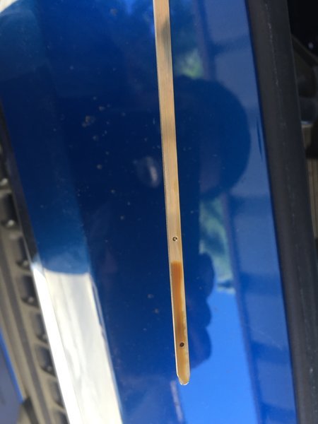

    Didn't know where to ask but since it's bout maintenance etc might as well, should my truck be waisting oil like this just checked my oil dipstick and it's showing that it needs oil am I crazy ? 2016 Tacoma trd sport 5500 miles I rechecked waited 5 minutes to reinsert. Dipstick

    Congrats on even being able to pull it out. :thumbsup:
    Was that warm engine or cold?

    Truck was cold been sitting for hours

    This is not completely unusual. In the owners manual it refers to some oil consumption during the break in process. I believe this occurs because oil passes by the rings until they seal correctly during break in. Look around and under your engine. It's new it should be easy to spot a leak. Valve covers in the back and the CPS have been reported by some to leak. If you don't see a leak keep an eye on your exhaust. Blue/white smoke is usually an indicator of burning oil. All that said 1/2qt (or less based on your dipstick pic) down after 5000 miles during break in period isn't horrible . I'd keep an eye on it.

    You do realize that's not very low ... actually its where my oil level was on dipstick new. It does not have to be clear up to that top dot

    I'd really suggest you read your Owners Manual. Per page 456: #1 - check oil level with the engine warm, not cold. #2 - oil level is normal anywhere between the two dots and isn't "low" until near or below the bottom dot.

    We have no point of reference, so really can't say. Was it previously at the full mark and how long ago? Also you checked cold, so if you check it properly, with engine warm, you may be right at the full mark. Either way, it's safe, you're well above the min mark. As far as whether it's using oil or whether there's a problem, not enough data given to determine. With a new vehicle, you should be checking every fill up to trend and monitor for any oil usage. Even just a little bit will likely eventually foul your spark plugs prematurely.
