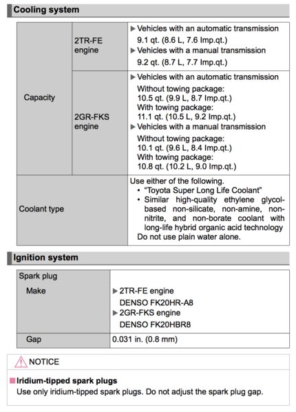

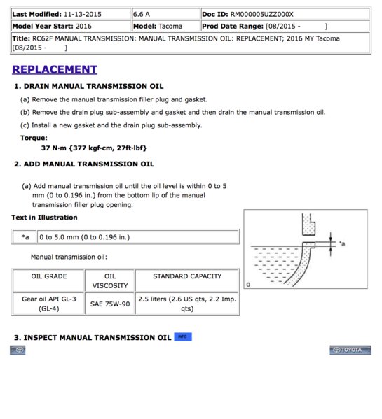

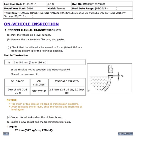

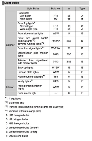

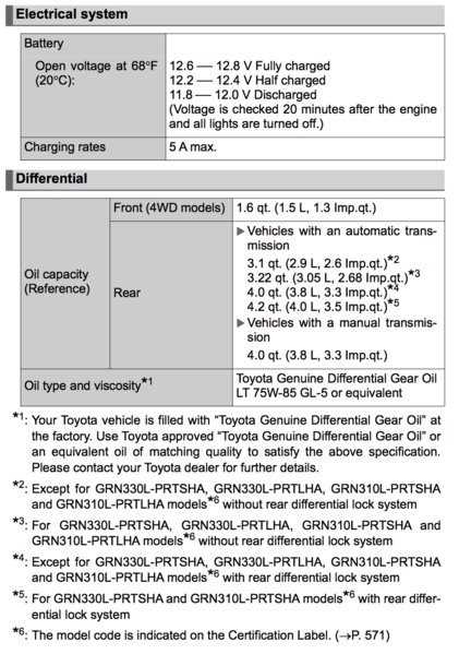

    17 Tacoma DCSB TRD Sport V6 Manual 4X4

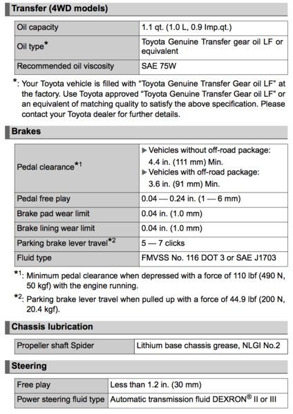

    What's the Manual Transmission interval and oil type? I'd also appreciate if you added brake fluid, clutch fluid, power steering fluid and coolant intervals/types.
    CenCal805 likes this.
  15. Jan 28, 2017 at 2:39 PM
    #295
    renau001
    renau001 Well-Known Member
    Dec 20, 2015
    #172744
    129
    If somebody can give me the info, I can update the OP pretty quick. It will be a little while before I can look it up myself.
  16. Jan 28, 2017 at 3:34 PM
    #296
    EB Group
    EB Group Carbon Jedi
    Jul 14, 2015
    #159469
    1,406
    Rudy
    Halifax
    2017 TRD Sport DCSB 6M
    Here you go. From the FSM and Toyota's Website
    I could not locate a schedule for Tranny Fluid, and I added some info that wasn't asked for.
    The last attachment is a pdf of the service schedule.
