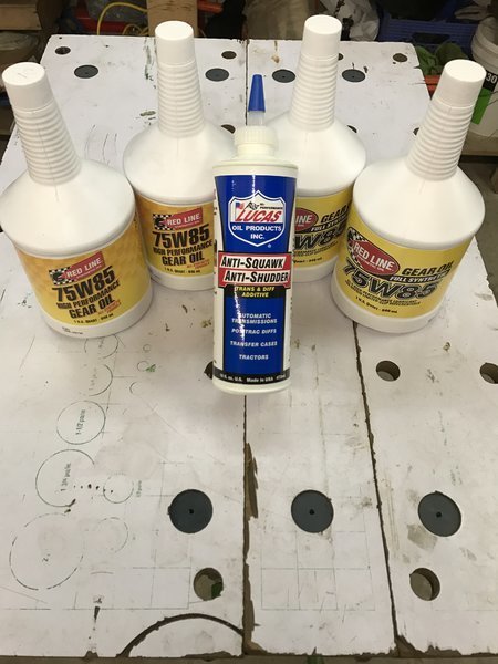

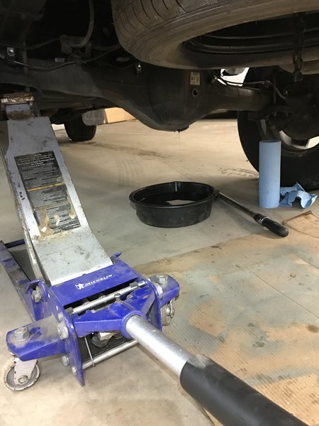

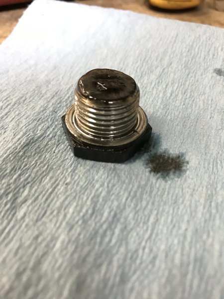

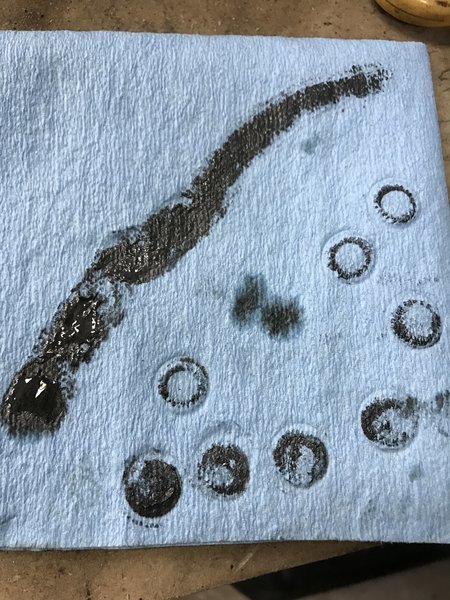

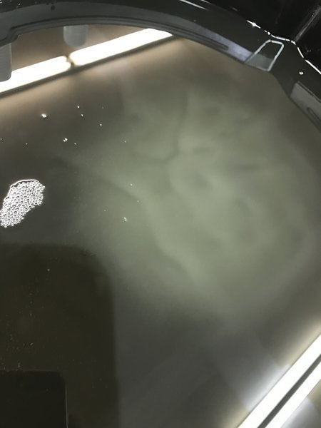

    Here are the results after changing my rear diff fluid today and adding the Lucas Oil Anti-Squawk / Anti-Shudder Additive as well.
    The drain plug had lots of crap stuck to it.
    I was surprised as to how contaminated the fluid had become in 4300 kms.
    I could run my finger through the fluid and it would stir up significant amount of debris that would swirl around.

    Manual does not say anything about requiring a friction modifier.
    The reason I added something to mine is explained here: Hum on deceleration
    Fluid the manual states is 75W85 GL5 or equivalent.
    Rear Diff Volume - 3.1-4.2 qts (varies with model)
    Mine took the 16oz additive plus 4 quarts of fluid. I have a 2017 TRD Sport 6MT

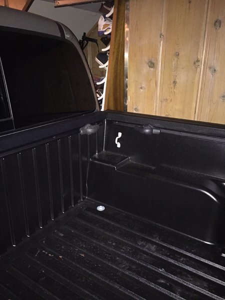

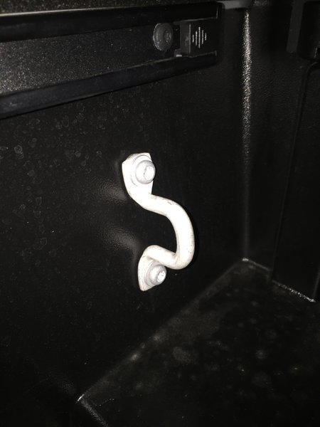

    Anybody know if these are rated for 400 lbs. motorcycle? I looked through our 640 page manual and could not find it. Or do I need to install bed bolts PT278-35054. Thx TW
