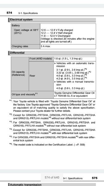

    I'd note that the number in the door jambs could be erroneous based on historical info - I have the service manual and will verify; but I have a TRDSport 4x4 6M/T. When I googled the diff number in the door jamb I got a much older, smaller ring diff. That said I bought 6 quarts when I did my diff fluid service and it was *barely* enough. Buying an extra quart seems dumb, but I found it was cutting it really close without.
    As long as its GL-5, you're good to go.

    Your service manual should list your truck and correct fill amount. I wouldn't trust google.
    Just fill until she overflows. I've always said that.

    Understood - I did a nice writeup somewhere on here - the point was the code on the doorjamb won't tell the whole story. My example being the "B06A" diff doesn't exist in the service manual as far as I can tell (I have an earlier version downloaded) and I needed more than the fluid noted in the owners manual. A lot easier to buy too much early than be underfilled and need a ride to the parts store.

    While not extremely intuitive in the manual, the number I'm talking about would be the "GRN3..."
    Did your M/T truck take more than the 4.0?

    It did, it took closer to 4.2 or 4.3 (it was tough to tell as I pour the remains of the last bottle into the new one before pumping in - but I had every bit of 6 empty quarts of my diff fluid after the front and rear diffs were done). As you said early on it's all about the fill to trickle; just wanted @killthehippies to know to over buy (better safe than sorry thing).

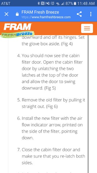

    The arrow on the oem one points up and tells u to install face up as arrow indicating but on the fram the arrow points up and indicate air flow direction! When I pulled the old one the dirt seamed to be on the top side what led me to believe the arrow need to face down! Anyone can shime on this?

    This screen capture is off fram's website
