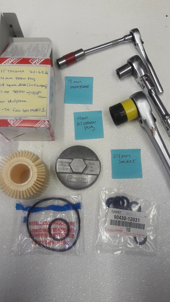

    I perform oil changes on 6 different vehicles...so I make a cheat sheet for each one. Here is the one for my 2017 TRD Sport LB. First oil change at 2,400 miles...noticed a lot of metal flakes in the bottom of the oil filter canister.
    Replacing engine oil and filter, 2016-2017 Tacoma V6:
    First time for this vehicle took me 1.5 hours next time it should take 0.5 hours. Bottom photo is the install of my new SnugTop Sport Hi-Liner Topper. Have Fun!
