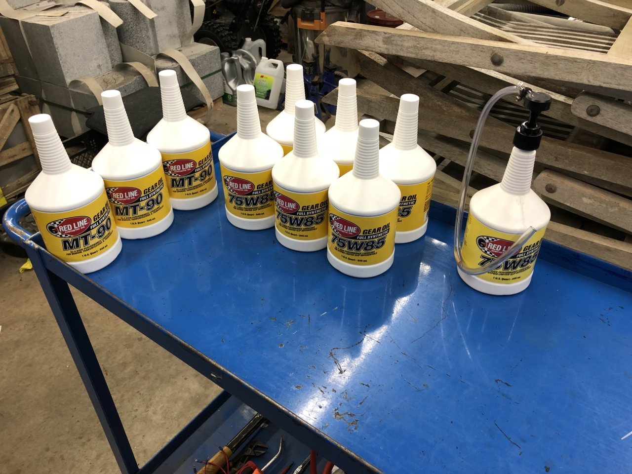

    I just ordered some Redline 75W85 GL5 Front and Rear Diff Fluid & 75W90 GL4 MT Fluid.
    I might do a how to video on changing the 3 Fluids.
    I'm at 51,000 KMS approximately 32,000 Miles. I had already changed my rear diff fluid at 3000 KMS approximately 1865 Miles with Redline 75W85 GL5 and the factory fluid was VERY polluted at that point.
    I'm very curious to see how the Redline fluid held up for 48,000 KMS.

    Got my Oil in last week and bought a GoPro to do a couple walkthrough videos and I've been non stop busy since. lol
    I'll try to get to it this week.
