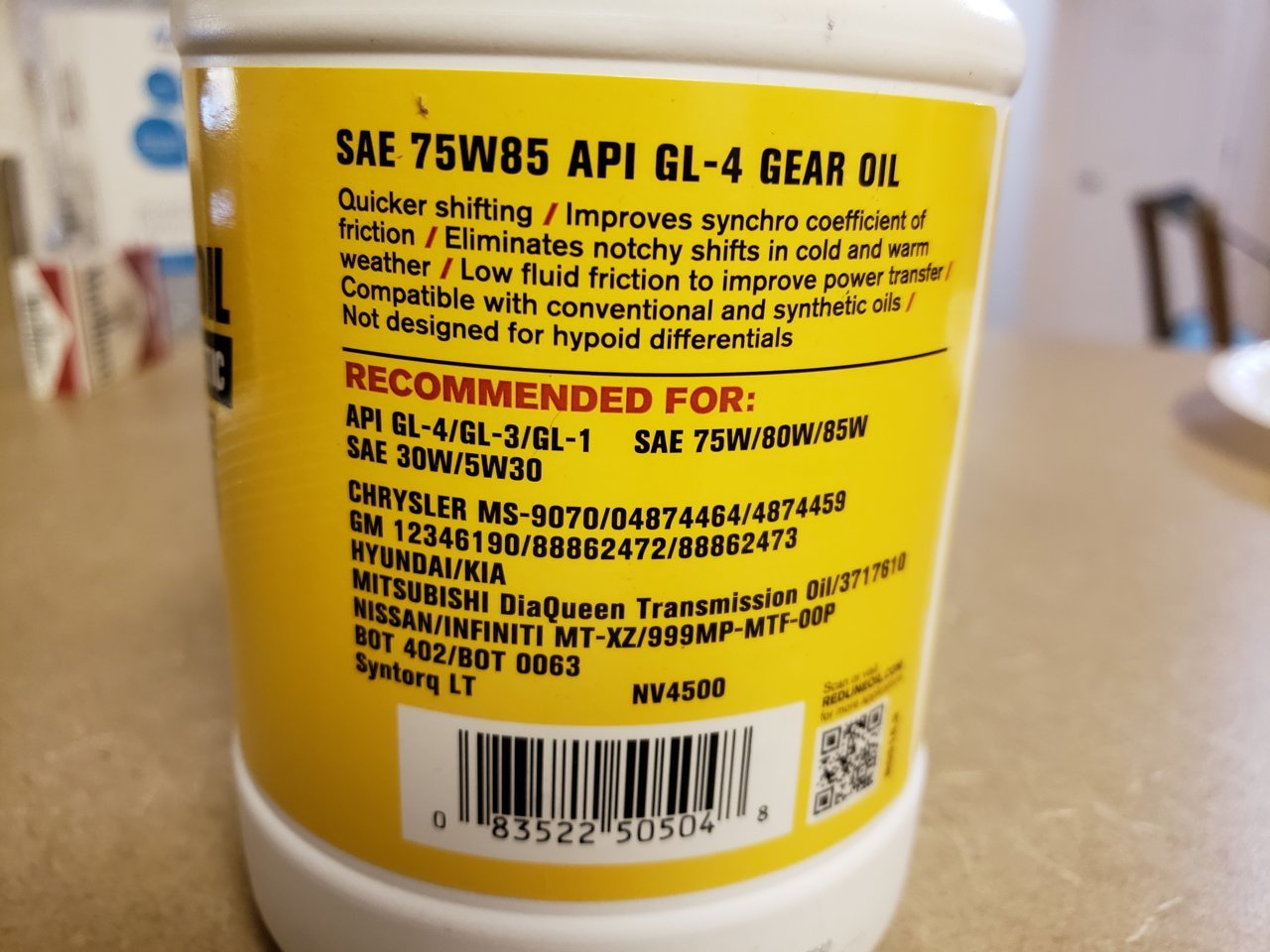

    I ordered my diff and manual tranny oil. I'm a little over 5,000 miles. Seeing as I'm planning on keeping this truck for a long time, I feel it's worth the money.
