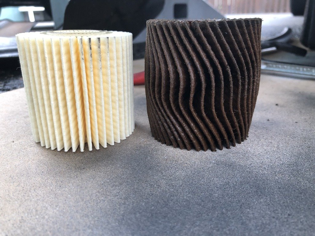

    I'm sure you could...I went with Ravenol to be safe.

    The new filter is correct. The used filter is for a 4Runner.

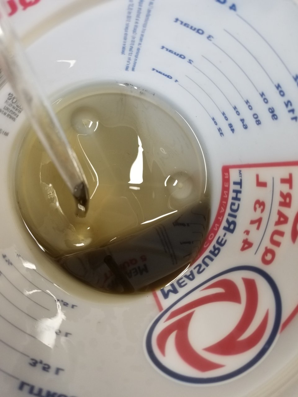

    -This also came from the factory over 1qt low. I filled it to spec with Amsoil Severe Gear 75W-90 when it was new.
    -Easy job. Looked better than I was expecting. Still had a gold hue to it (see pic below), which isn't bad for 38k miles but it had about 1/4th Amsoil in it, as stated earlier. Maybe why? I dunno.
    -Magnet drain plug was gooey, as expected, no chunks (haha, "gooey" and "chunks")
