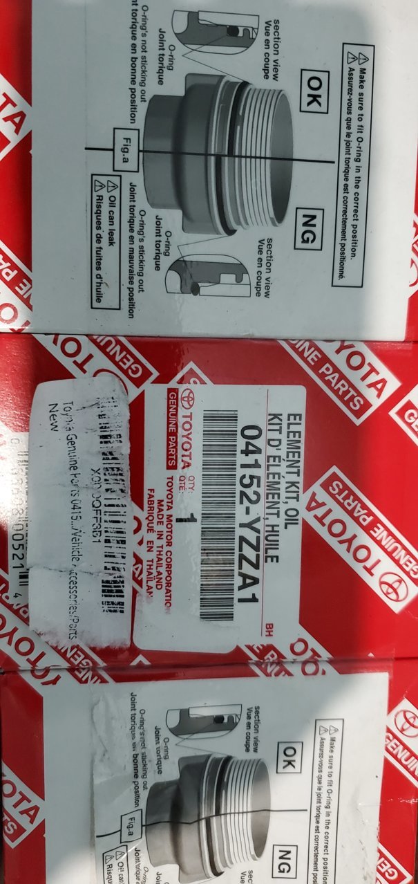

    @Thatnoobguy I suppose we just have to figure that (without explanation from Toyota) that those 2 part numbers are interchangeable. I haven't seen someone post up a side by side photo of the 2 filters with both part numbers yet, and no verifiable commentary from any reliable sources.

    Seems so. Got 4 more filters under that number, if you need more pictures incase someone has one sold under other number.

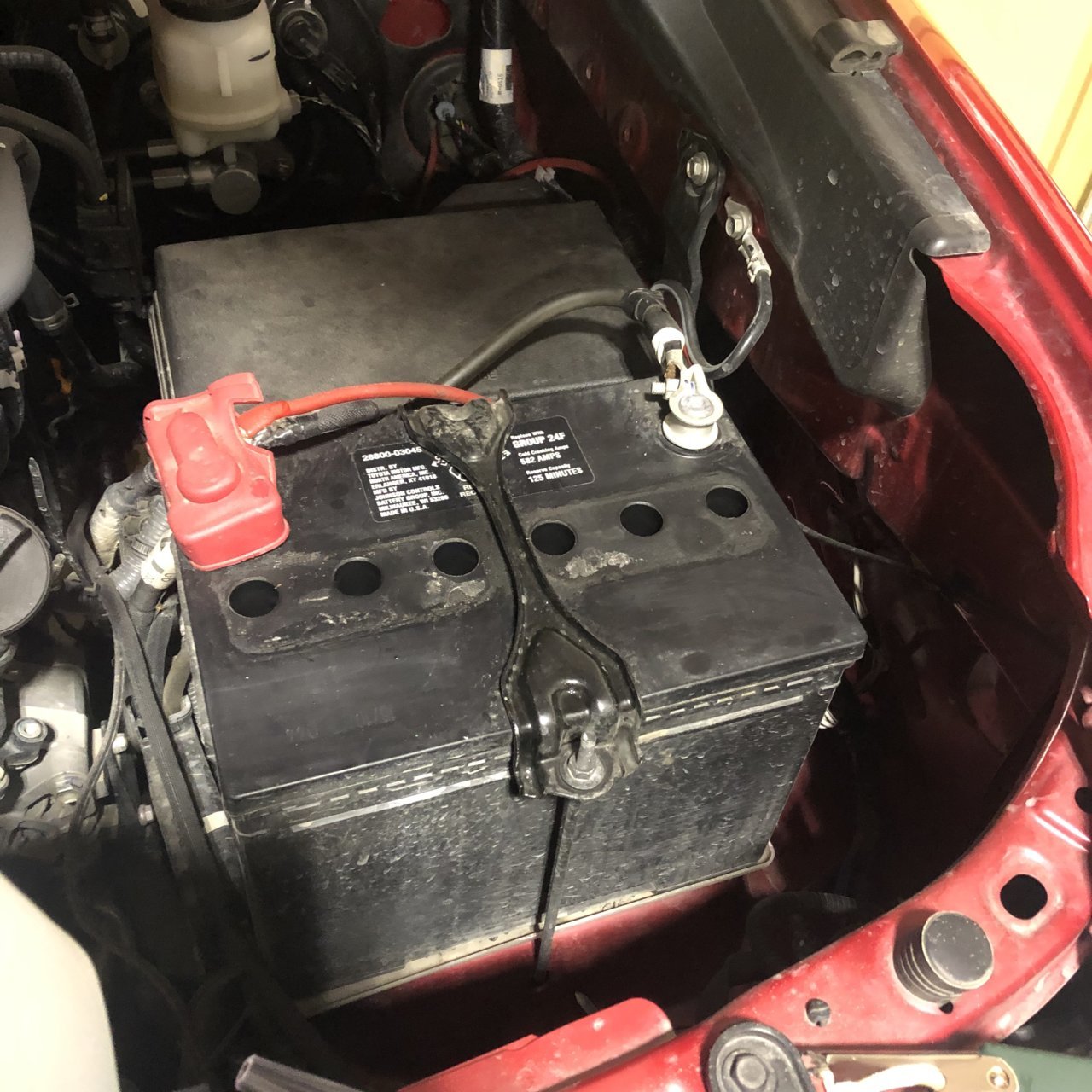

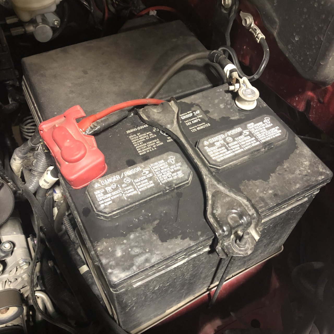

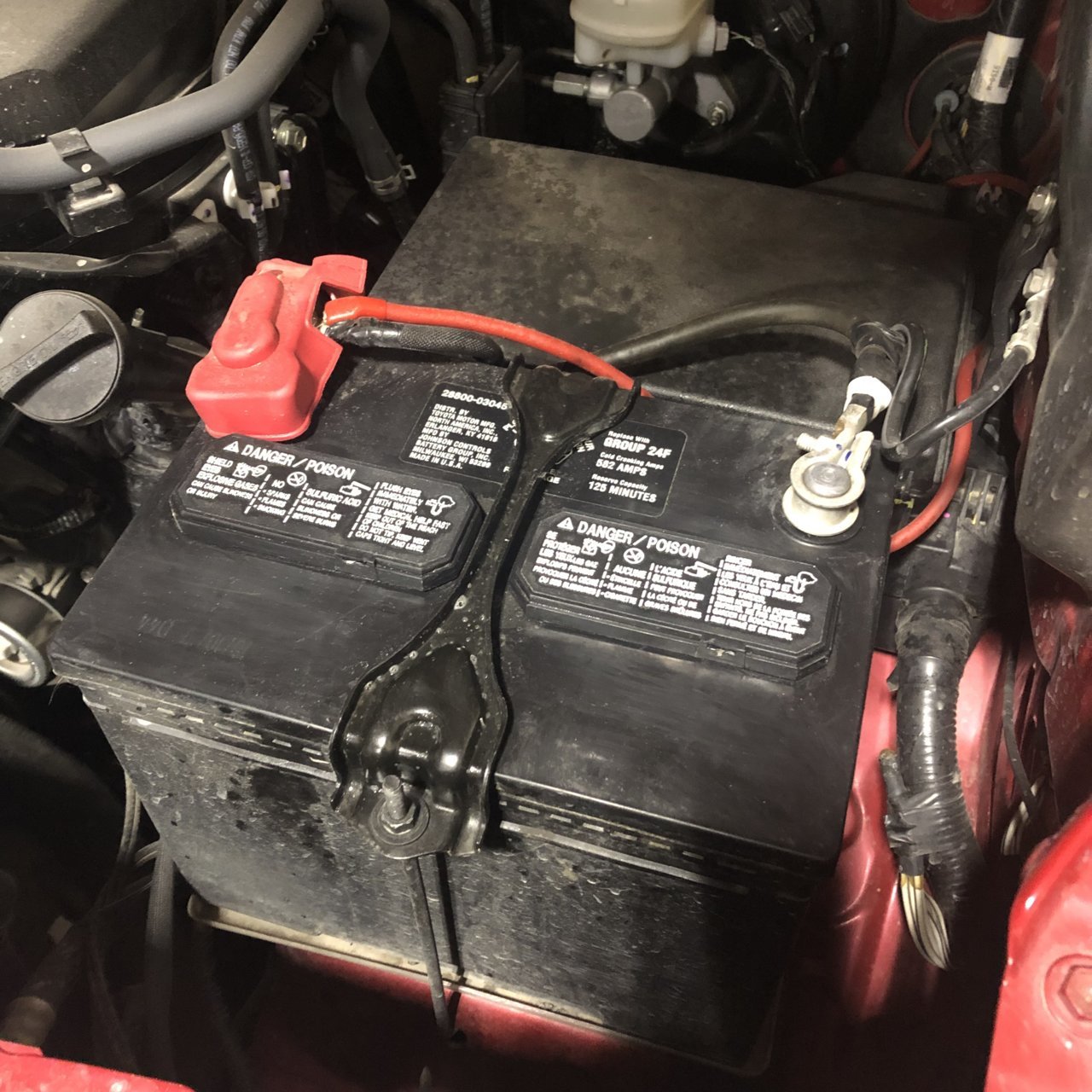

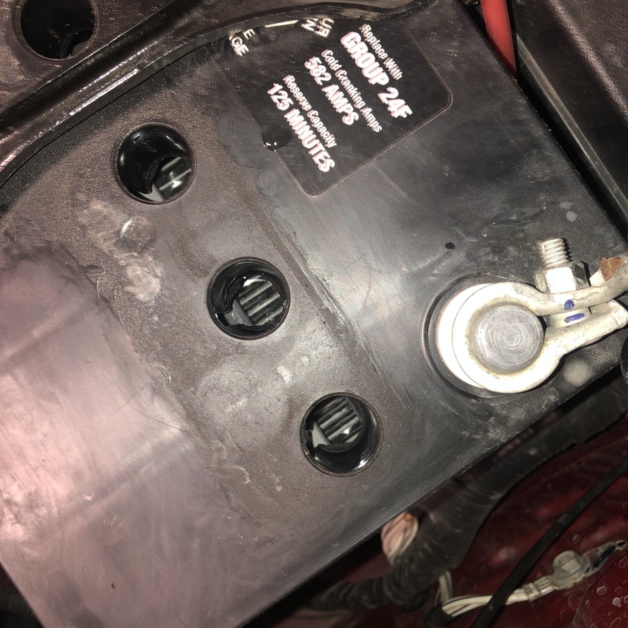

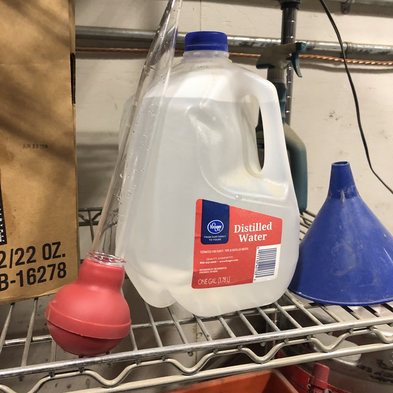

    One thing I haven’t seen on here yet is battery maintenance. I was frankly quite surprised when I saw that Toyota doesn’t give us a sealed battery from the factory. Because the battery isn’t sealed it means we can and probably should check the water levels in the battery at least occasionally and top off as neeed.
    If I’m doing it wrong, please correct me!
    You’ll need:
    Eye protection and gloves
    Distilled water
    Flashlight or head lamp
    Something to put water in the cells. I used a cheap turkey baster.
    Pop your hood and look at your battery. It’s probably dirty, and it’ll probably have wet spots around the caps on the battery top.
    Clean the top off, and pop the caps off. I used a bottle opener (flat end, not the pointed end) because that’s way I had handy but a flat blade screwdriver would work too.
    Look down the holes and see if the electrolyte levels are level with the bottom of the holes.
    Nope!
    So, go one cell at a time and add a little bit of distilled water until the water level is flush with the bottom of the hole. Wipe off the top of the battery, making sure nothing else gets in to the battery, and pop the caps back on. Try not to drop a cap down on to the skid plate like I did and it’s a 15 minute job. :) I needed 0.5-1.5oz of water per cell.
    My truck is a 2017 and was purchased in April 2018, has 27500 miles on it. Every cell was low by quite a bit, so hopefully this helps extend the life of my battery (and yours too, if you maintain it!).

    Nice to mention this overlooked tip. I like to mix up slurry of baking soda in water and brush that on the terminals to neutralize any acid corrosion going on, remove battery and clean it off, clean out tray the battery sits in and leave a layer of baking soda in the tray once dry. Clean off the battery posts w your choice of technique, as well as the insides of the cable connectors that mate w the battery posts, and smear on a bit of dielectric grease. Can also brush on some NOCO NCP2 battery corrosion preventative. Did all this to mine 2 months ago, but oops.........didn't check the cells. Now my OCD compels me to go out and do this right away before I forget. Thanks for the reminder @skierd .
    Make certain you are adding pure DISTILLED water into the battery cells. That's really key.
