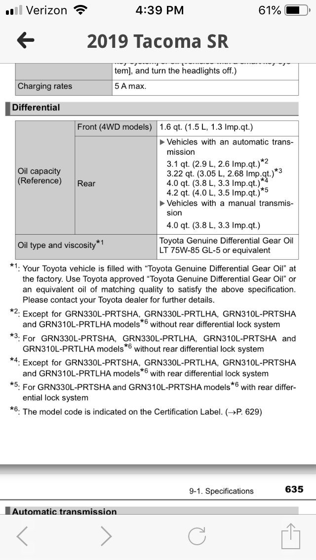

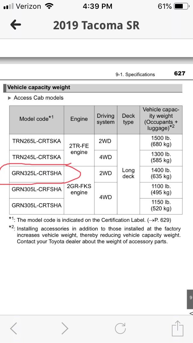

    I have a 19 SR access cab 2wd v6, getting ready to change rear diff fluid. How much fluid does it take. I have looked over the chart but I guess I’m a little confused with it.
    I have this model-
    And here is the chart. I don’t see these numbers, so does it take 3.1qts?

    im going to assume since you have the 2WD V6 with the smaller 8" rear diff with no rear differential, you probably take about 3qts. I'm not sure myself but I'll try to find out exactly.
    Ok, I'm going to assume that all V6 trucks by default take atleast 3.1 qts. (Except for Manual transmission which take 4.0qts)The only exceptions are for the model numbers on that list, which you don't even have, these are the models shown:
    GRN310L-PRTSHA, GRN310L-PRTLHA
    GRN330L-PRTSHA, GRN330L-PRTLHA
    The the exceptions listed are all V6 Double Cab Long beds. Some 2WD and some 4WD. For some reason the DCLBs take a little extra fluid.
    The Standard rear diff for 2WD/4WD and no diff lock is 3.1qts, UNLESS you have one of those models listed above(which are all DCLB V6 2WD or 4WD) in which case you need 3.22qts
    If you have a rear differential lock, (TRD OR and Pro only) then you need atleast 4.0qts, UNLESS you have a DCLB with rear diff lock, then you will need 4.2qts
    So the basically:
    *2 is for most vehicles
    *3 is for DCLBs
    *4 is for differential lock trucks
    *5 is for DCLBs with differential lock
    And all MTS take 4.0qts

    I appreciate the excellent response! I kinda thought it was 3.1qts, but just wanted someone else’s opinion.
    I also was gonna measure what came out. I have a 6qt bucket with the scale on the side.
