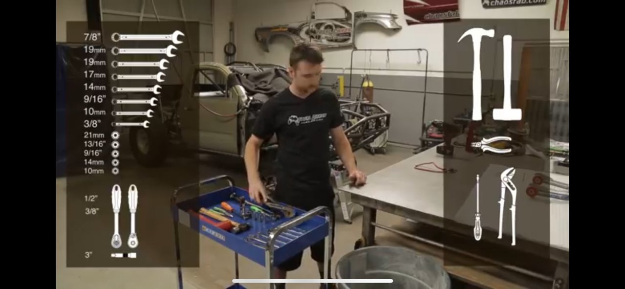

    I have a strange question I would appreciate some help with if possible. I am trying to build a tool kit I can take on trips, but I am not sure what size wrenches/sockets my truck needs outside of the lug nuts. If there was a short list of sizes I should have what would that be?
    Thanks for the help/advice

    This is what you need for any suspension work. This is from a video of Total chaos installing UCAs and coilovers.

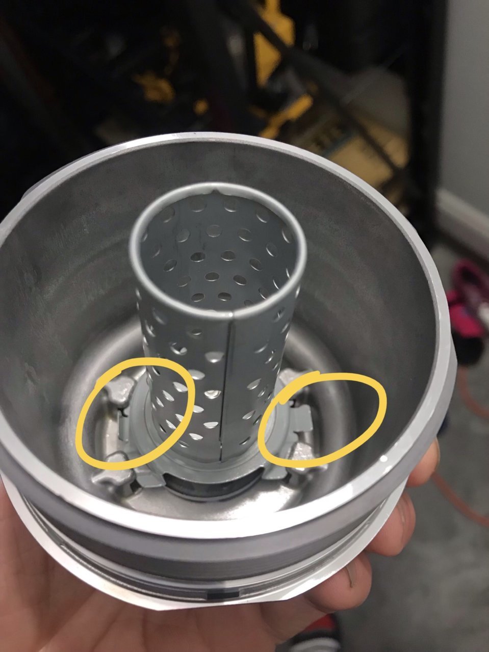

    Bump, rather not start a new thread. Does anyone have this in their cabinet that can take a look for me how it should be

    Ok so I finally did the trucks first oil change 1/yr 7500 (and was my first cartridge style) which was why I was asking about the tabs in the previous post. I figured it out- tabs need to be lifted up to “lock” in place essentially.
    I had no issues with the filter drain plug or the plastic filter housing (I was the 1st to touch it too so there’s that) but that tip about a quick impact to break free the filter drain plug was spot on! My pan drain plug crush washer was stuck to the pan so I did have to carefully pick it free. Next time I think I will use the 5/8” tubing for draining the filter (although it really didn’t make a mess with just the little clear adapter piece).
    Spend a good amount of time at Walmart looking at all the oil labels and went with Castrol edge ep 0w20. It’s equivalent and frankly was sold on the marketing “recommended for severe applications incl. towing/frequent short trips, idling/high performance driving/dusty, humid or extreme environment” on the back. Always used to get mobil1 for no other reason than the name so…
    Used oem filter cartridge and new crush washer. It took longer than I’m used to but it wasn’t hard at all just more time consuming taking the dam and stock skid off.

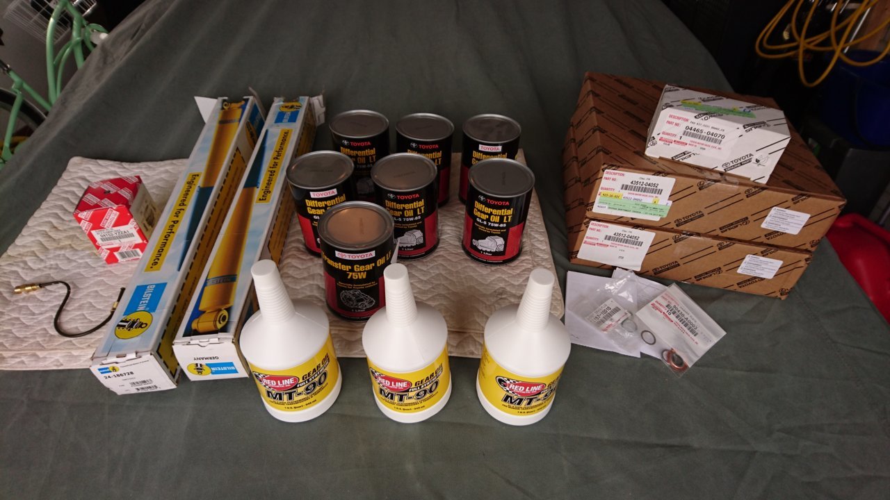

    Yup redline in my MT also. I have a pic of my inventory in here a ways back
  17. Sep 7, 2019 at 1:09 PM
    #697
    TeecoTaco
    TeecoTaco Liberty Biberty
    Feb 26, 2017
    #211739
    10,792
    SW Ontario
    16 Taco DCSB TRD Sport 6MT
    Modified the level of gas in the tank
    Wasn't this thread that I posted the pic
    My 100k kms maintenance inventory
