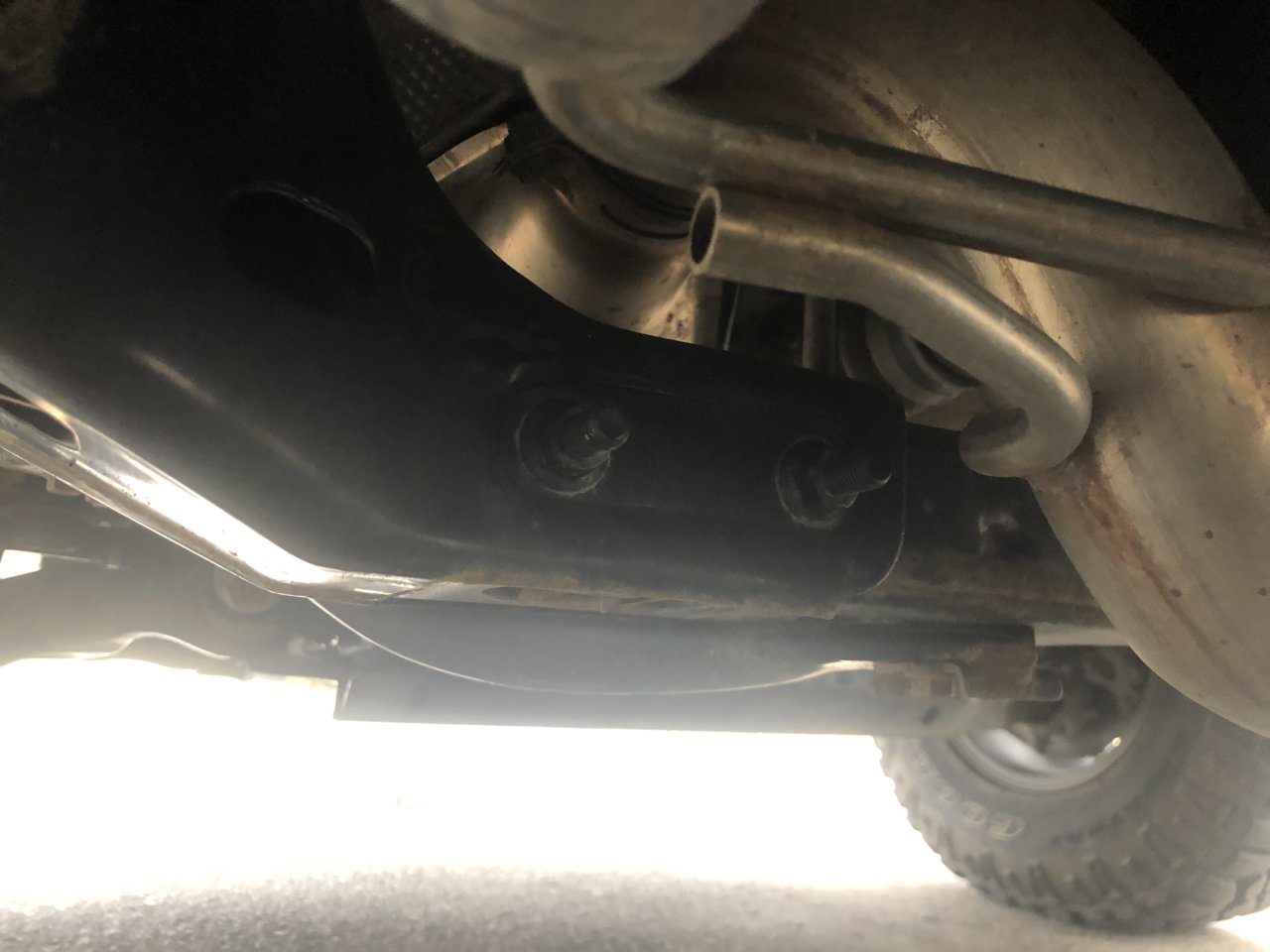

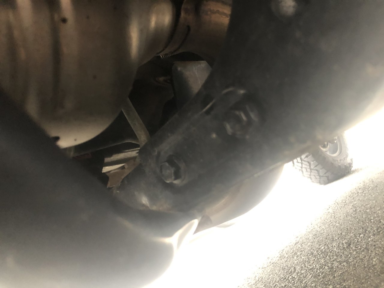

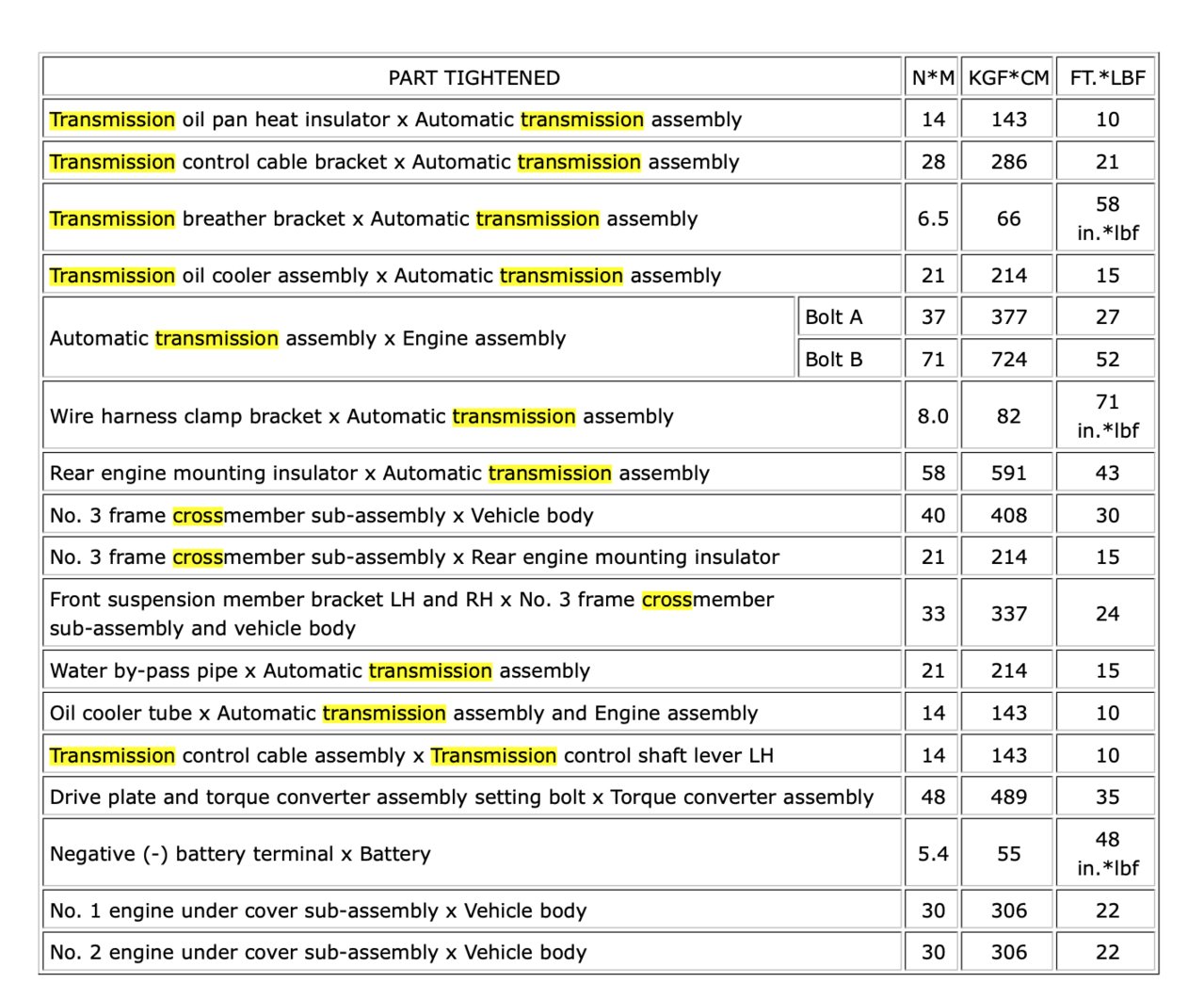

    does anyone know the torque specs for the 4 bolts on the transmission crossmember for a 16DCSB? Looking to put on my mid skid this weekend and cant find them.

    This is from 2016 service manual not sure if it has what you need but does show the cross members

    thanks not sure if its what im looking for either. ive been told 48ft lbs on the good old facebook, found the link someone posted up for the 16 service manual, currently combing throught that.

    D178FB53-A937-4A18-88D0-77BF6DDD1C8C.jpg 63BC6AD9-1988-4395-AE05-FFC3E2828CB1.jpg The bolts are 14mm and I’m a bit of a mechanical noob, trying to do as much myself as i can to learn.
