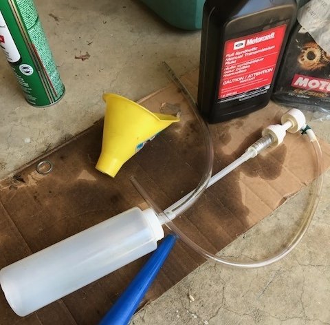

    Anyone got a good reccomendation for a transfer pump for the diff, t case ect ? Trying to not make a massive mess and waste fluid

    Hello, when it comes to differentials, gear oils and the like; anyway you try you WILL make a mess. Just accept it.
    I bought one of those pumps off Amazon. Not great. Worked ok, no less messy than any other method and A LOT of pumping (~75/qt). Didn't need it for the rear diff and could not use it with the can for the t/c (Unless you dump the can into an empty bottle.... see below
    what I ended up using for the t/c and would recommend is pic below: cheap catsup bottle from the dollar store. A foot or so of plastic tubing from the hardware store. The flexible vinyl stuff. A cap of some sorts if you like. Just pour whatever 1/2 qt. At a time into the catsup bottle and squeeze it into the tc or mt or front etc. Whatever. throw the whole smelly mess out when your done or drop it in a zip lock bag.

    Harbor freight specials for ~$6-8, use a 20% coupon if you want. I buy 2 or 3 and keep them around to use on whatever.

    As far as those gear oil pumps, any of the outboard motor gear case pumps work well. They will screw on nearly all gear oil bottles.
