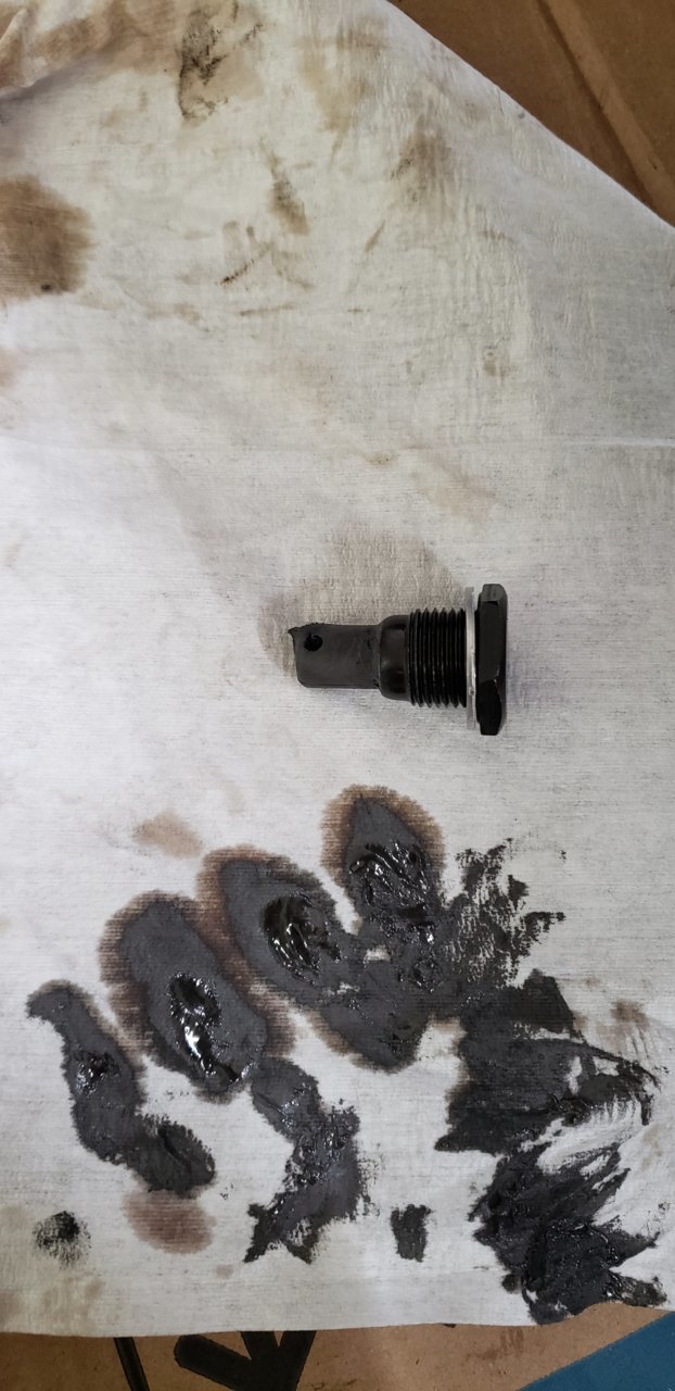

    Was this your first fluid drain/fill or have you been doing those regularly (ie every 30k or so)? On most sealed transmissions, it's more of a larger particle strainer vs an actual filter element. Just curious why you went this far vs doing regular drain/fills since this is technically not a required service item. But neither is the fluid I guess per "lifetime" Toyota assessment.

    At around 75k I started doing the fluid check procedure, which introduces 1 fresh quart in to system, every 5k miles. Fluid coming out was very very dark red, not burnt but not exactly healthy. Decided after I hit 100k I would get in there to change the filter and clean the magnets off. No science here, no facts, I just wanted to do it.
    I tow a camper pretty regularly as well, I might even qualify for severe use but since toyota dosen't specify what that means, I'm not sure.
    And you're right about the filter element, it looked more like a sponge than a filter, mine did have a fair amount of metal in it.

    Makes sense if you have the time and knowledge to reseal the pan (not rocket science).
    From experience with another slush-box, the longer you let it drip, the more fluid you'll get out. Even jacking up one end of vehicle will help get more out.
    Picture of magnet and fluid (more burnt sienna than red) from another vehicle after 45k. Can't recommend more doing regular drain/fills than what's in the manual. This is coming from a 4dr sedan that lead a pretty easy life so just imagine what your fluid looks like when you're towing and driving hard. That's it for my PSA.

    Good Info. My fluid looked about the same when I started doing the level check at 75k. Its looked much better when I pulled the pan at 105k. I will continue to drain and fill (fill and drain?) From here on out
