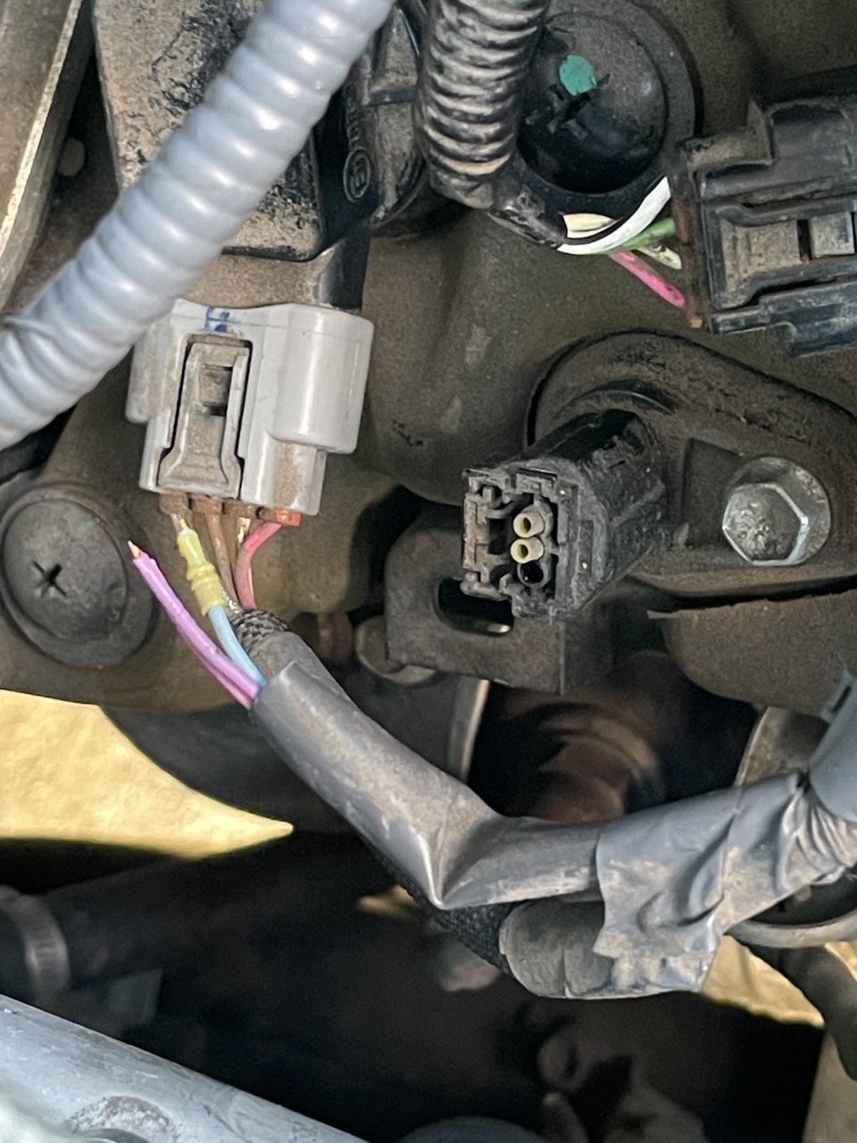

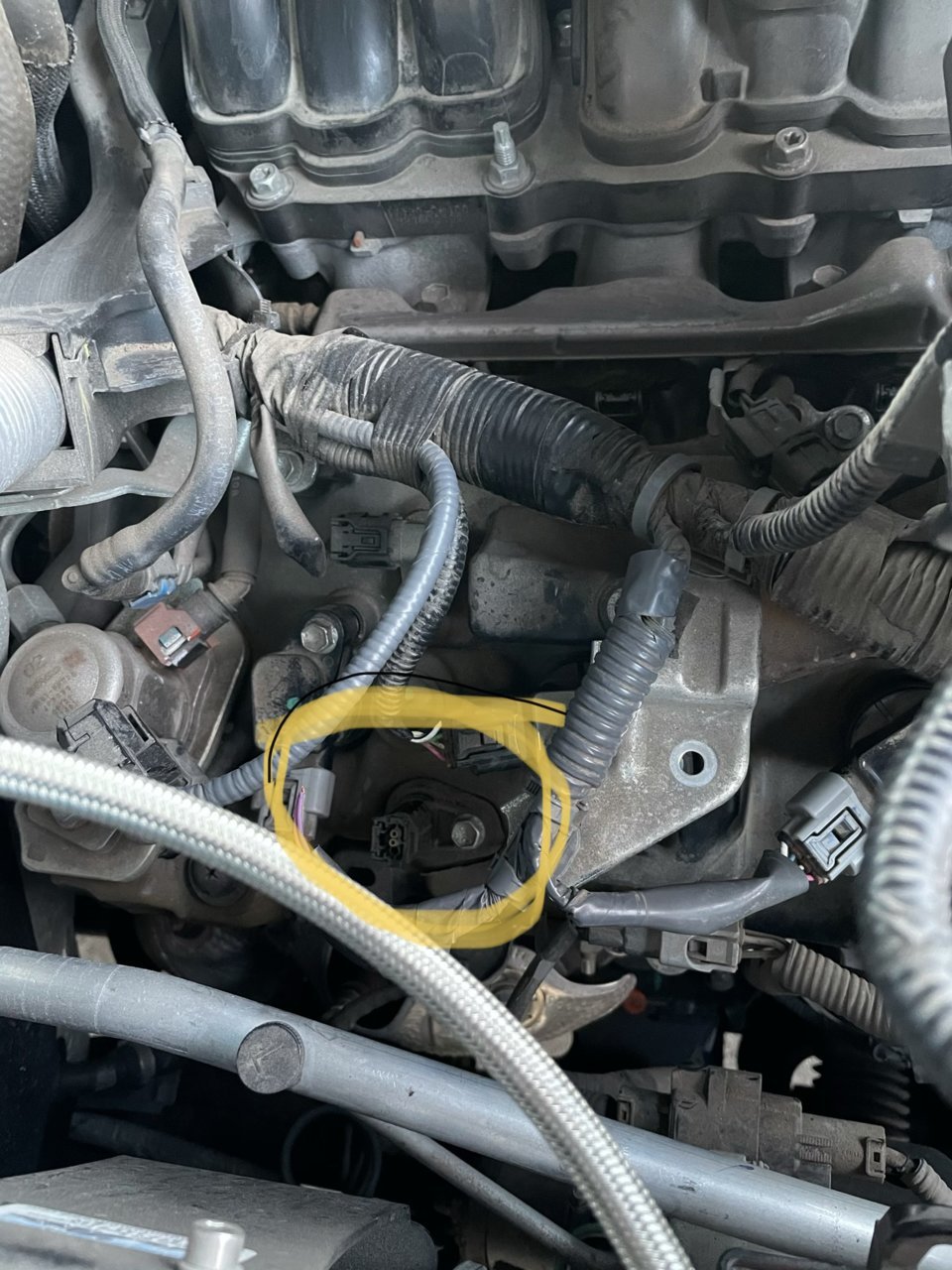

    I’m an idiot and yanked these 3 wires by accident while changing the spark plugs. Am I in over my head or you think I can fix this? I am pretty good with electrical but don’t want to mess anything up working around the engine. Also anyone got the correct order of these? :frusty:

    I would order a new plug, and splice it in

    That's what I was thinking, thanks. May try to put it back together first. Any chance smeone can snap a picture of the order of the wires that go into here? they are 3 different colors

    Looking like part #90980-12353 aka camshaft sensor

    I got it from another member thanks though man!
