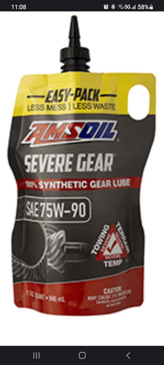

    I use the same amzoil in the front rear and transfer case

    75W90?
    and the oil is just oil? or is there difference of the differential oil and transfer case oil..

    Redline makes transfer case oil that meets Toyota spec: Redline MT-LV GL-4 Gear Oil--how much of a difference it makes--im not 100% certain but since its spec thats what I used. I used amzoil 75-90 for the front and rear diffts in the bag that shotgunbill420 posted. And i used Redline MT-90 in the Manual trans fluid. Works like a charm!

    I mentioned amzoil not redline

    Oops I meant amzoil, corrected
