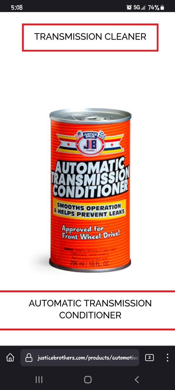

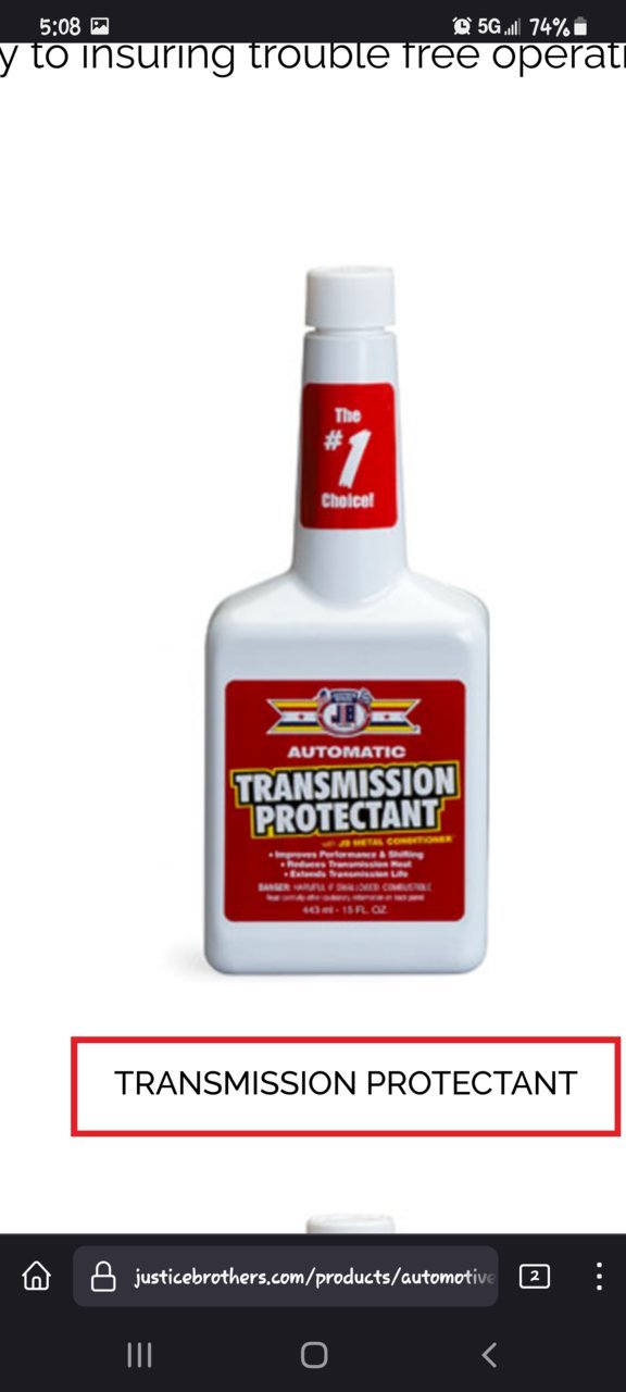

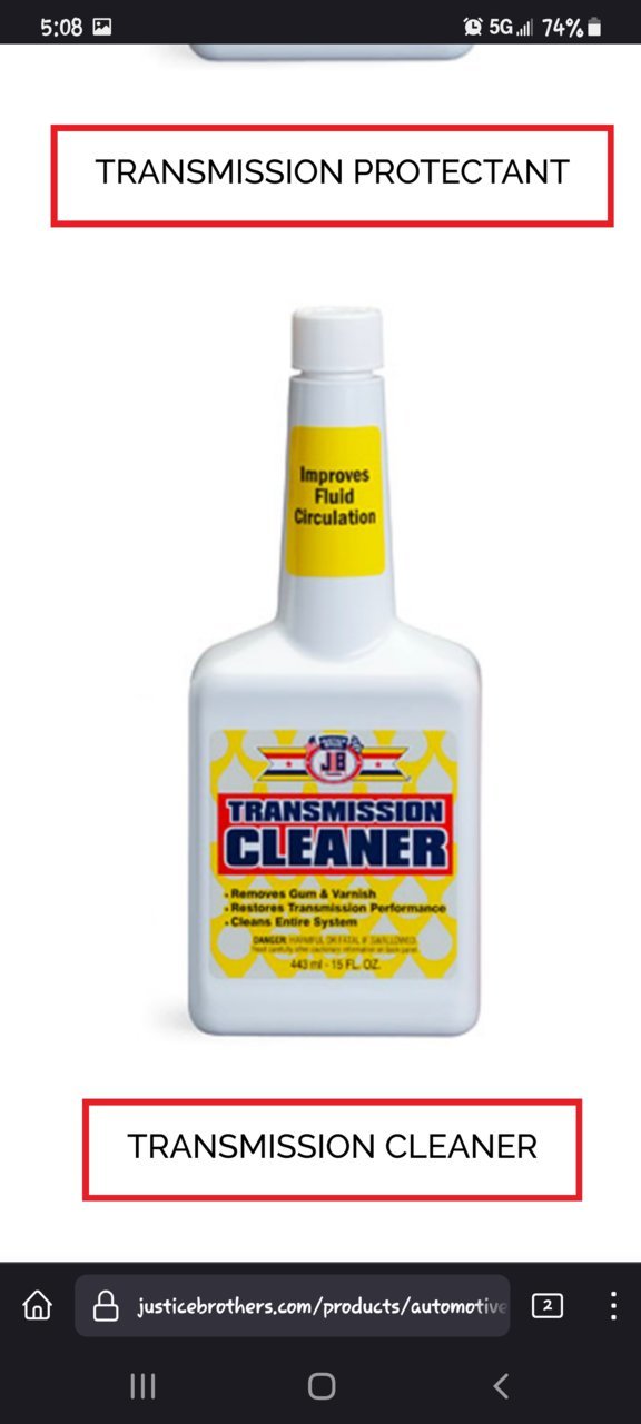

    So my dealership does this program I forgot . Screenshot_20220216-170838_Firefox.jpg Screenshot_20220216-170831_Firefox.jpg Screenshot_20220216-170825_Firefox.jpg

    @MiTacoTRD I posted what they include in there service
