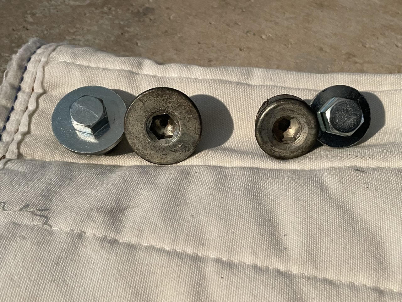

    Did my 75k fluid service, so along with the regular engine oil change i did the oil in front/rear diffs and transfer case, and flushed the power steering fluid (transmission was already done at 55k). The diff oil was understandably dirty, the transfer case looked ok, but holy shit the power steering fluid was disgusting. I flushed through ~1.5qts of ATF to get it looking good again.
    A couple of things I learned: the transfer case fluid shoots out of the drain hole with a ferocity akin to the aftermath of a Taco Bell lunch; the initial placement of my drain bucket was comical compared to where to the fluid ended up on my garage floor. And that a T55 bit can save the day if you happen to have misplaced your 10mm hex bit. I guess good thing I was already planning on replacing the 10mm front diff plugs with these 14mm socket plugs anyway.
    Drain — Lexus part 90341-24016
    Fill — Toyota part 9034118060
