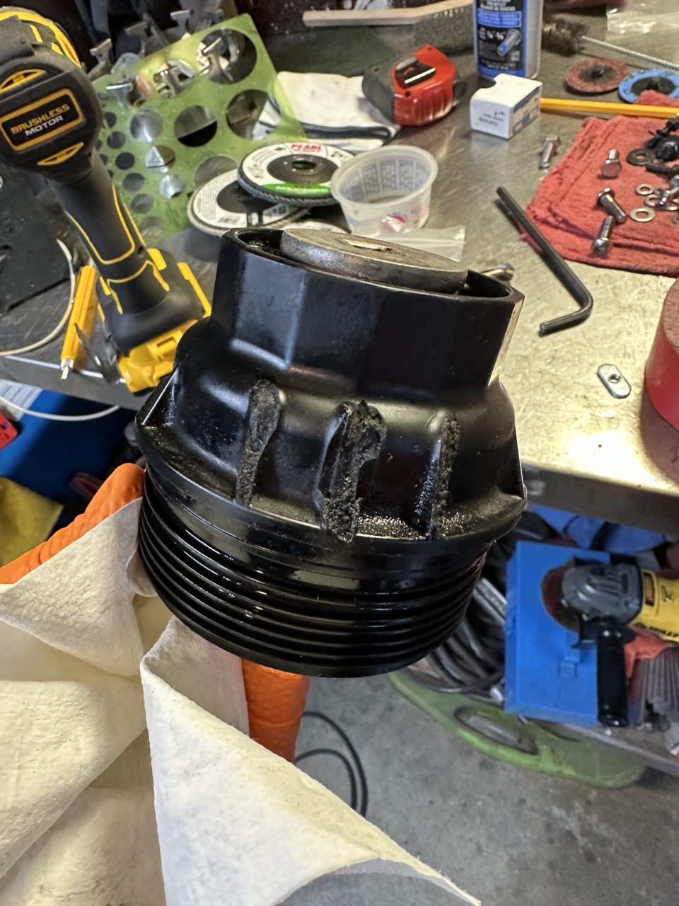

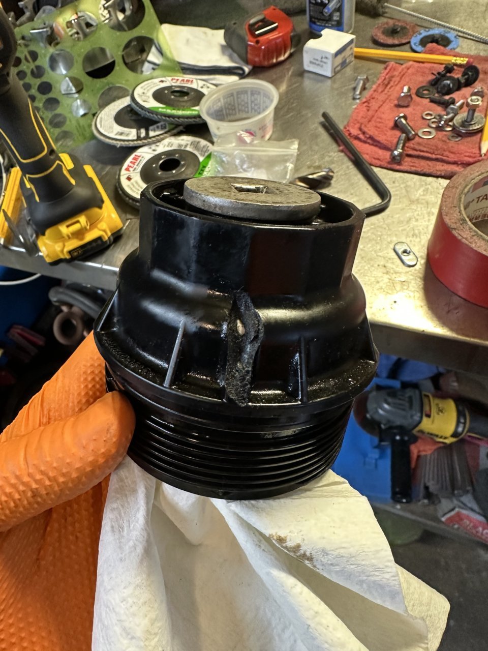

    Went to do an oil change on the truck. Turns out my local dealer but some sweet torque on the filter cap. Luckily my local o Reilly’s had a replacement in stock and it’s metal not plastic. Gotta love breaking all 3 fins on each side just to get the dang thing off. I had to use my short (15”) breaker bar to get it to break loose.

    Dealership strikes again. Any pics of the metal housing? Fitment good?

    ill look after work today but I think I do have a picture of it. It fit perfect so that was nice.

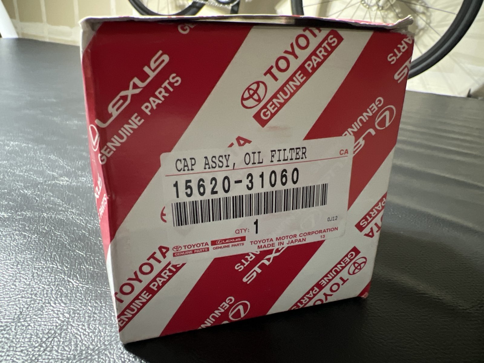

    Just did another oil change today. Not sure of this would help.
    Here’s the part number for the metal cartridge housing.
    Another reason I been declining the free oil changes that the couple of dealers around me has been offering…

    yeah it turns out I never took a picture of the new cap but yeah that part number looks the same.
