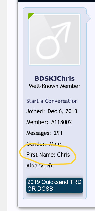

    Meh. its fine... worked on too much stuff to buy into it. Is your name Mike? you sound like a guy I work with
  11. May 13, 2024 at 10:10 AM
    #1151
    BDSKJChris
    BDSKJChris Well-Known Member
    Dec 6, 2013
    #118002
    376
    Albany, NY
    2019 Quicksand TRD OR DCSB
    my name is cleverly hidden in my username, I am Chris.
