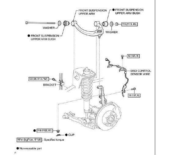

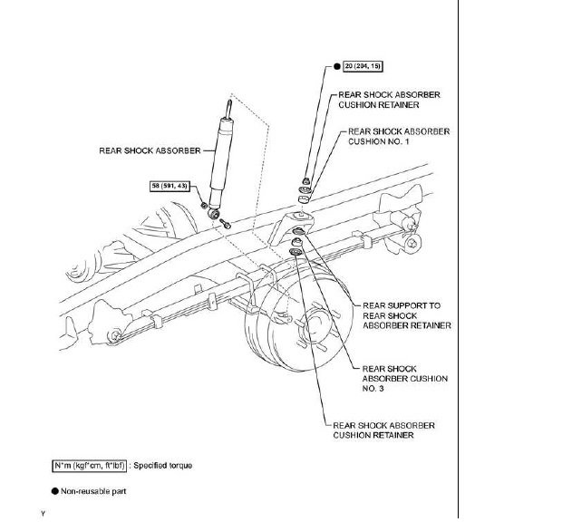

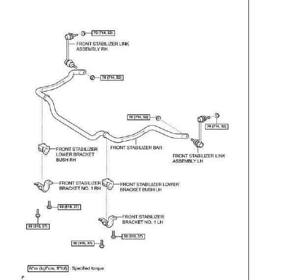

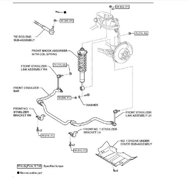

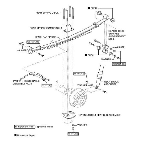

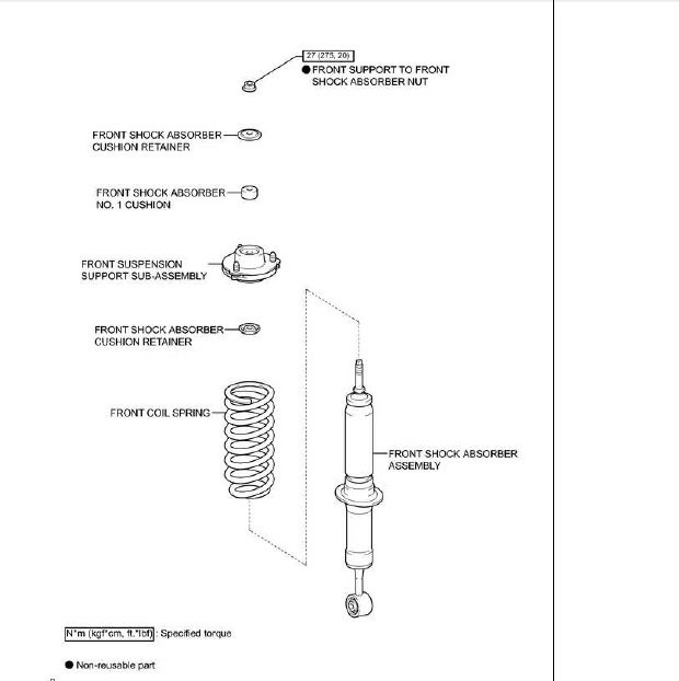

  14. Apr 11, 2016 at 11:06 AM
    #114
    peppinoss
    peppinoss Well-Known Member
    Sep 3, 2015
    #163380
    565
    Los Angeles
    2016 TRD OR 4x4
    ToyTec Boss 2.0 lift TRD Pro Wheels 265/70/R17 KO2s Mobtown Offroad Sliders
    So the last number in the parenthesis is the foot lbs we should be using? sorry, this is all new stuff to me
