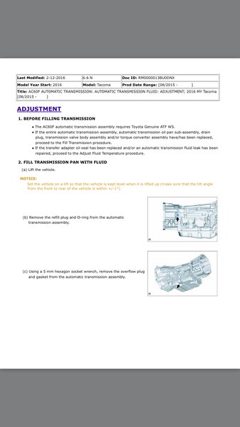

    I agree with you it sounds more complicated than it is. Most of the time is spent waiting for the trans to get to temp. A decent fluid pump you can get for $5 comes in very hand. I did find on the first page of the tech instructions that the truck needs to be +/- 1 degreeimage.jpg

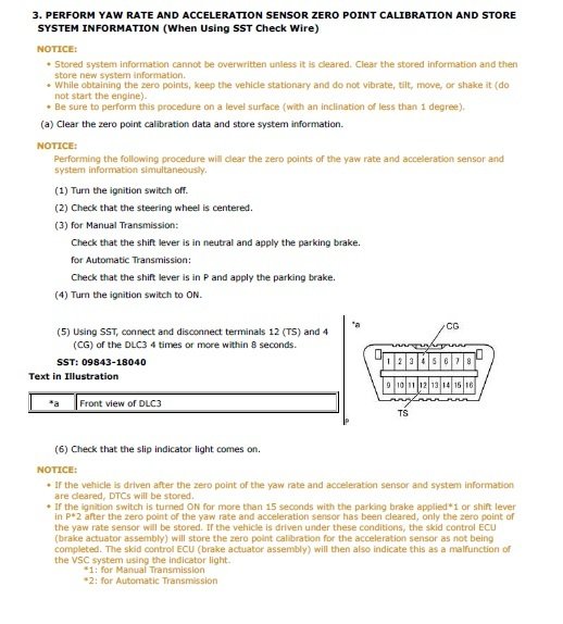

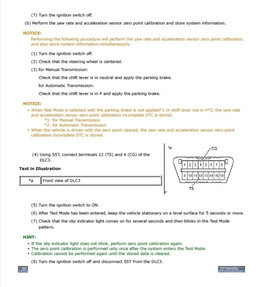

    VSC recalibration

    Hey guys, one more question about checking the tranny fluid levels. Did you replace the washers or just reuse the old ones? I've ordered new ones so I can change them out if I have too, but my truck only has 1000 miles on it, so if I can keep them I will. If this is a dumb question...I was just testing you.

    I replaced them but the fill plug is a rubber ring and if it's not abused you could probably use it again. The bottom is a gasket type so I would say be safe replace. Though I changed my diff fluids and reused the crush gaskets with no issues.

    I've had mine off-on 3 times without new washers; no problem.

    If I remember right, all but the fill plug are "non-reusable" parts per the Toyota FSM. So they should be replaced but I'm sure plenty reuse without an issue. The risk is just having to start all over again if an old gasket leaks. Up to you if saving money is worth the risk.
    Tip though, I never pay for these things. Ask your dealer, buy some fluids and filters from them and I bet they will include them for free.
