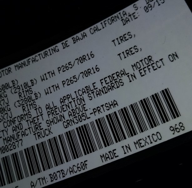

    I checked the jam sticker and here's what I found. Did not see any of these model codes on the owners manual list.
  6. Jun 2, 2016 at 8:37 PM
    #166
    renau001
    renau001 Well-Known Member
    Dec 20, 2015
    #172744
    129
    You said TRD OFF-road AT right? And your sticker has AC60F transmission so 4WD right? Which means front diff and rear locking diff and
    GRN305L-PRTSHA is the model code for your truck. So in the manual you'll see the footnote
    *4: Except for GRN330L-PRTSHA, GRN330L-PRTLHA, GRN310L-PRTSHA and GRN310L-PRTLHA models with rear differential lock system
    *4 footnote is 4.0 qts for the rear diff. Pretty convoluted, but that's what I'd go with. Either way, you won't really need the exact qty since you can probably only buy redline in qts so 6 qts and you'll be good to replace front and rear.

    Yes I do have the off-road 4x4 AT. Yes Toyota does not make it very clear onto which models get what. I ordered just 3 qts of oil from autoanything. Looks like I'll need to add 1 more qt to my order.
