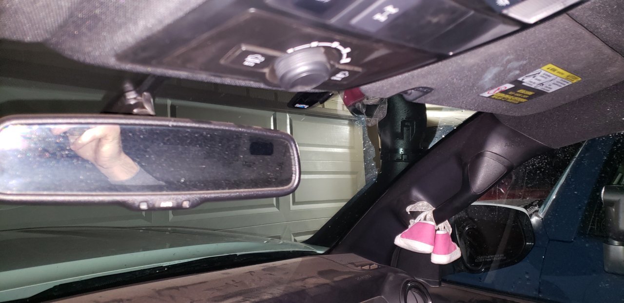

    Can you take a pic pointing at your right a-pillar from the driver seat? I'm curious how much is visible and how much of the view is blocked by the snorkel.

    You can definitely see it. It might be a while before I can take a pic though. If nobody else does before i get a chance to, I'll get one..

    Does it seem like it's going to cause an issue with visability or be obnoxiously visible?

    I went exploring today for several hours and it didn't bother me at all. It's there but not annoyingly there, I wouldn't say it's distracting. 20181209_192008.jpg man, my truck could use some TLC, it gets rode hard and put up wet. A good detailing is in order, soon.

    Looks like the interior of mine. I have had a nice layer of Arizona desert in my truck interior for about a year now.
    Thanks for the pic, the vis blockage doesn't seem too bad.

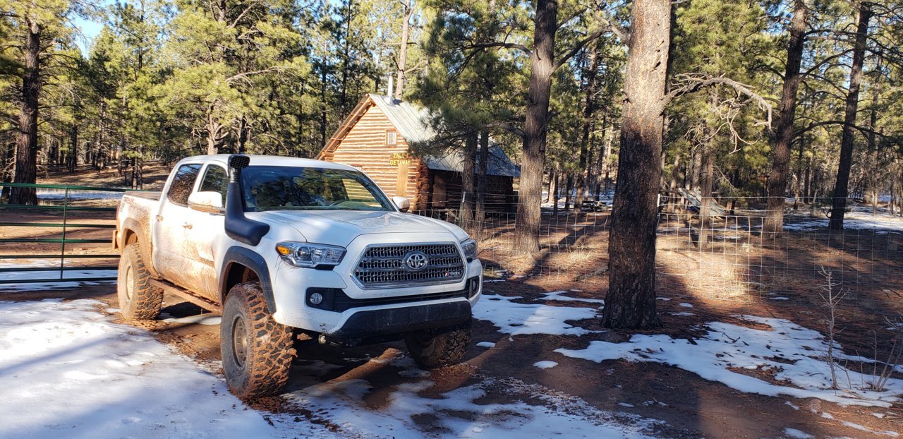

    Yeah, I had no dirt, or signs of water in my air box after miles of bogged roads, it seems to be working as intended.20181209_153718.jpg

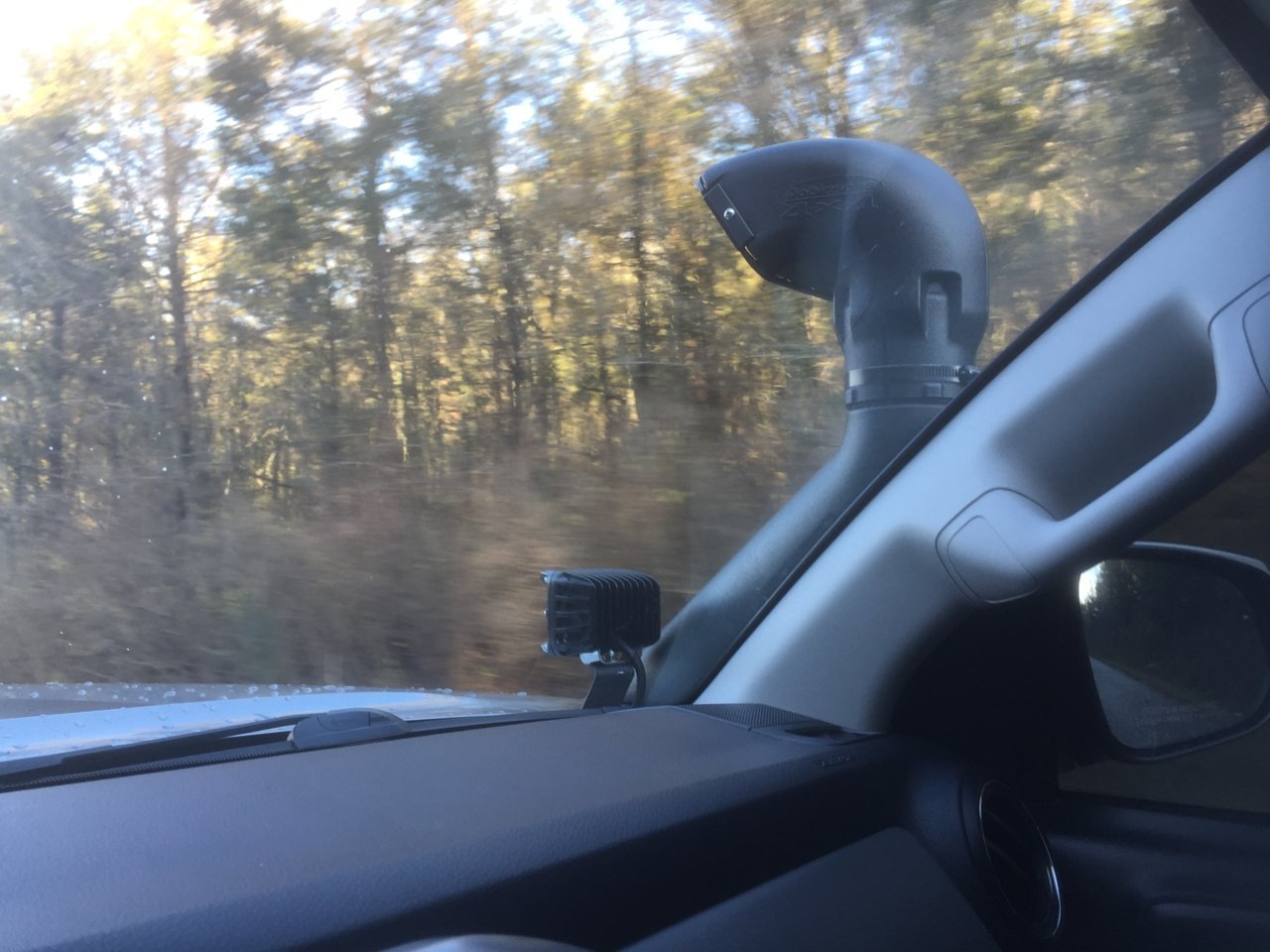

    Here’s a pic. I haven’t noticed any decrease in visibility of oncoming traffic. 923B9727-584A-4FA0-8E25-CED6E69A7475.jpg
