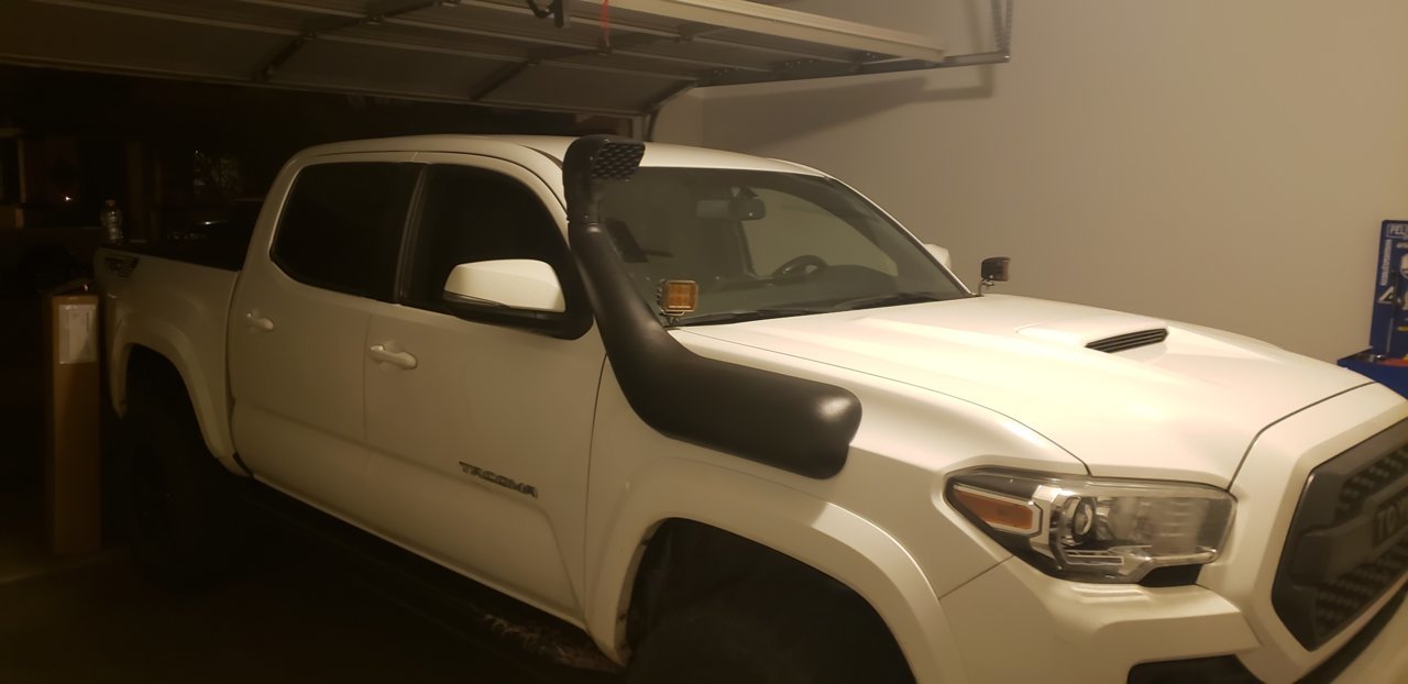

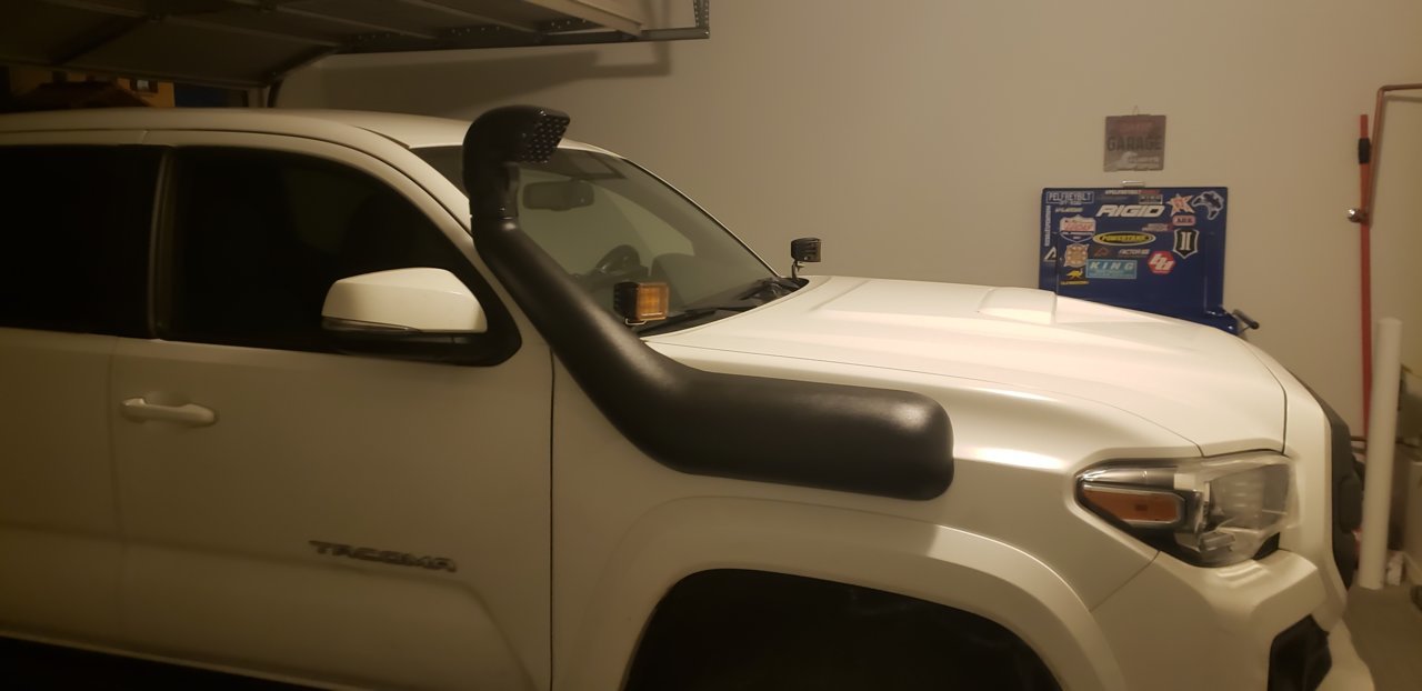

  12. Dec 16, 2018 at 7:00 PM
    #72
    OmegaMan73
    OmegaMan73 Well-Known Member
    Apr 6, 2017
    #215531
    824
    Mesa AZ
    2017 Tacoma TRD Sport 4x4
    I installed mine tonight. I had the same problem with the mounting holes being a little off. Apparently I didn't see step #6. I couldn't figure out how to use the A pillar bracket as the snorkel doesn't quite align right to allow that easily. Overall I am VERY PLEASED with this snorkel. Can anyone take a picture of their snorkel from the backside right on the body line?
    Thanks!
    taco_ace, Zulupapa and TS7xTaco[OP] like this.
