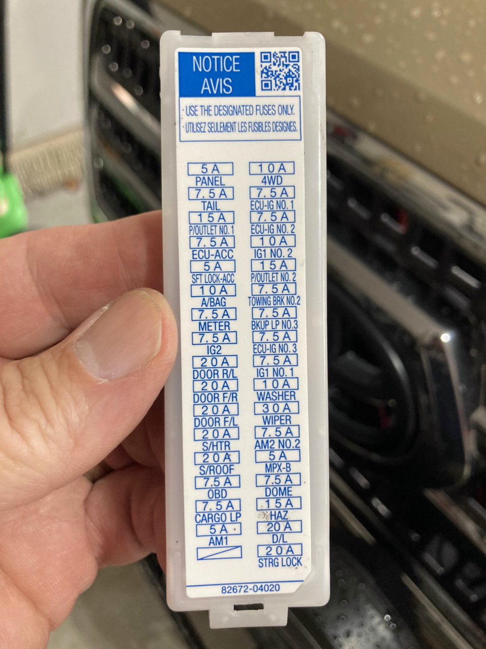

    Dome light won't turn on. Checked under dash fuse, replaced bulb, still nothing. Also just noticed that my USB outlet in the lower dash is also not working but can't find a fuse listed for it. Anyone have ideas?

    Cant find any fuse marked USB....but I did just pull each one out and check them and they all looked good....

    Hi I do see "Power Outlet" marked on two positions. Must be a different model - but mine says "USB" where yours says "Power Outlet #2". I have the 2021 TRD Sport. Mine also does not have the Towing Brake #2 fuse position. Regards Scott
