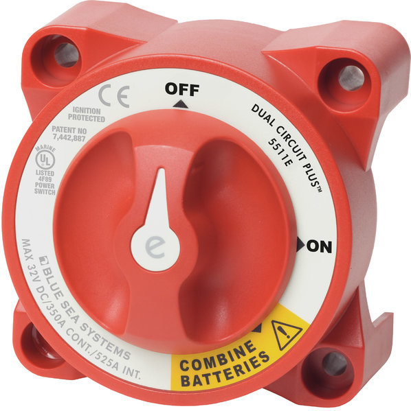

    I wire up switches like this for boats all the time. They work well
    One of these will split charging to both batteries

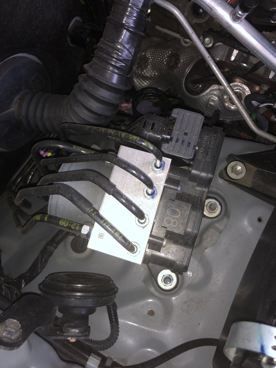

    Total noob here... but on my passenger side behind the air unit I have an anti lock brake module. Does everyone have this located here, or just me?? If so, do you mount the battery above it?

    You can't run it there on a sport. You can do a side by side dual battery or a second battery in the cab or bed.

    Thanks! I was so confused haha!

    This is the worst part about a sport. I have one as well and it bummed me out. I think it looks cleaner to have the battery on the other side

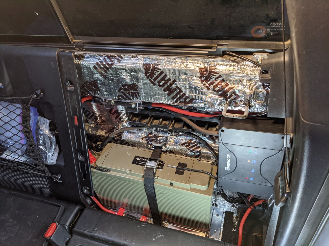

    This is my DIY Dual Battery setup... cost about $900 with everything including the 115AH AGM battery and even the sound deadening mat.

    Nice set up. When i do my dual battery set up i want them separated. Because i didn't want 2 group 34s, with only 68AHs. i was going to use a group 27f or group 31, along with a normal size starting battery.

    Agreed, that was my thought process as well. I actually have a group 31 Northstar for my starting battery... between the 2, I feel pretty good about my available power. ;)

    So far, I don't haha. I went on an 8 night camping trip (moving between sites everyday) and had no issues running my dometic 55 fridge and camp lights, ect.... Average battery voltage was 12.6-12.7 every morning.

    Parts List:
    DCC50S DC-DC MPPT On-Board Battery Charger | Renogy Solar
    BT-2 Bluetooth Module | Renogy Solar
    victron 115ah agm - Google Shopping --(I got my Battery from a Victron dealer, but this is one option)
    Amazon.com: TOPSTRONGGEAR 4 Gauge Black 25ft Power/Ground Wire True 4 AWG Power Wire-True Spec and Soft Touch Cable (Black) : Electronics
    Amazon.com: 4 Gauge Red 25ft Power/Ground Wire True 4 AWG Power Wire-True Spec and Soft Touch Cable (Red) : Electronics
    4 AWG - 5/16" Battery Terminal Connectors, Sanuke Copper Wire Lugs Assortment Battery Cable Ends with 3:1 Heat Shrink Tubing: Amazon.com: Industrial & Scientific
    4 AWG - 3/8" Battery Terminal Connectors, Sanuke Copper Wire Lugs Assortment Battery Cable Ends with 3:1 Heat Shrink Tubing: Amazon.com: Industrial & Scientific
    Amazon.com: 25ft - 1/2 inch PET Expandable Braided Sleeving – Black – Alex Tech braided cable sleeve : Electronics
    Amazon.com: 25ft - 1/2 inch PET Expandable Braided Sleeving – BlackRed – Alex Tech Braided Cable Sleeve : Electronics
    Hilitchi 30 Piece Nylon Plastic Waterproof Adjustable 3.5-13mm Cable Glands Joints Cable Gland - PG7, PG9, PG11, PG13.5, PG16 - - Amazon.com
    Amazon.com: ZBSJAKU 0/2/4/8 Gauge AWG ANL Fuse Holders(2 Pack)+100 Amp ANL Fuses (2 Pack) for Car Audio/Alarm/Amplifier(2 Pack) : Electronics
    Amazon.com: ANL Fuse 60A 60 Amp For Car Vehicle Marine Audio Video System Gold 2 Pack (60 Amp) : Automotive
    Amazon.com: KILMAT 80 mil 36 sqft Car Sound Deadening Mat, Butyl Automotive Sound Deadener, Audio Noise Insulation and dampening : Automotive
