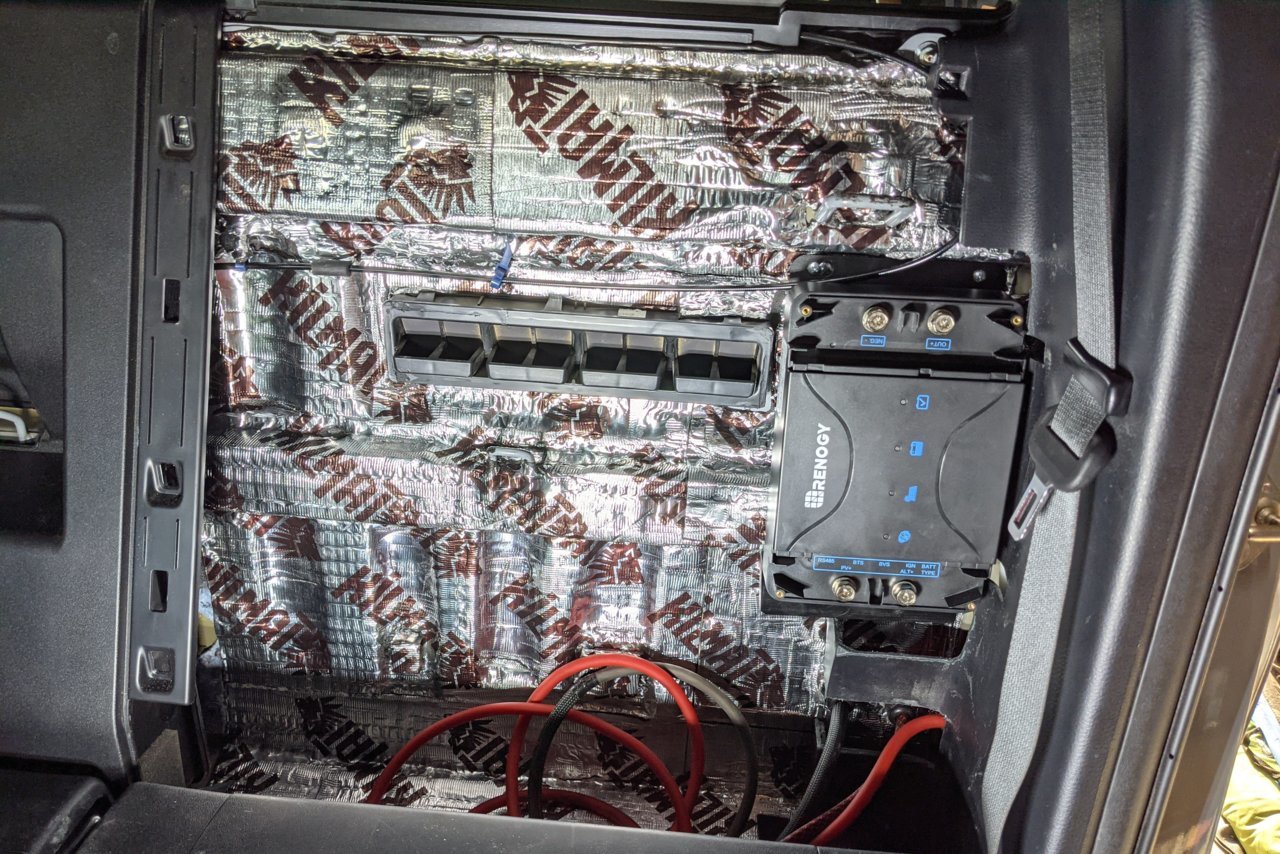

    how are you securing the DC-DC charger? and is the battery secured by aluminum angles screwed down into the chasis?

    Just ran a couple metal screws into the back wall an touched them up with paint. The battery is held in place with aluminum L-bracket and a battery tie down secured to the floor and the thick bulkhead like portion of the back wall.
