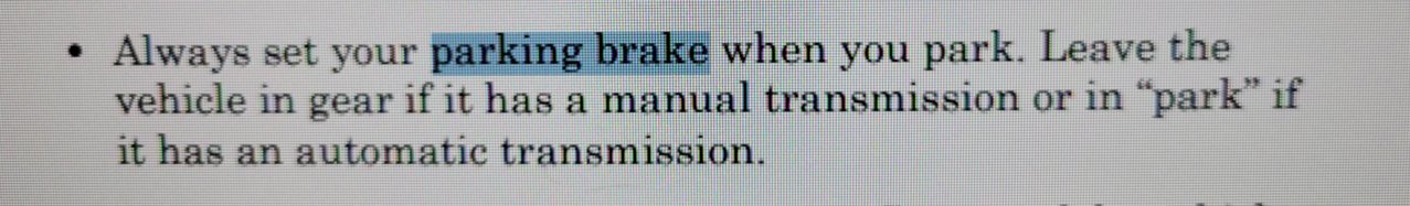

    Washington state checking in. Correct, the "Washington State Driver's Guide" states...
    I personally always use my hand brake. Better habbit to use it, than making a habbit of not using it, IMO.
