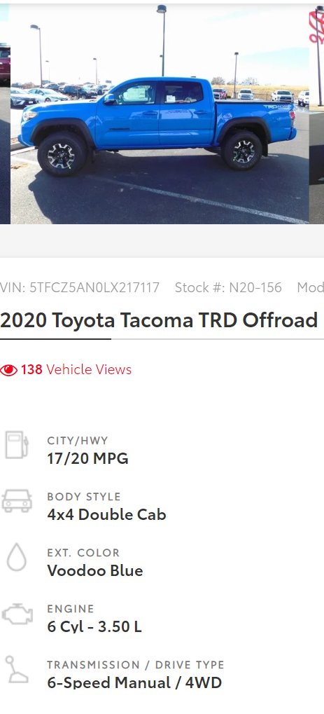

    To buy or not to buy.

    Damn Serg, that was Thread-Jackmaster-5k!
    Yeah, buy it, and start your own thread :p

    Lol! I wasn't trying to high jack the thread. :D My message was, "Do I really want to buy the same truck in light of what the OP is going through?"
