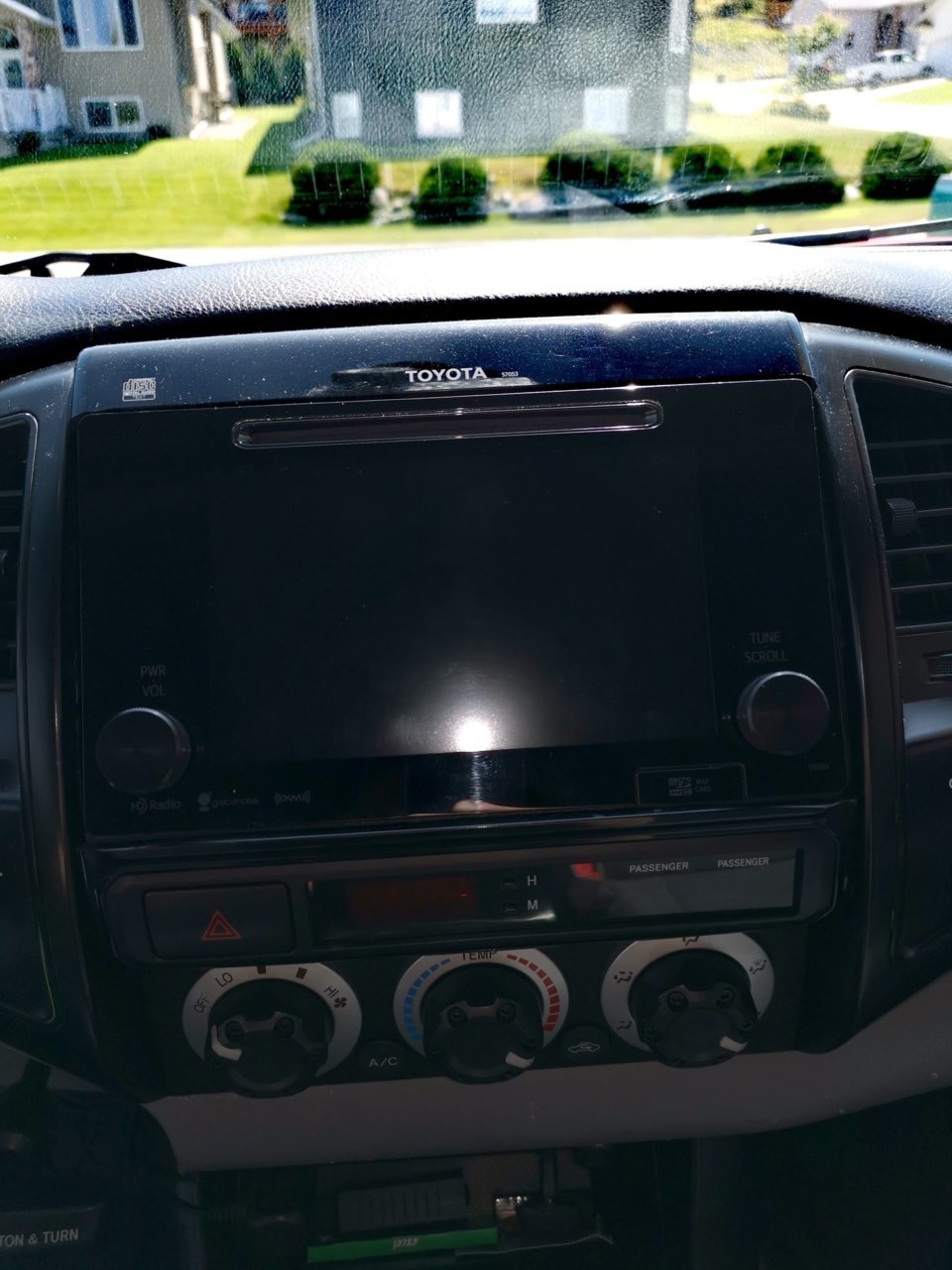

    I have a 2006 Tacoma and have managed to successfully install a 2017 entune premium with navigation and get all features working. I know there has been a few guys that have also completed this project but I'm wondering if anyone has made a custom bezel that will actually fit the headunit. I have tried to modify the original one, a factory 2015, as well as a double din and no success.
    Has anyone 3D printed or make such a beast that will fit? I would really like to finish off this project with a nice bezel

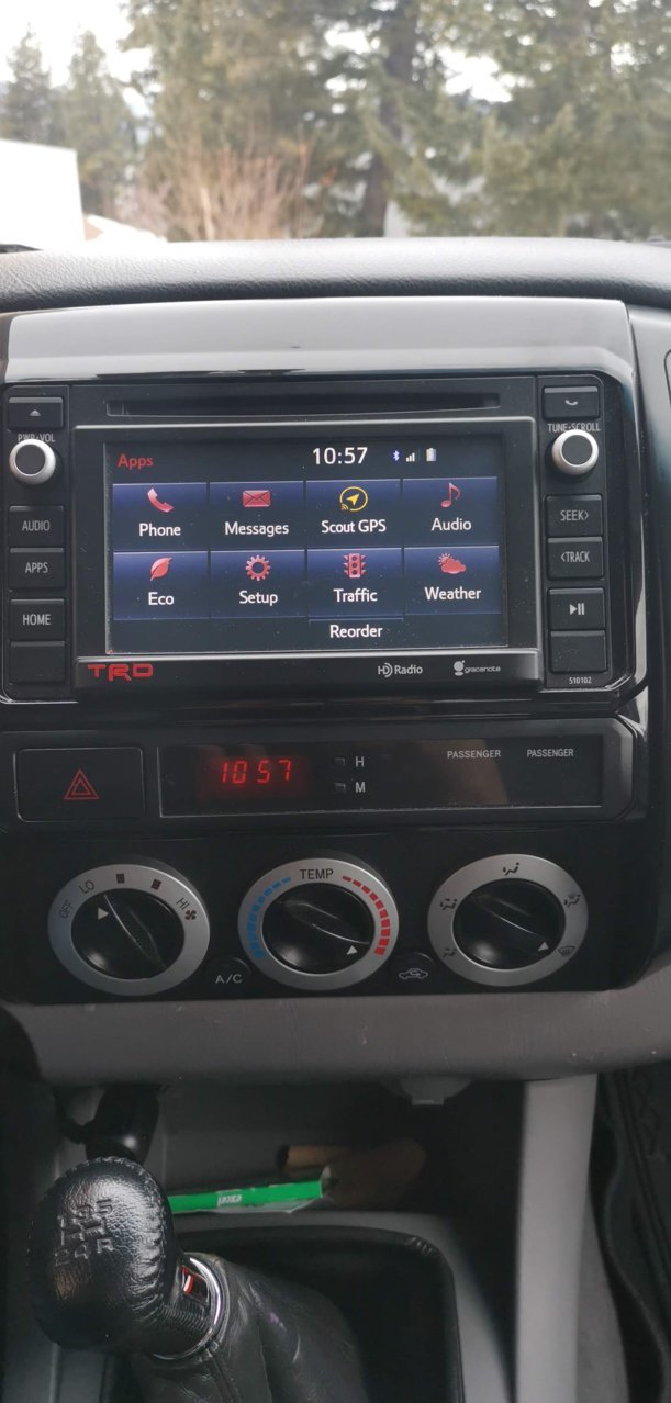

    I've actually had a 2014/2015 Entune installed in my 2006. There is a 2015 factory bezel that will fit, so there is no problem with anything up to 2015 entunes. It's when the 2016 and up entunes that was the new glass design and much bigger headunit which there is no factory bezel that fits a in a 2nd Gen Tacoma. If you have any questions I can send you some pics of my 2015 install

    Here is my previous 2015 entune install as my new 2017 entune install

    Basically I trimmed the top and bottom off a factory bezel, used the existing mounting brackets and everything bolted right in. It took a little more time to make/trim the top and bottom piece of the bezel to ensure if was tight as possible but it worked out ok. I also bent the legs/feet of the mounting brackets so it would fit better and give me some extra clearance for the gps antenna
