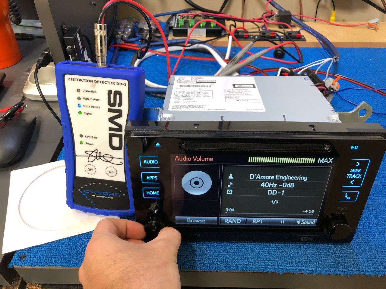

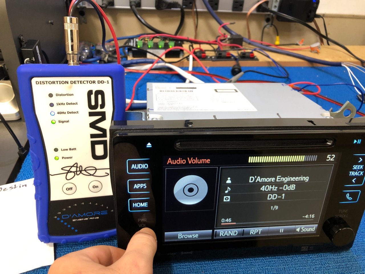

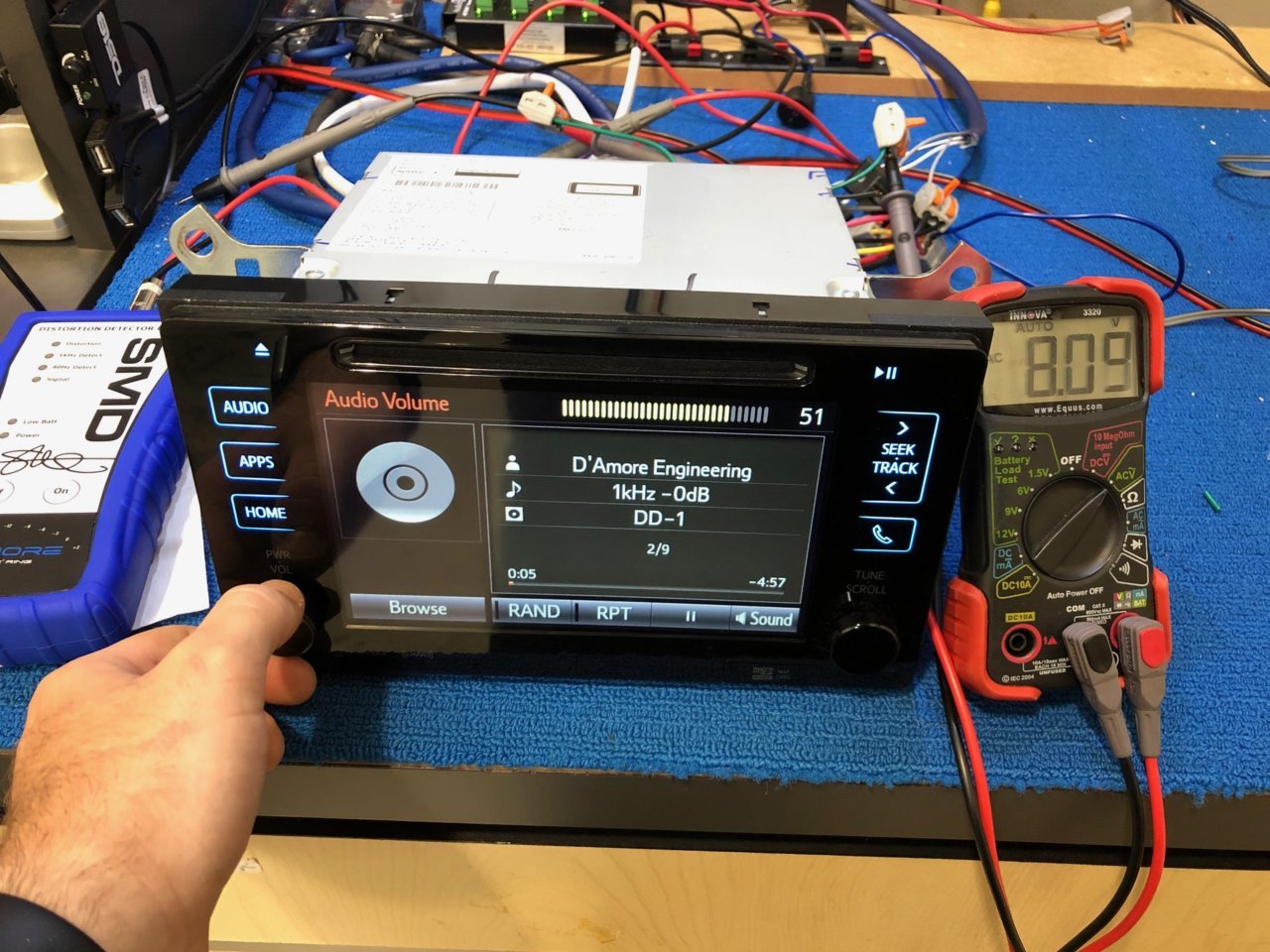

    So a while back I tried to take some measurements of the audio outputs of my stock radio to see the amount of power it was outputting. Long story short, something went wrong (either from product malfunction or user error, likely the latter) and the numbers I got were way off.
    Today I hooked the radio up on my test bench and ran a few tests to get solid numbers to share.
    75 Amp power supply outputting consistent voltage

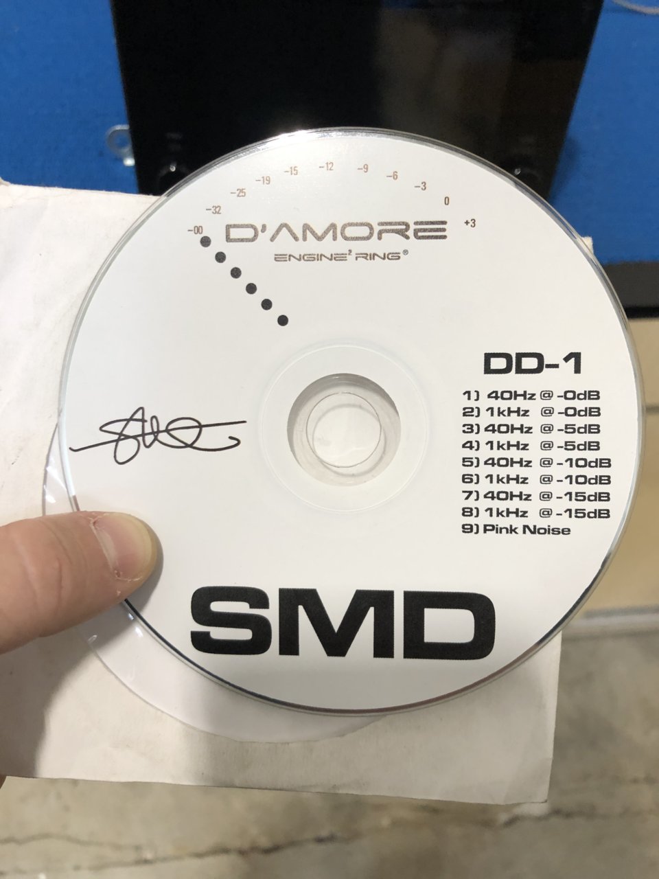

    All tracks played from this CD. I used 40hz @ 0db and 1khz @ 0db, as well as pink noise.

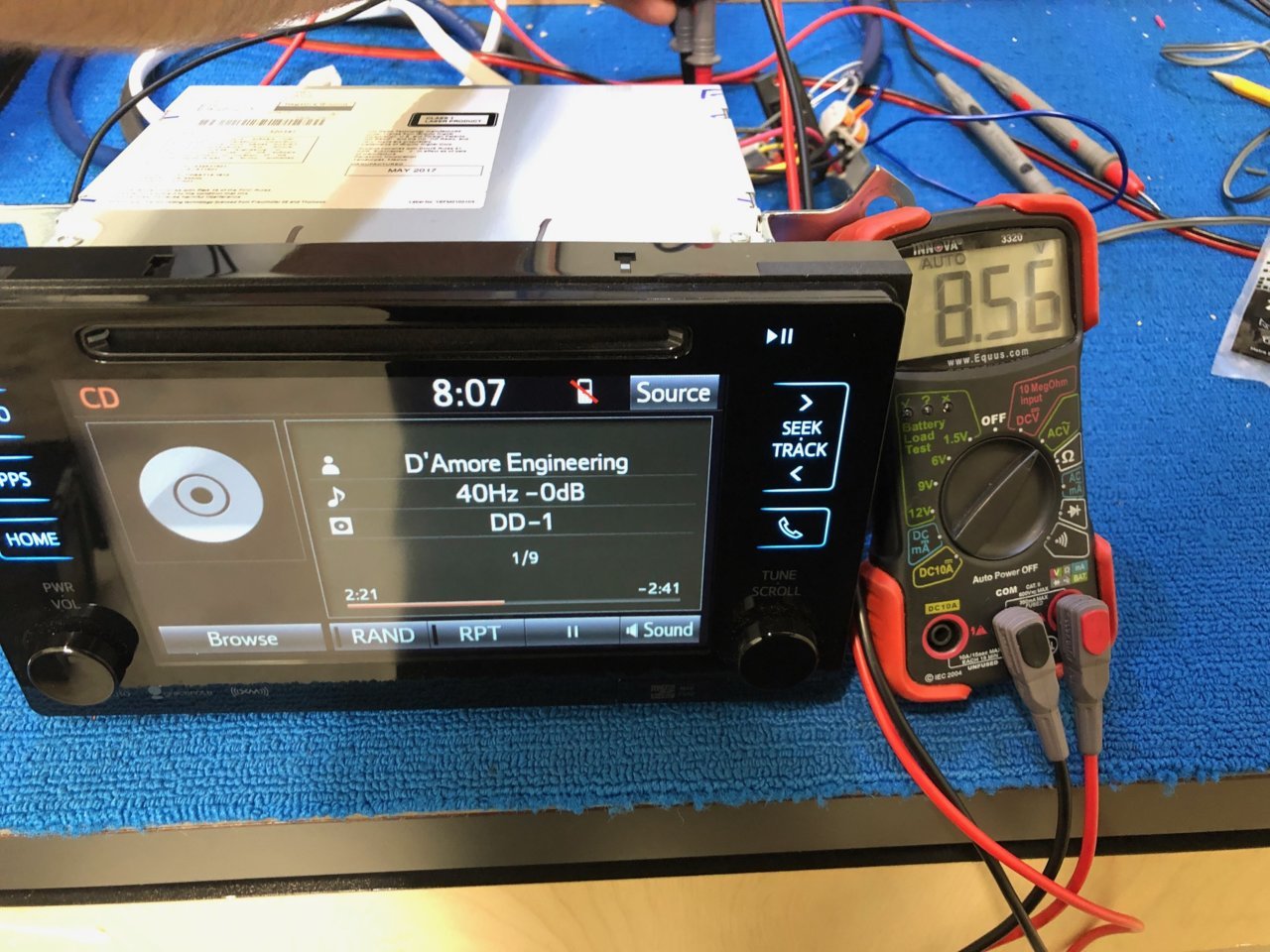

    Playing 40hz, front channels clipped at volume 53 with a 4ohm load and with no load.
    *edit* the DD-1 actually detects 1% THD and NOT clipping.
    Somehow, headunit did not clip playing 1khz at max volume under load
    Front channels, vol 52, 40hz
    Front channels, vol 52, 1khz

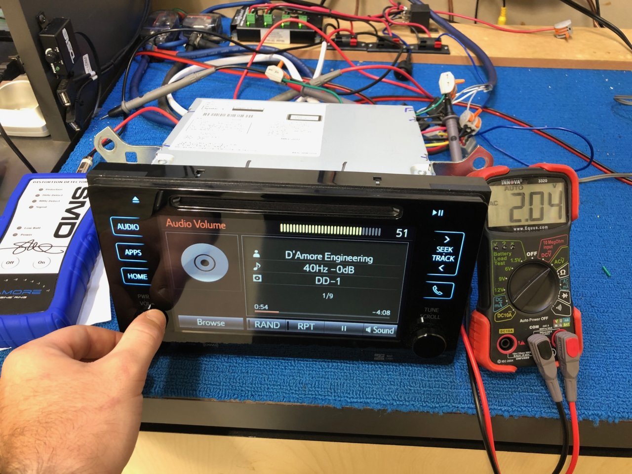

    Rear channels, vol 51, 40hz
    Rear channels, vol 51, 1khz
    Now here is where things get interesting.

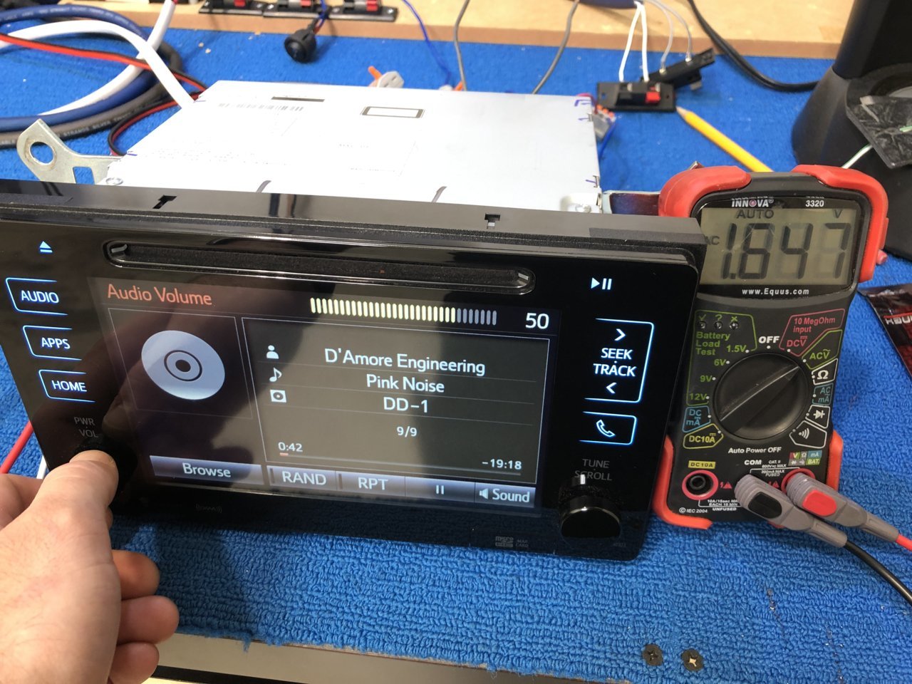

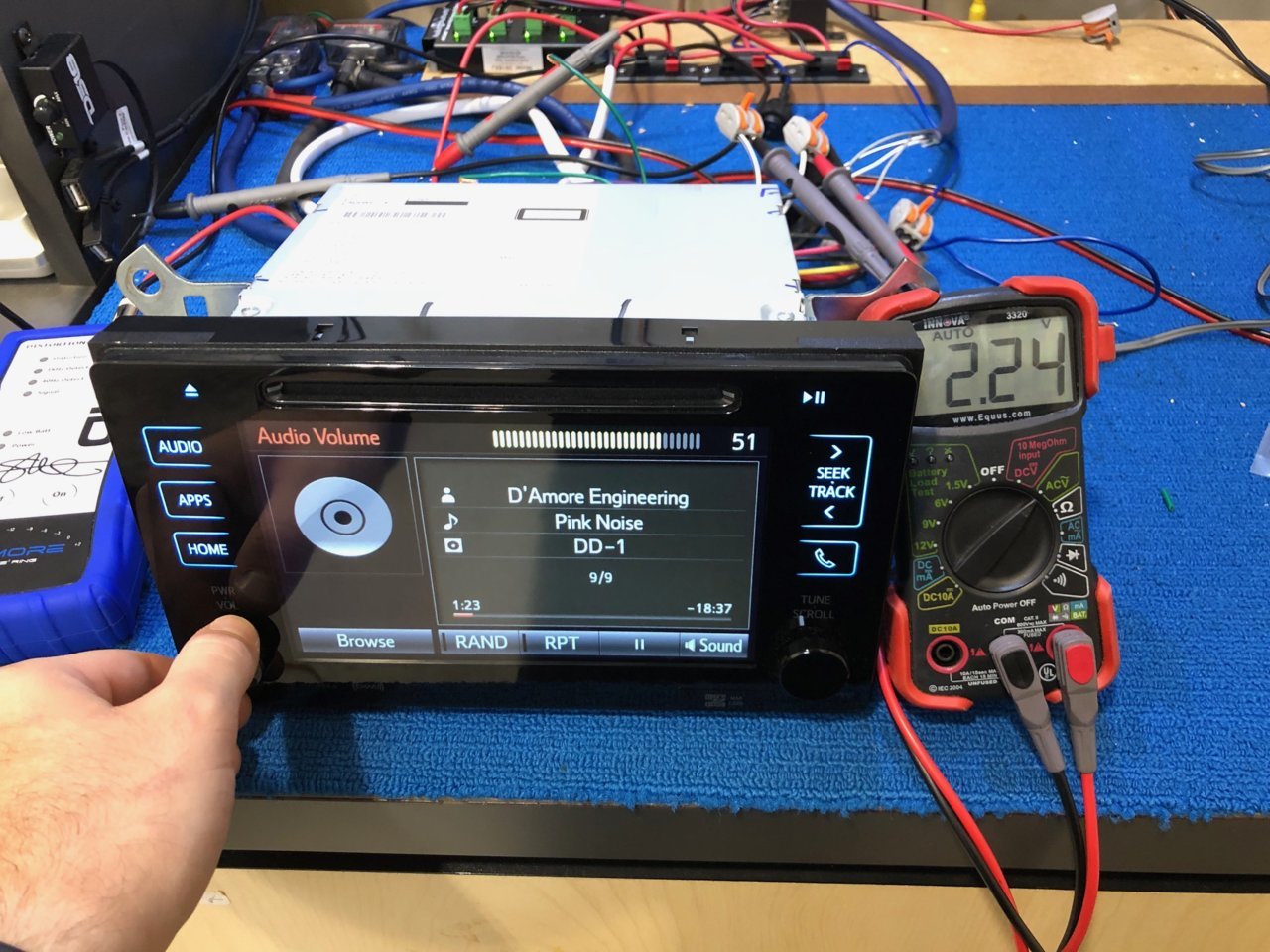

    I played Pink Noise and got a much lower voltage
    Front channels, vol 51, Pink Noise
    When this test was originally done in the truck, I was trying to explain that when hooking up an LOC for subwoofers, one should tap the front channels in our trucks instead of the rear channels. As shown by the 2v output (1 watt) @40hz from the rear channels, I still believe this to be the case.
    On the front channels, with 40hz playing around 8.5V and 1khz playing around 6.1V, this averages around 7V which should be about 12.25 watts RMS @ 4ohms if my math is correct.
    The Pink Noise only outputting 2V is slightly concerning, but I can't say for sure whether that was a fluke or an inaccurate reading, or even if the file is at 0db since the disc doesn't specify.

    And yep, 2VAC at 40hz to the rear channels at vol 51. It limits the bass so much to those speakers. Guess they don't want to risk damaging those 6.5"

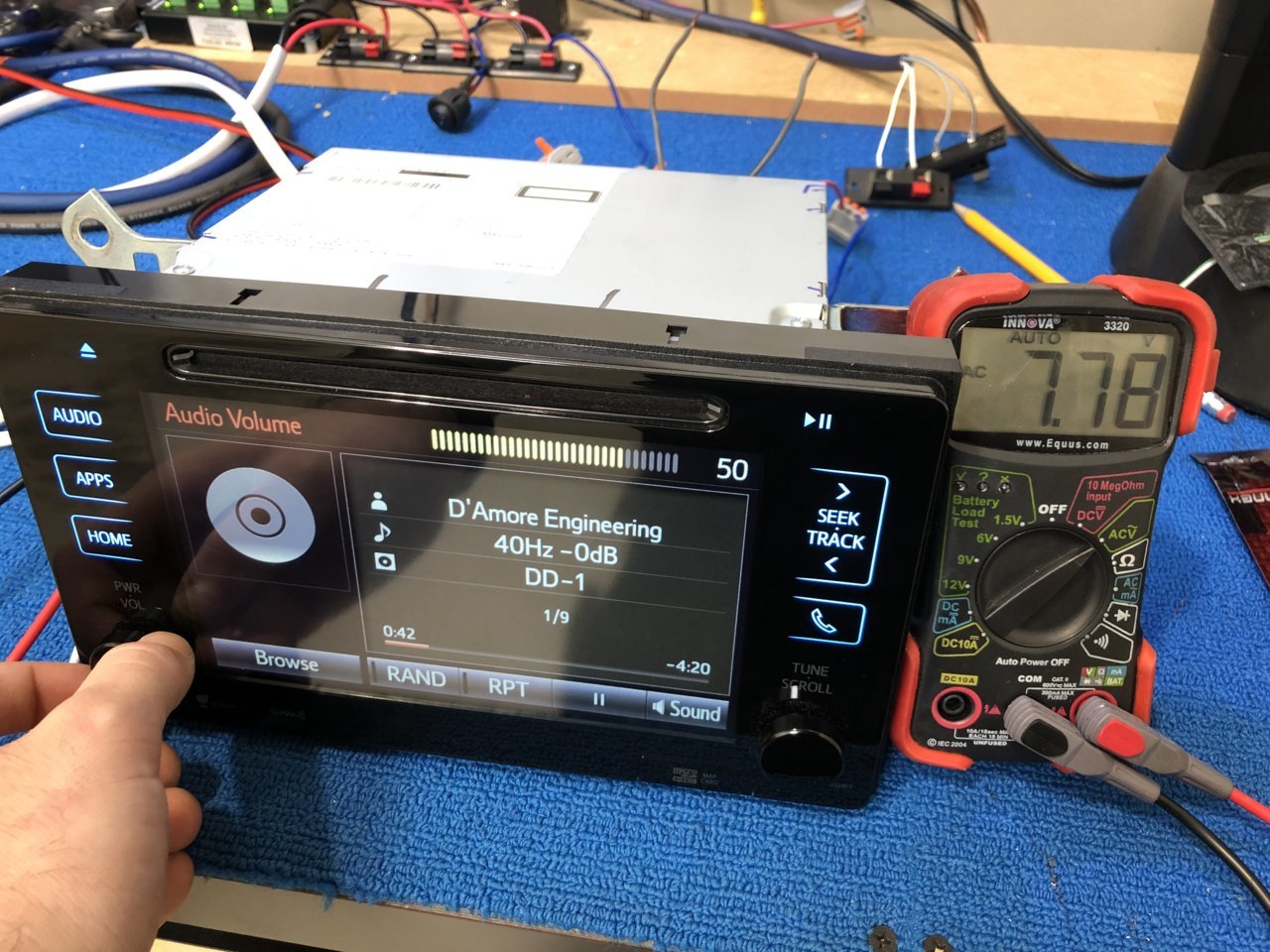

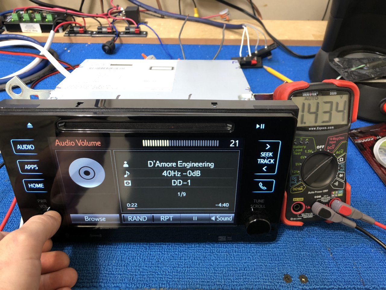

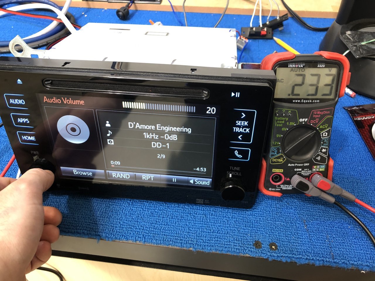

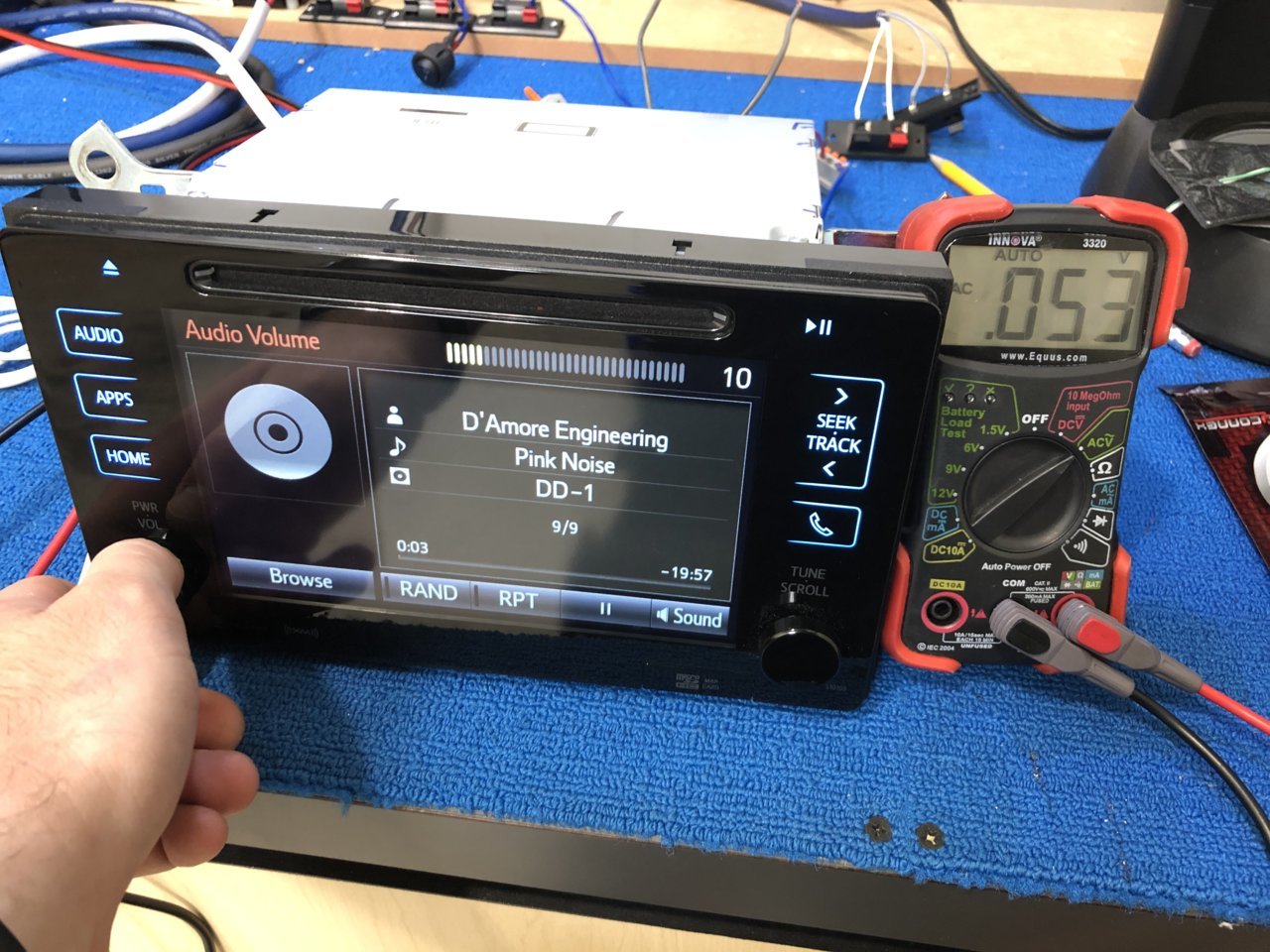

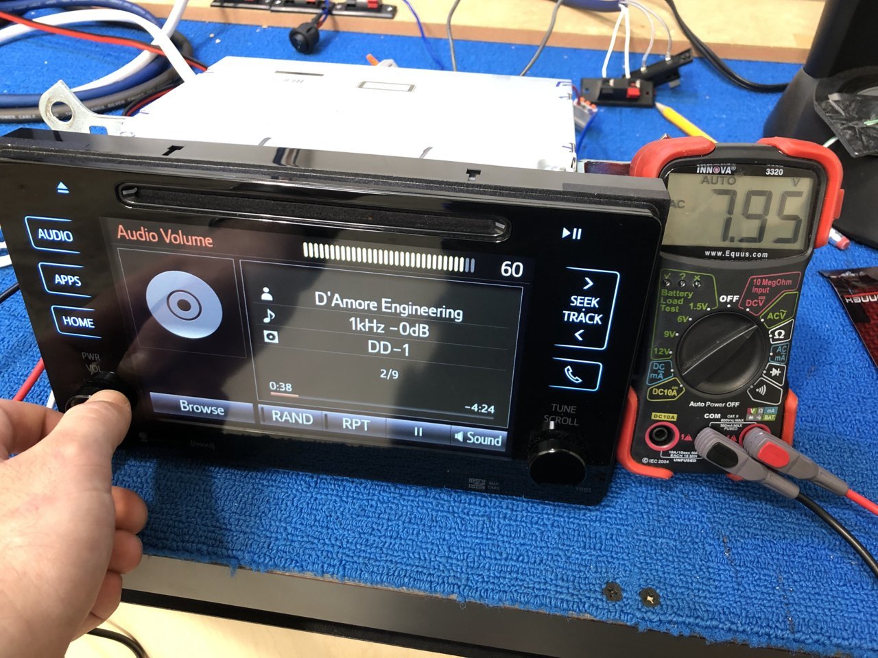

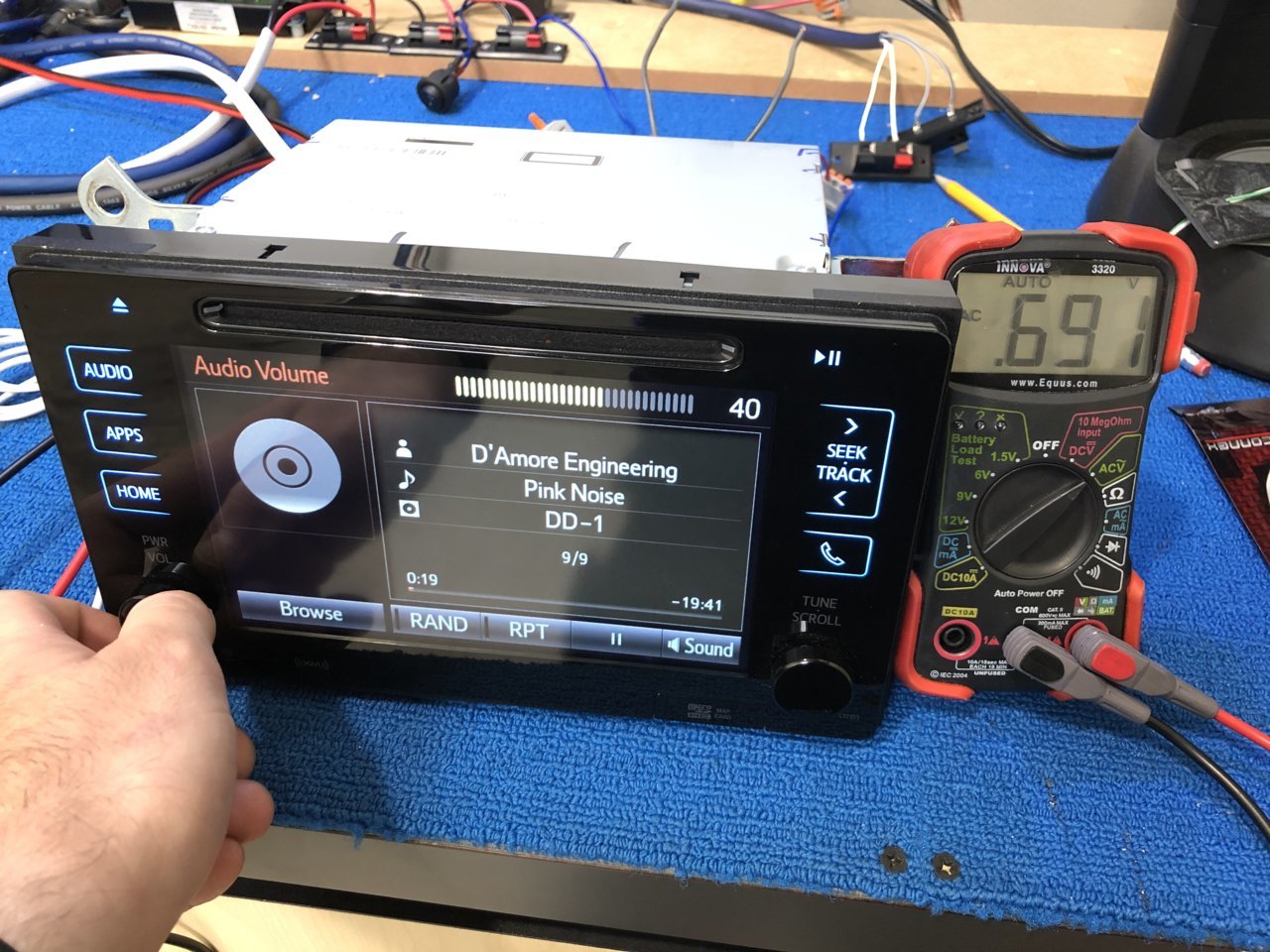

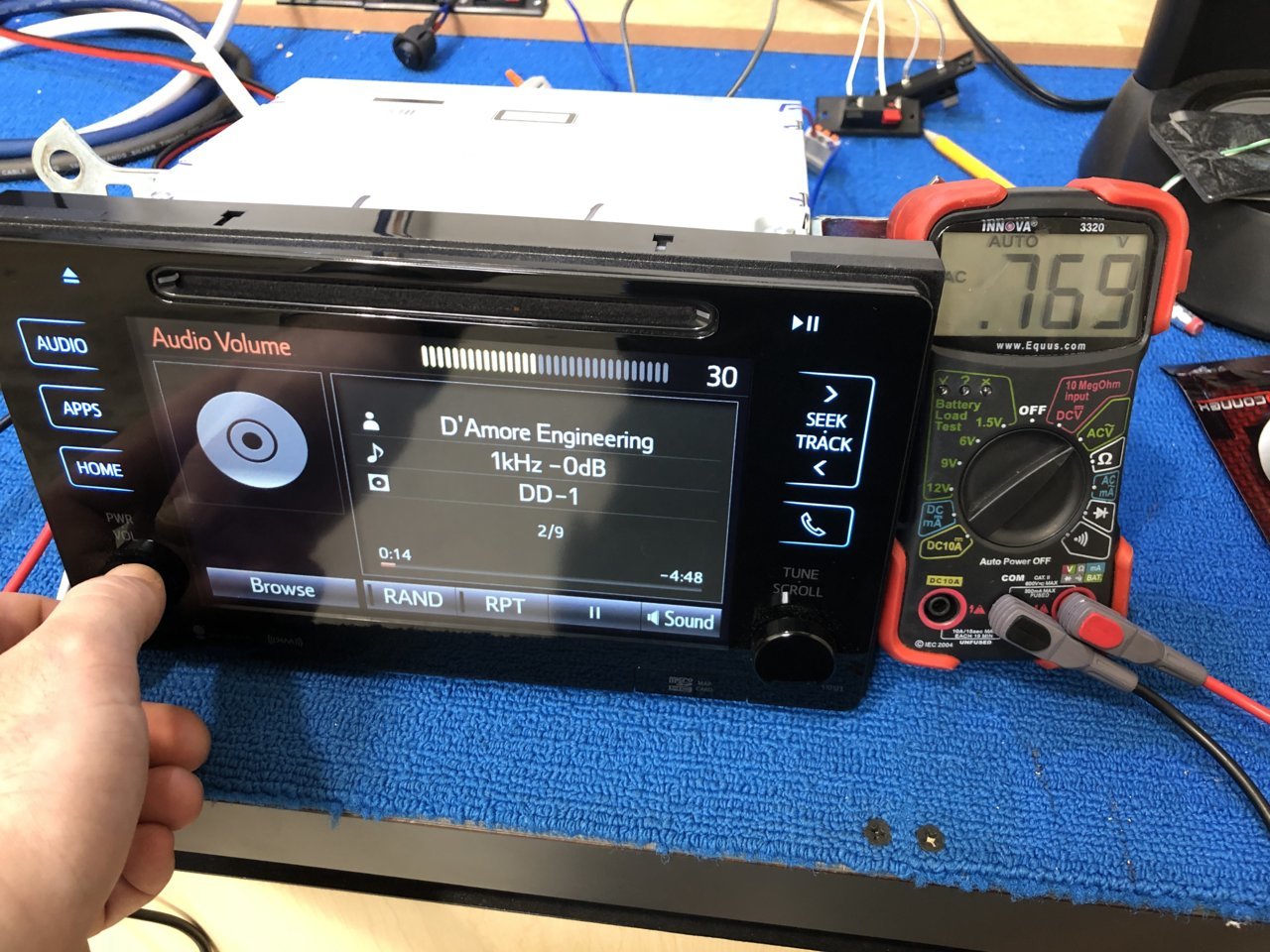

    A few more tests to say we were thorough. The volume level absolutely increases dramatically once you’re past the 40-50 mark, just as @dolbytone recalled.
    40hz @ 0db in 10 increments
    39805707-DADD-4E2E-975F-8BC2B732C804.jpg B9AFD83C-0BF0-42CE-A0D1-81312725485B.jpg

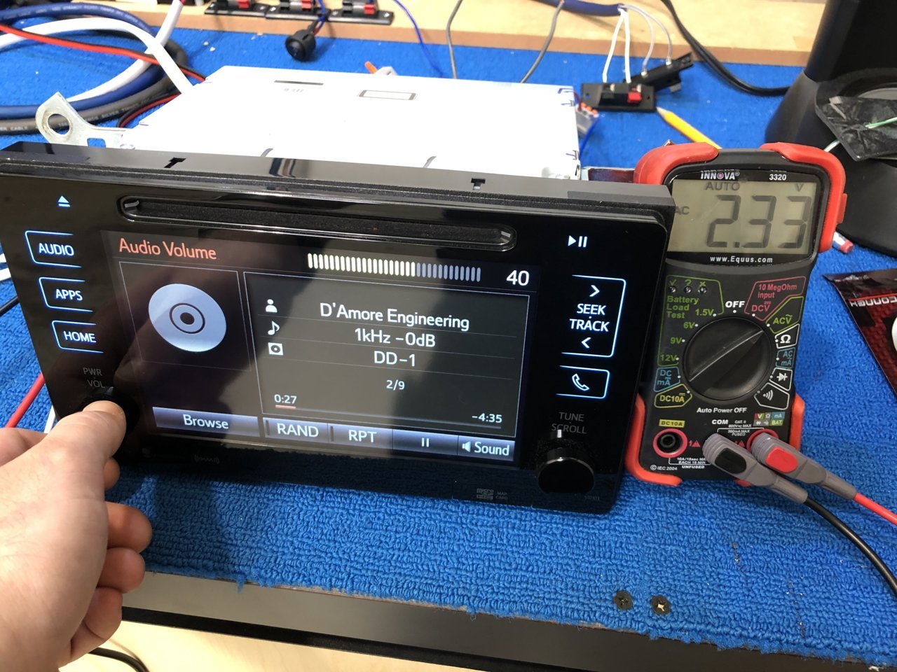

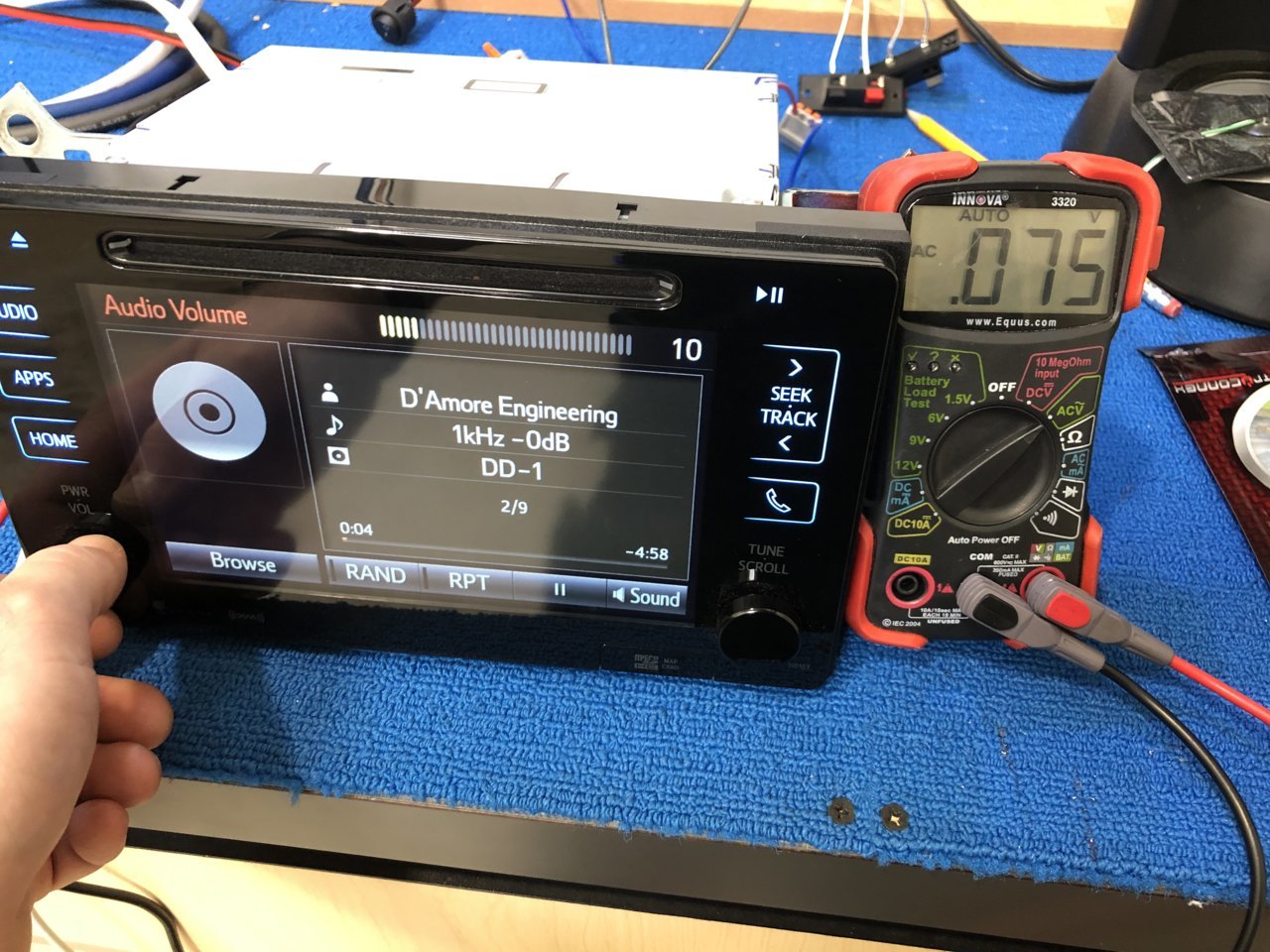

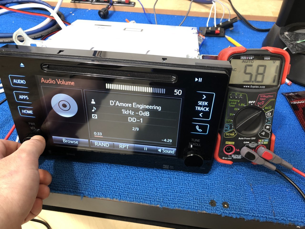

    1khz @ 0db
    D858E63E-EAF0-49B8-8FD9-FA4402A00755.jpg 203E3F7E-E1CF-4E03-B1CA-CE961842143C.jpg 01C15118-C565-44CC-9675-E2BA7E0A9659.jpg B1059B9B-1B14-4877-9002-7D19F4411ABE.jpg C41A25E2-BC65-452D-AB74-B3DB581609E6.jpg 1CD1952E-3864-407B-9F9C-4CD9513C3C47.jpg

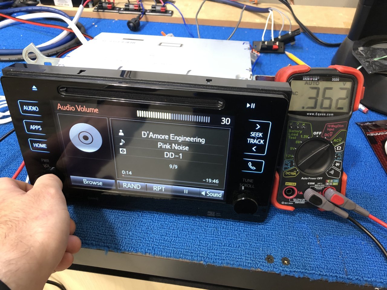

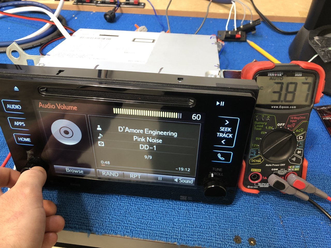

    Pink noise
    AA8A6BF3-B686-4B47-8CF0-6E9BF797C43F.jpg BABD97A3-B602-49E3-A125-0D2546F04877.jpg 2AC8EA42-DE21-45D0-BA54-E9598BA118A1.jpg 7265DB45-DD3E-4B1F-9EEC-5C3474C3D933.jpg 7EC9F87E-2A9F-4CAE-86EB-F83E119652B3.jpg C12106DB-927A-477D-A561-52DC49E50525.jpg

    I always appreciate seeing objective testing, but the problem with using a DMM is that it's really only accurate at 60Hz. It might be OK for providing comparative data between channels, but for absolute values you'll need an oscilloscope for accuracy.

    As one more quick update, I have edited the original post but because I was using the SMD DD-1, I want to clarify that this device detects 1% Harmonic Distortion. It does NOT detect clipping. I may have beeb able to push the volume level a few clicks higher before clip, but I think testing for less than 1% THD still provides relevant results.
