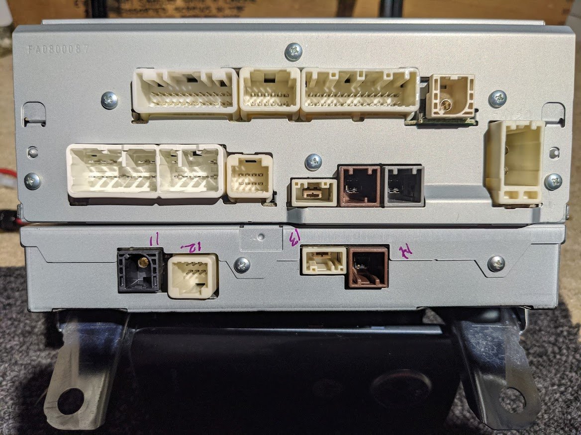

    @IcemanPNW I have a 2018 sport with navigation. It’s Panasonic unit but part number is one number different from those listed out above. My Part Number: 86100-04162
    I know it’s not JBL so based on information in thread I assume it’s considered Entune 2.0 premium?

    Yep, I can tell right away from the pics that’s Entune 2.0 and from the connectors it sure looks like non JBL with onboard nav which makes it the Premium.
    Your head unit has the onboard navigation/maps that doesn’t need your phone to be connected (not the scout gps), right?
