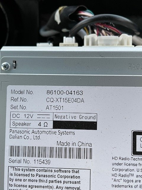

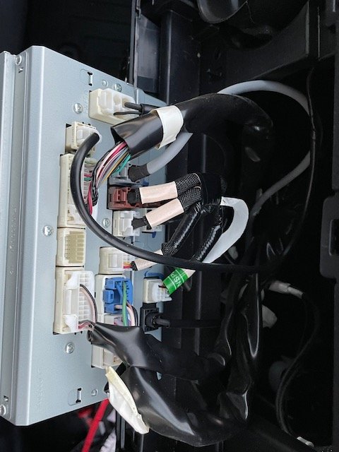

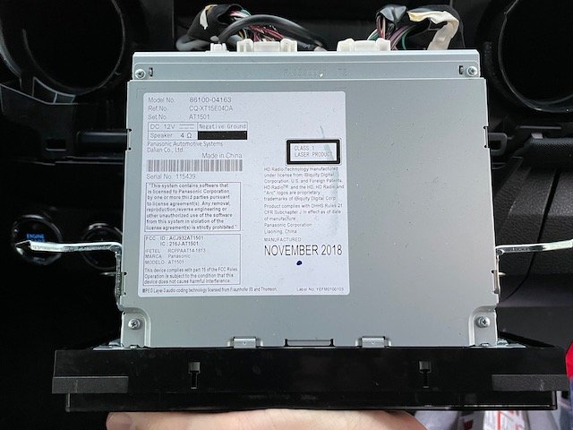

    @IcemanPNW I have the 2019 "86100-04163" with a 9" screen. Looking for a 2021 or 2022 Entune 3.0 Premium non-JBL with Navigation with the correct fitment for the conversion to 3.0. I went into a Toyota Dealer and Parts department to try and confirm the model, and they could not confirm. They said they do not get the specs and descriptions, only part numbers. Called 3 other parts departments who said the same.
    Been doing google searches and contacting eBay sellers with no success.
    Some eBay sellers say their unit has navigation, but when checking, it just has the apps suite for carplay with Maps and Waze, but no navigation. Not sure why it's so hard to find out this information.
    Any chance you or anyone else may know the model number(s) for the 2021 or 2022 Entune 3.0 Premium non-JBL with Navigation that would replace the "86100-04163" with a 9" screen?

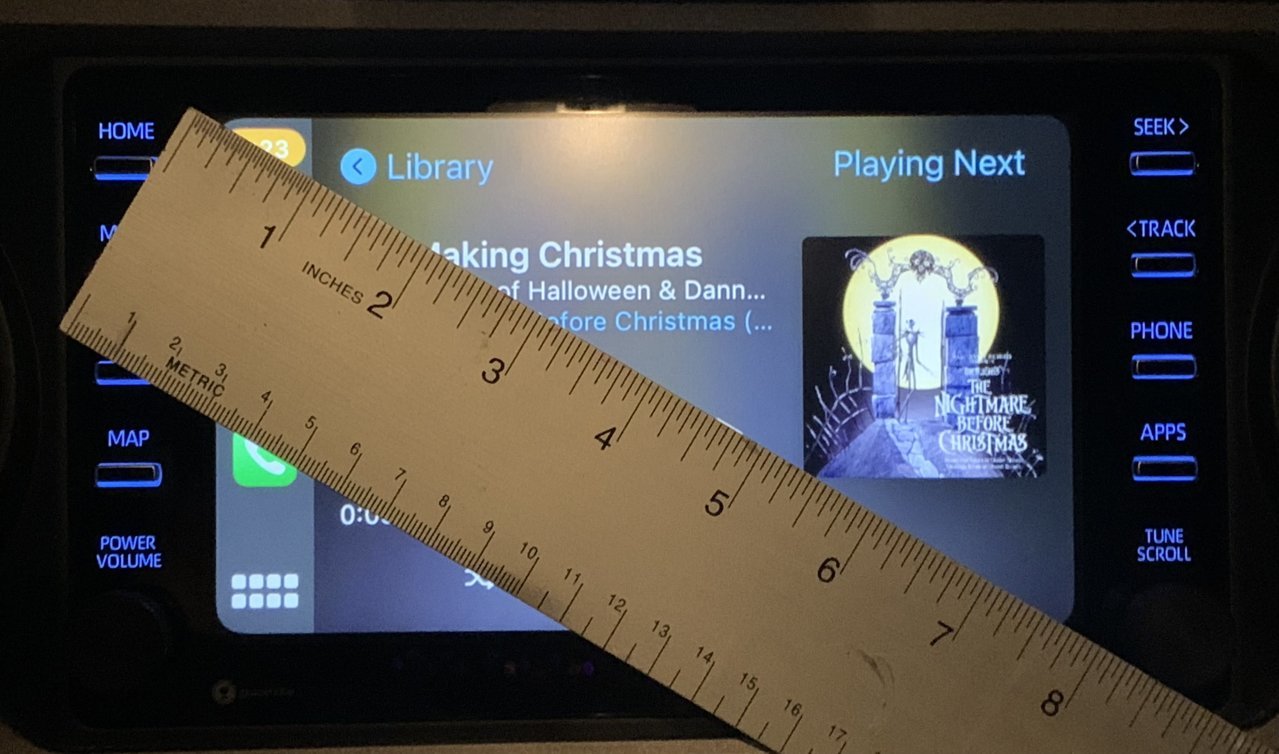

    Pretty sure what you’re after is the 86140-04200.
    Bunch of notes about this:
    * I’m just another Taco fan, I don’t have any inside info other than aggregating data from other Taco fans … I might be wrong about some details :)
    * I don’t think there’s any OEM head unit with a 9” screen…
    * The Entune 2.0 86100-04163 model you mention I think has a 7” screen … screen is measured from corner to corner on the digital part of the display only
    * The Entune 3.0 86140-04200 has an 8” screen (pic below)
    * I think the 86140-04200 is the same p/n for both 2021 and 2022
    * The head unit and the nav box are separate parts; many sellers selling pulls don’t know or don’t care, and keep them together, but some do and separate them. Because many don’t know it might be hard to get a straight answer depending on the seller.
    * I retrofitted the 86140-04200 in my 2019 (3rd different Entune unit I tried) that’s what’s currently in there, probably my favorite OEM head unit so far, have had it for about 2 years now.

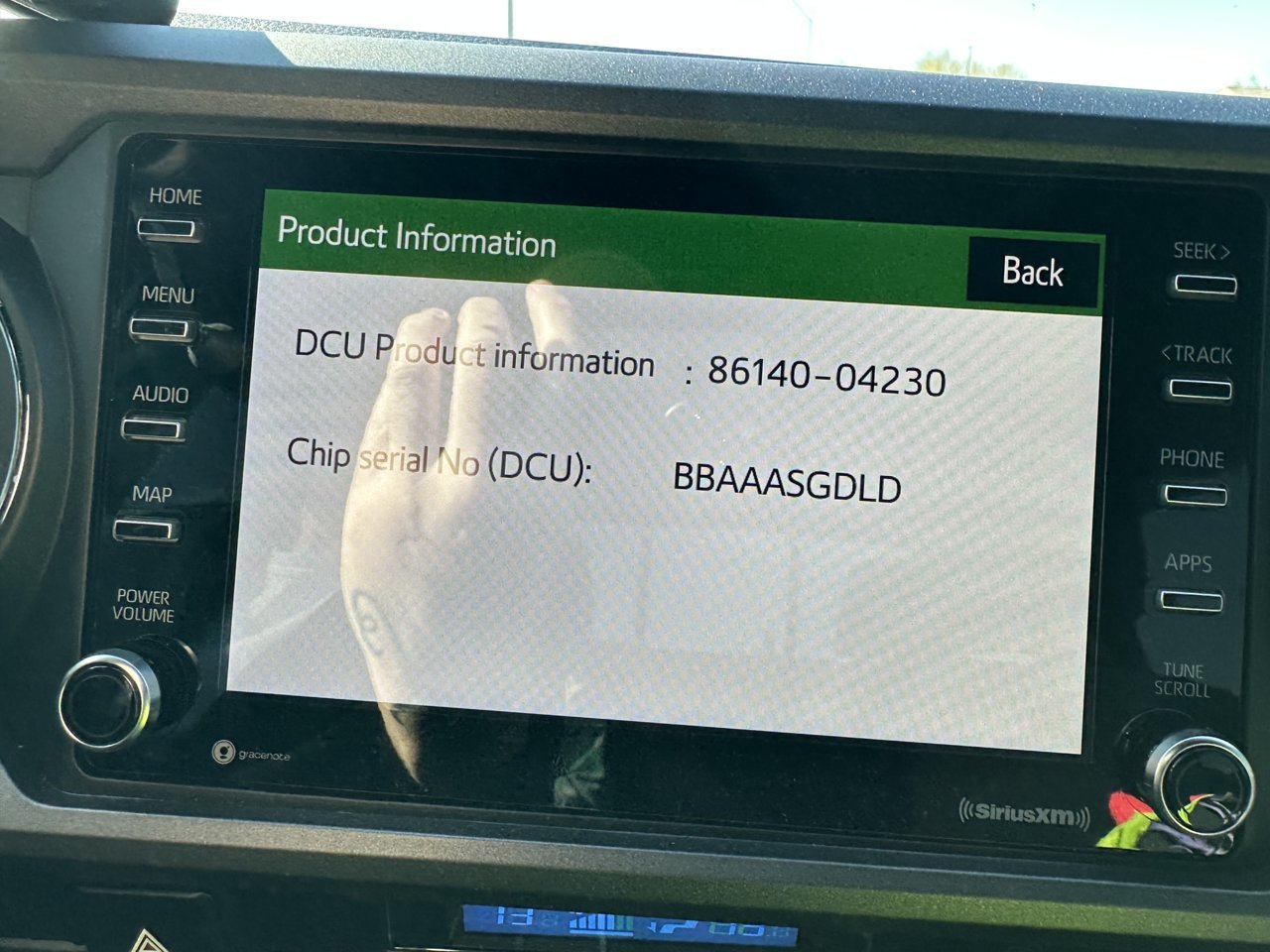

    Have a 22 non JBl with an 8” Pioneer #86140-04230.
    not sure where this lands on the premium list.

    If you scroll back to post #3, its all broken down thanks to @IcemanPNW According to the list, it looks like your unit is the "plus" not the premium head unit.

    That’s what I was thinking but my manufacturer shows as pioneer and not Panasonic and that breakdown has the model number I have but with Panasonic.
    So it’s either a typo on the post or the pioneer 04230 Pioneer is different from the Panasonic 04230

    That’s a new one.
    I believe the main difference between the Plus and the Premium is the Plus doesn’t have integrated navigation (the Map button goes to some janky thing that needs your phone to work)…. While the Premium has a true integrated nav system that works entirely independent of your phone or the internet.
    Do you have integrated Nav?
